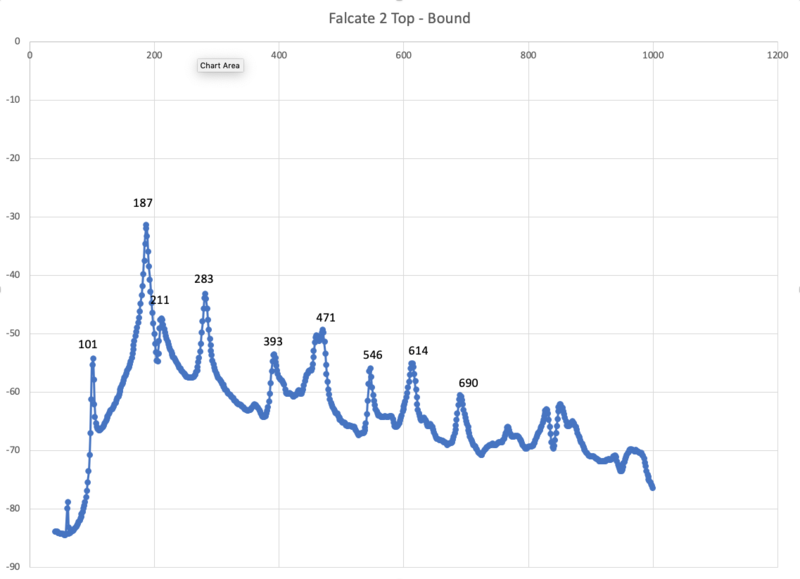

Hello again, everyone! So, my second Falcate guitar is well underway... The box is closed and bound and the BO/BO neck fitted.
Carpathian Spruce top with a target thickness of 2.67mm - I think I may have gone a touch thinner after leveling the rosette.
EIR back and sides with a target thickness of 2.26 - I believe I'm right on the money here.
I have only the bolts in the side mass blocks, but they're heavy at 20g each.
So, here's the results!
T(1,1)1 is 100Hz, which I take as a win!
T(1,1)2 is 187Hz which I think is a bit high, yes? Some more side mass, maybe?
T(1,1)3 is 211Hz (the back tapped at 209), so I think I actually have a live back, yes?? The main back brace is only slightly scalloped, so I do have room to work.
Any suggestions, or does it look like I can proceed to finishing and putting the bridge on?

I wouldn't be playing around too much with everything. Once bridge is on I'd expect a few Hz drop in main top frequency. I sometimes stick a bit of mass on the top roughly equivalent to the bridge mass to see where things might go with the top frequencies. I'd probably be aiming to keep the bridge as light as possible.
Have you thinned the top around the periphery of the main bout as per G and G? If you haven't yet done this then I'd leave this step out as it will also alter top frequency.
Back frequency looks a little low to what I normally get but looks to me like you're getting some coupling going on.

I am with Martin, I would not touch anything now until you see where you are at with the guitar strung up. On my classical guitars the top resonance goes up a bit when I glue on the bridge and down a bit when I string up the guitar, so not a big change from the point you are at. On my steel strings I see a drop of about 10 Hz in the top resonance from just closed with no bridge to strung up.

To me it is the way it couples with the top also I get a much more complex final tap spectrum with more spikes (like yours) providing an almost choir like voice. I would not do anymore tuning of the back or the back resonance will get too low. I follow Trevor's guidelines of three semitones above the top.

I recommend 4 semi tones but no closer than 3.
With the T(1,1)3 already at 211Hz, 4 semi tones separation is T(1,1)2 = 170Hz and T(1,1)3 = 214Hz. So leave the back and proceed to finishing. Trim to 170Hz with side mass after you've got it strung.

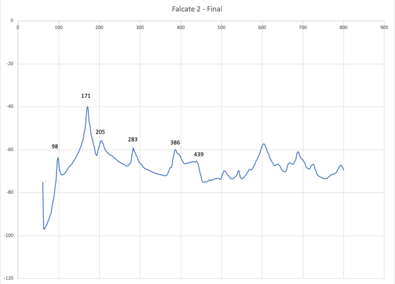

So, everything is finished (aside from some fretwork) and I've added 157g of side weights to each side (for a grand total of 356g including the bolts) to lower T(1,1)2 to 170Hz.
Unfortunately, it looks like T(1,1)3 lowered a bit as well, which I didn't want. That could be just that particular tapping - maybe I'll go back and do it again once it's broken in a bit more and see if things have changed.
Also, it seems like there is very little bridge rotation - I think I need to get some of that fancy 'luthier's clay' to get a proper measurement! It should loosen up a little over time, too, right?
Any thoughts as to why my T(1,1)3 is so low? I followed the plans closely and used Mahogany braces with a GPa of 9.05, which seemed a reasonable number.

I'd call that a win! Well done!
The T(1,1)3 is ~ 3.5 semitones above the T(1,1)2, so far enough away. It would have dropped from 211Hz to 205Hz mainly because of the bridge mass dropping the T(1,1)2 and causing less repulsion upwards of the T(1,1)3.
It's hard to say why the T(1,1)3 is lower than you expected. I don't know if you did any scalloping, but it's pretty sensitive to that. If the G 3rd fret 6th string is OK, I'd be calling it done.
