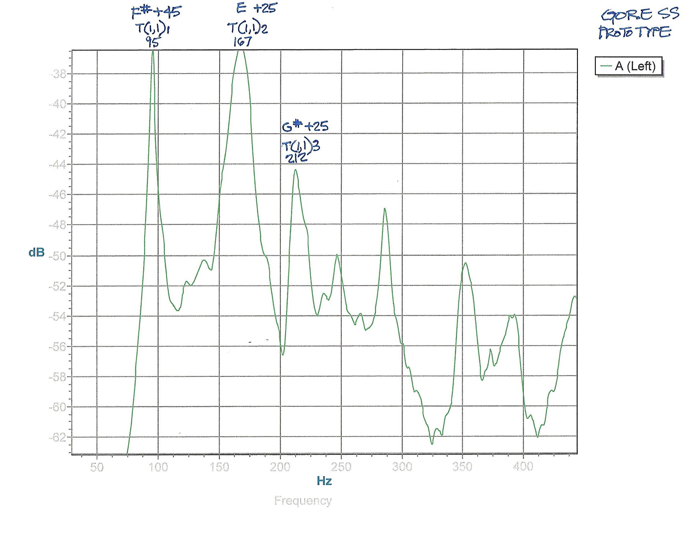

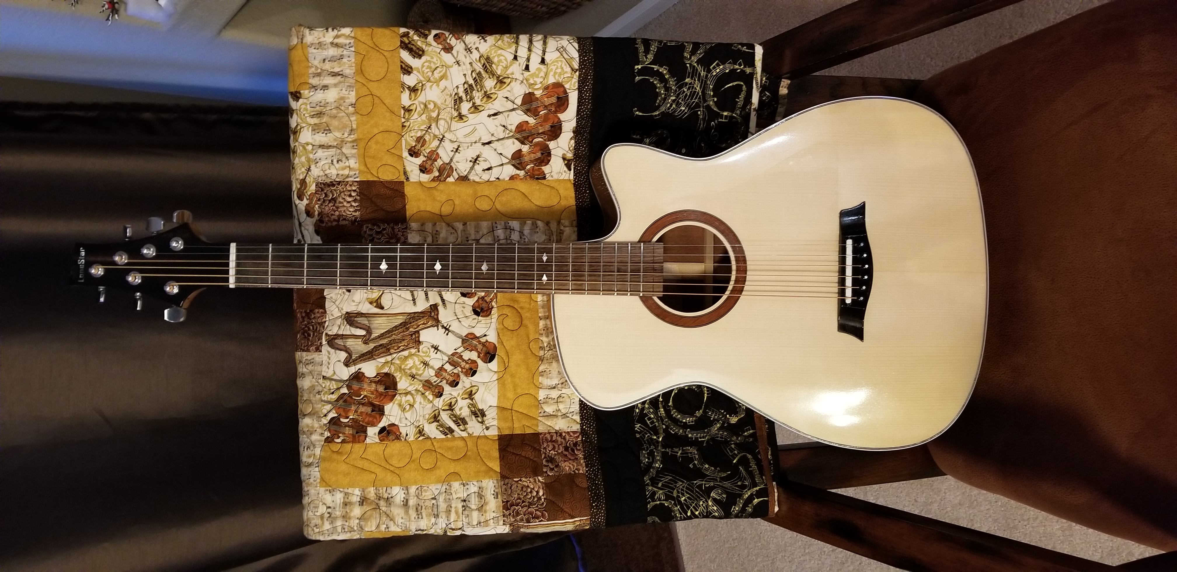

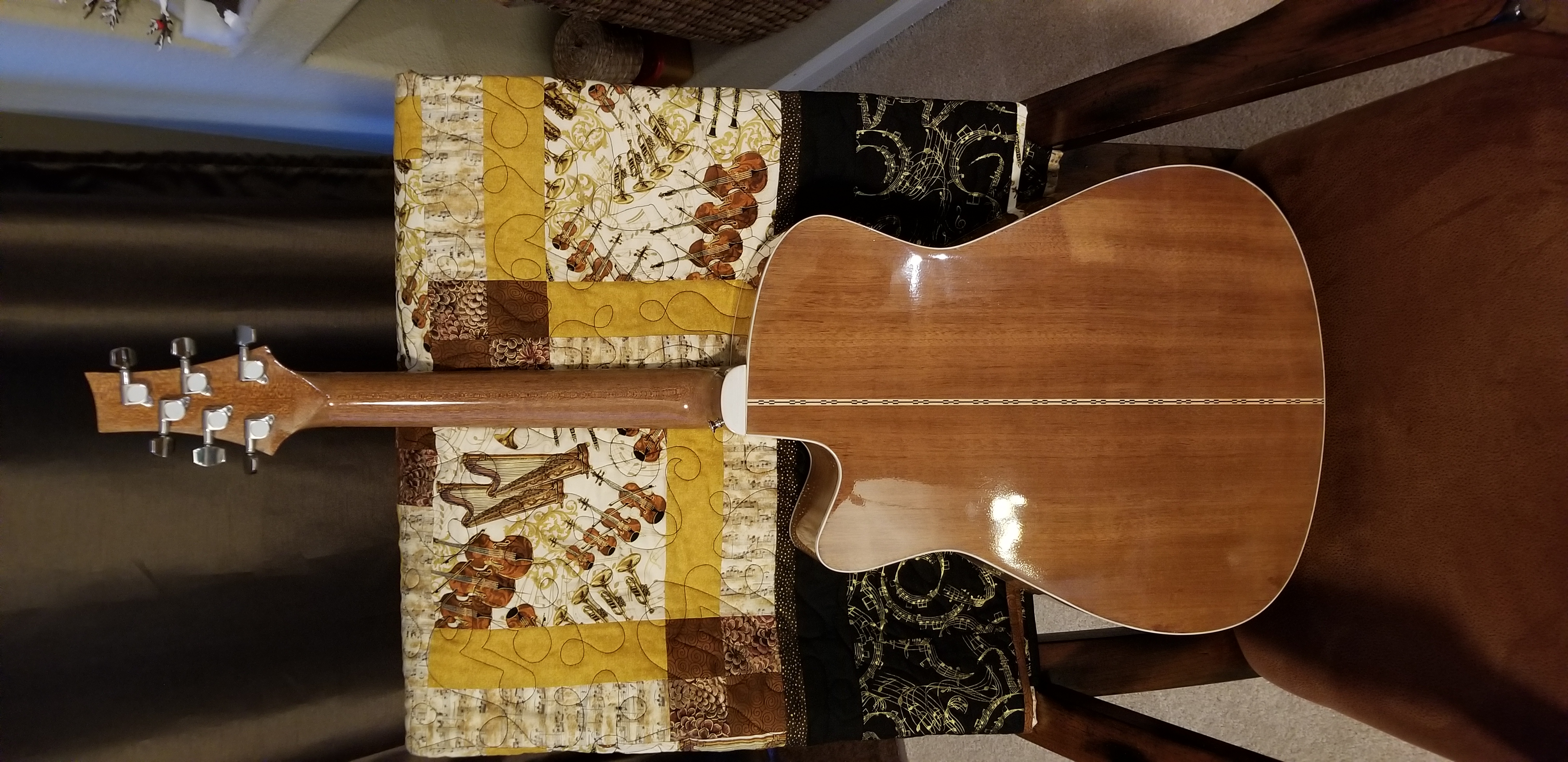

Post by RonRapp » Fri Nov 30, 2018 10:45 am
I wanted to post an update on the finished guitar...Ron
BTW, I am very happy with the final sound!
Thank you Trevor for introducing me to this style of building.
Trevor Gore
Posts: 1639
Re: Predicted Panel Thickness
Post by Trevor Gore » Mon Dec 03, 2018 7:35 pm
Ah, there's the answer to my question in another thread!
Excellent!
