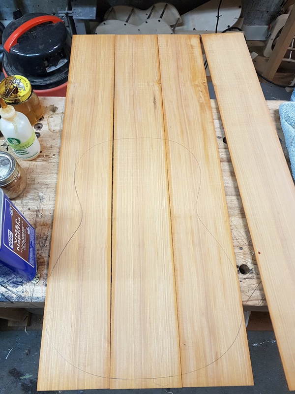

I am making a new classical guitar with pernambuco sent to me by my client. I have never used it before. I need to make a three piece back as you can see in the picture.

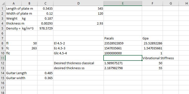

I tap tested the wood as I was getting very clean tap tones. I have not tried it on this narrow of a piece. I could not really determine the LC frequency so I populated it with a nominal value. The wood is dense at 978 kg/m^3, yet rather stiff, Elong is 23.5 Gpa. The spread sheet gives me a thickness target at about 2 mm. I think this is all correct, the long and cross tones were really clear. Has anyone else used pernambuco for a back?

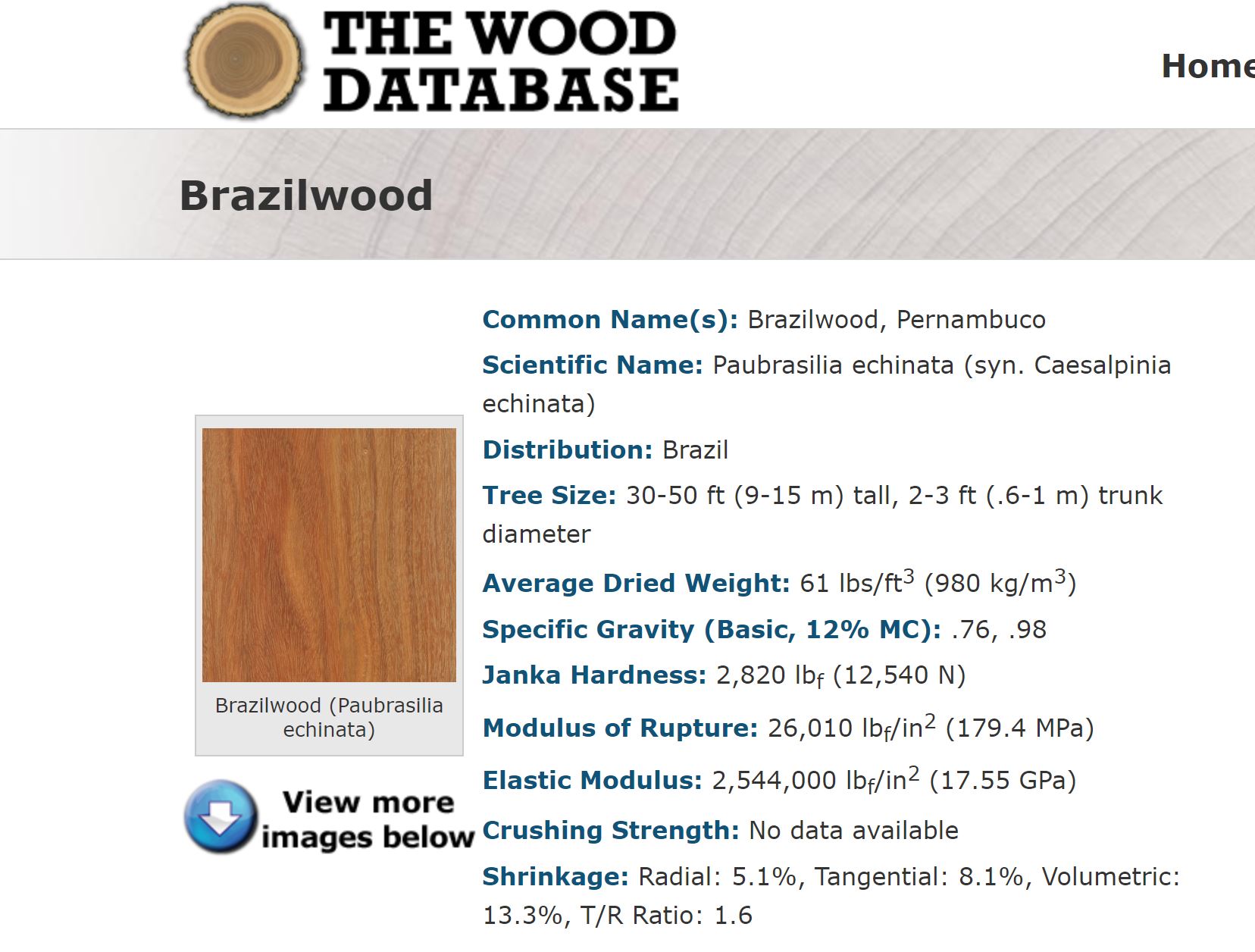

Here is the entry in wood database, I see my results are close.

Lovely looking stuff. I have never had it in my hands. The pattern reminds me of some cypress sides I have had.
Jim Frieson has done a number of pernambuco classical guitars and has posted at least two with three piece backs on the decamp forum as well as at least one with a two piece back. I don't recall seeing him on here.
Try these two links.
https://www.classicalguitardelcamp.com/ ... p?t=104109
https://www.classicalguitardelcamp.com/ ... p?t=104430
I doubt that he uses maths for deciding the thickness however.

Re: 3 piece pernambuco back
Thanks Simon, those posts were really helpful as I like the way Jim laid out the three piece back.
- Posts: 1639
John, I am assuming you're going for a live back because you're computing a target panel thickness. Check what the back panel mass will turn out to be and then compare that with other live back guitars you have made. I'm suspecting that the pernambuco might be too dense and therefore have too low a monopole mobility to get a decent live back without going somewhat thinner on the back (to get the mass down) and stiffer on the bracing to make up for the stiffness you lose in the panel.
Thanks Trevor,Trevor Gore wrote: ↑Mon Oct 15, 2018 10:22 pmJohn, I am assuming you're going for a live back because you're computing a target panel thickness. Check what the back panel mass will turn out to be and then compare that with other live back guitars you have made. I'm suspecting that the pernambuco might be too dense and therefore have too low a monopole mobility to get a decent live back without going somewhat thinner on the back (to get the mass down) and stiffer on the bracing to make up for the stiffness you lose in the panel.
I did get a good back response from my 2 panama rosewood backs, they also were dense at 908 kg/m^3 but stiff El 20.7 Gpa. This back is dense at 978.5 Kg/m^3 but a little stiffer El at 23.5 Gpa. The target thickness for the panama rosewood was 1.93 and the target stiffness for the Pernambuco is 1.99 mm. Being somewhat lazy I removed area from my calculations for comparison as it is the same and multiplied target thickness times density for comparison I get 1.95 for the pernambuco and 1.75 so the mass of this top will have about 10% more mass. I will take your suggestion and make the back 1.9 mm, which puts its mass fairly close to a know good back, and increase the height a the lower back braces a touch.
