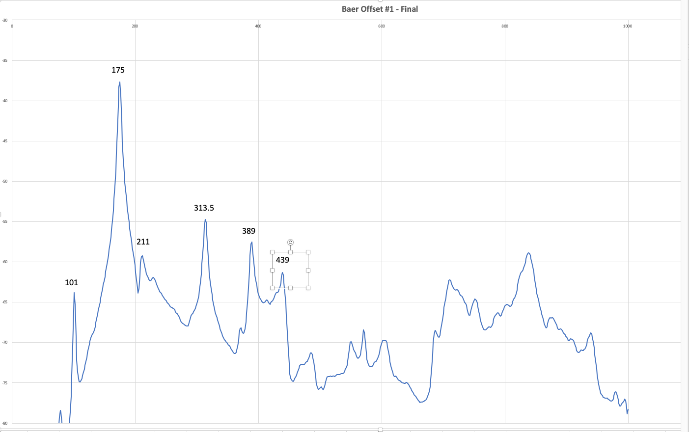

So, the frequency analysis of viewtopic.php?f=33&t=8478 this guitar looks like this:
Do the Books discuss varying dB levels in regard to the various T1, T2, T3s? If so, could someone point me to which section? I'm curious why my T1 is so low (and it's consistent across multiple tappings) in this build and what effect that might have on the sound?
Regarding the T1, 2, 3 frequencies, I think I made the top way too tight in this build. I believe I left the braces too long (too close to the sides) and perhaps didn't thin the edges of the top as much as I could have. Even with a heavier bridge than I'd normally use on a Gore/Gilet build, the T1 is still 100+. I think I'll add some side weights to lower the T2 to give more space from the T3. I carved out the back brace based on initial tap testing, but it lowered far more than anticipated when the guitar was finished and strung up. I always seem to be low in the T3, even before carving out the brace. Any suggestions on how to tighten that up?

All I say is that the dB level is uncalibrated. That is due to the uncontrolled tap strength and the recording environment (mic response, mic position, signal strength, room reflections, etc. etc.). To get calibrated dB levels you need a lot more kit, far beyond what your typical guitar maker would want to invest in. Much of the useful information is in the resonant frequencies, which change very little with tap procedure. Having said all that, you can get quite repeatable results as I show in Fig. AI 1-1.
Adding side mass to bring the T(1,1)2 down to 170Hz should give you a close to "text book" result.

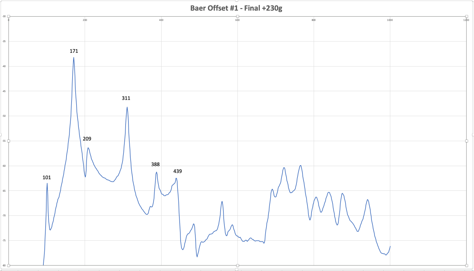

I added 230g (115g on each side) and this is the new spectrum analysis:
I'm going to call that good!!
Thanks all!
