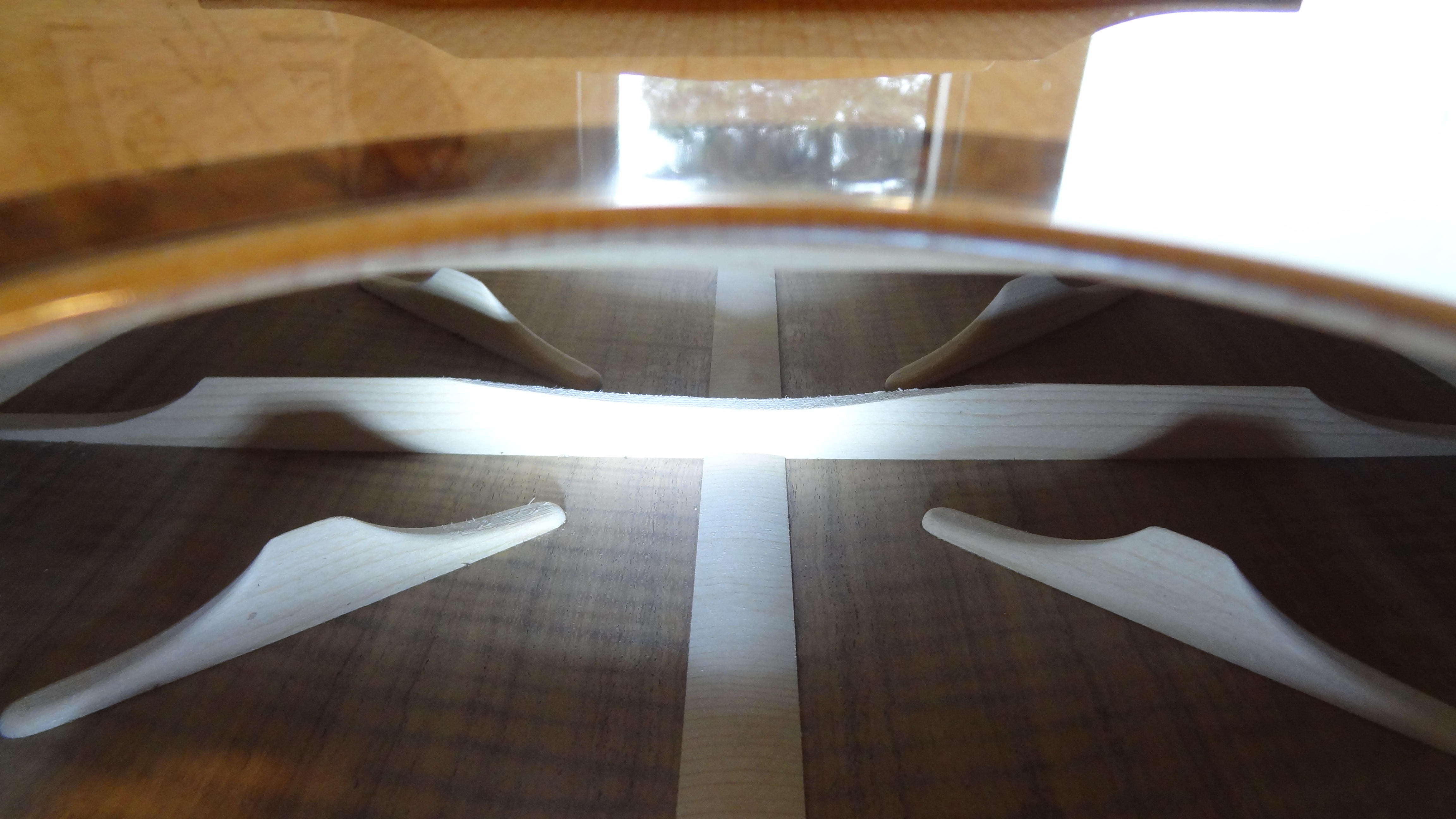

Build section 22.3.1.2 & 3 (pg. 22-8) indicates I could lower the T(1,1)1 & T(1,1)2 at the same time by shaving the back’s lower bout brace to reduce it’s stiffness. I would prefer this to the side masses because the guitar is already heavier than my other guitars because I used ash for the linings to add more robustness per the Books. The 350g makes it quite a bit more. The photo is the current condition of the back brace (accomplished before gluing the box together).
Any input regarding taking that brace down some more to achieve a 5hz drop in T(1,1)1 & T(1,1)2? This assumes I take this route instead of the side mass route. The down side here is the (T1,1)3 is already close to specifications. I have tried adding poster putty to the back, but got somewhat muddied results on the spectrum.

95,170, 214 is a great result. Carving the back brace to reduce the T(1,1)1 and T(1,1)2 sufficiently will bring the T(1,1)3 down way too far and cause acoustics problems that you don't need because you no longer have the 4 semitone separation.
Stringing up will possibly drop the T(1,1)2 a little because of the added mass of the strings acting on the saddle and because the saddle with the strings passing over will possibly be more effectively "joined" to the top. This will mean you will need less side mass to get the T(1,1)2 down to 170Hz.
So string it up, correctly size the side masses and you're good to go.
