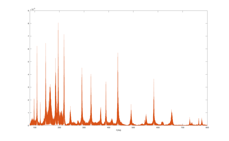

I saved the video as an mp3 and ran a FFT on it and came up with a plot, but of course the peaks are on every note Kenny plays in the video as one would expect. And I know that mics, room, mixing will have a part in the result as well, but /somewhere/ in this plot must be the guitar. Has anybody tried to or had any success in doing this?
The song FYR:
https://youtu.be/jyzPvySio-k
The FFT plot for the song:

I don't have any idea how to do it, but it seems filtering out the frequencies of know musical notes might be a place to star. Or, perhaps set filters that'll only let frequencies pass in the ranges your interested in, minus the musical notes (I'm assuming the instrument doesn't have a natural resonance on a note). Maybe something like 90_110 hz and the 170 - 210 hz. then something for the back. You could probably write an matlab script to do this for you, or use Octave, it's free.

That's similar to what I was thinking Jim - maybe I'll give it a shot. There appears to be a swell on either side of each note peak though which I'm a little confused about (it seems like way too strong of a correlation to be the guitars actual modal freqs).Jim watts wrote: ↑Sun Mar 28, 2021 2:31 pmI don't have any idea how to do it, but it seems filtering out the frequencies of know musical notes might be a place to star. Or, perhaps set filters that'll only let frequencies pass in the ranges your interested in, minus the musical notes (I'm assuming the instrument doesn't have a natural resonance on a note). Maybe something like 90_110 hz and the 170 - 210 hz. then something for the back. You could probably write an matlab script to do this for you, or use Octave, it's free.

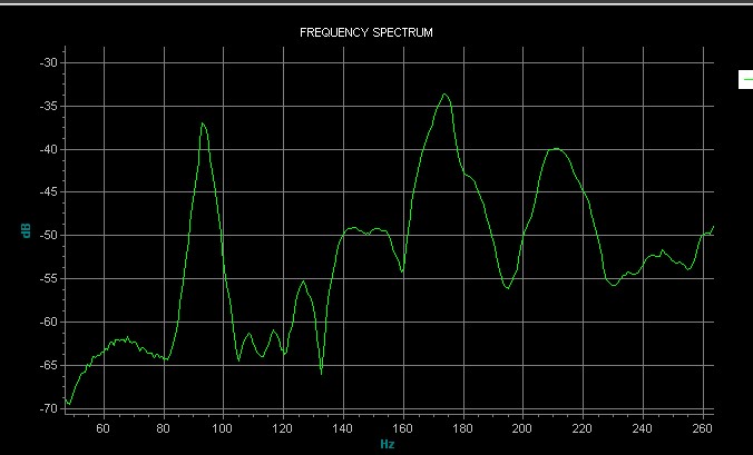

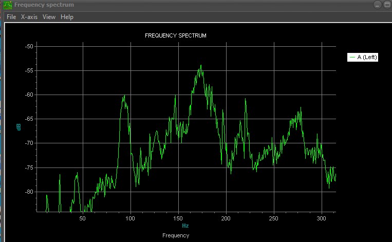

My thought is to collect a lot of samples and then pull out the peaks that show up a lot more than others. There should be resonant peaks off of every impulse. I was watching a spectrum graph in real time as I played. I knew what the tap spectrum looked like and I could see it.
I just thought the mic is right in front of me so ... Here is a sample spectrum playing and tapping. I was playing a solo part on the E and B strings.
Playing: Tapping:
Playing: Tapping:
