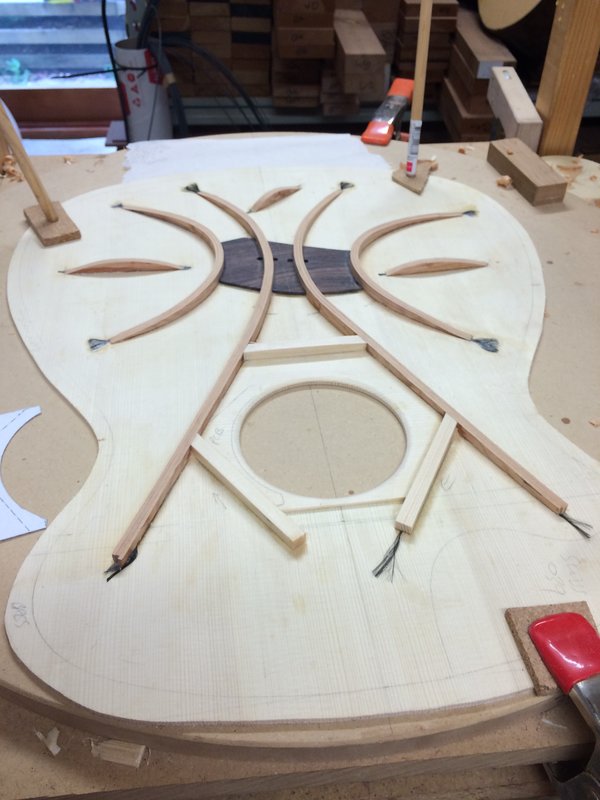

Dave M
Posts: 627
Location: Somerset UK
Re: Falcate brace template
Post by Dave M » Fri Jul 23, 2021 1:35 am
This is a fairly close version of Trevor's medium SS. I think the most important bit as Martin has suggested is to make sure they fit cleanly between the bridge pins.
