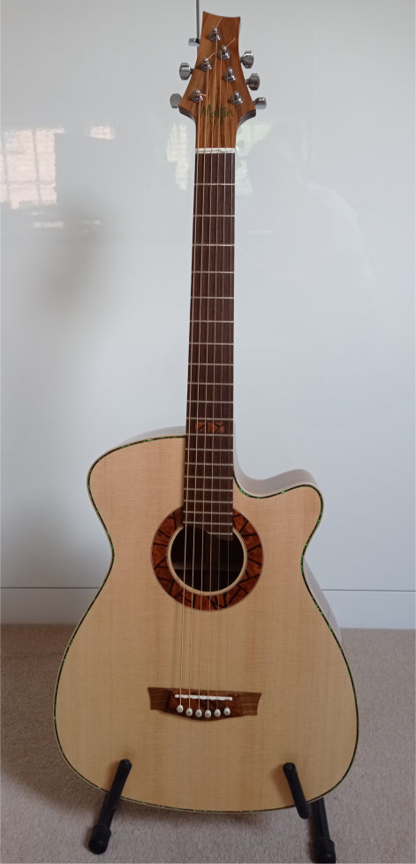

I've finally got round to making a TG falcate guitar (I was put off by epoxy and CF!) and followed the books and drawings faithfully, apart from a 25½" scale length. The specs are:
Spruce
English Walnut
Wenge fingerboard
Burr Elm and ebony rosette and marker
Crazy green celluloid inlay (never again...)
Polyx oil finish

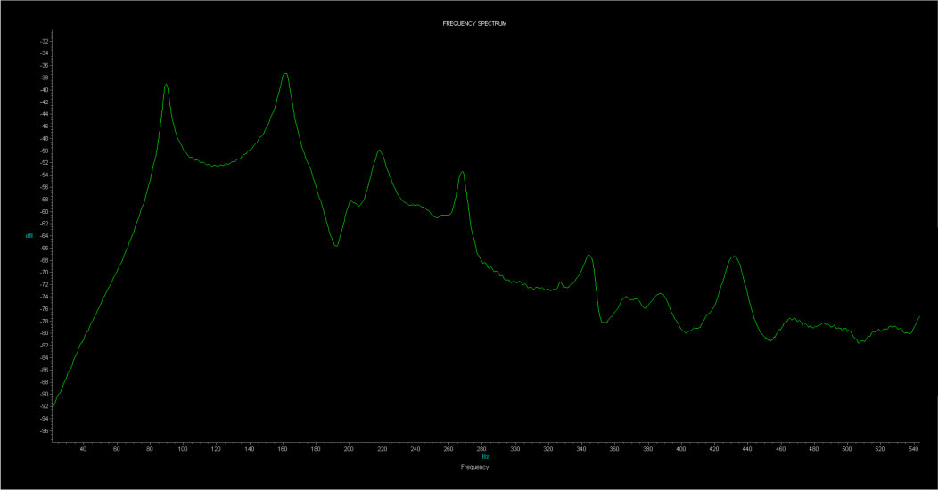

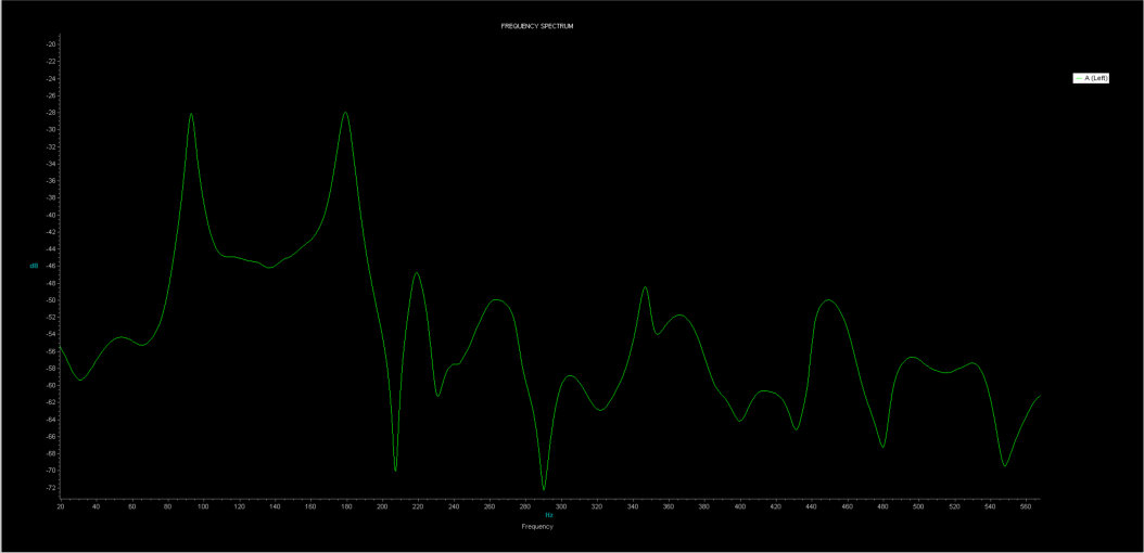

All readings were made in playing position without the neck attached. Here are the plots in order.

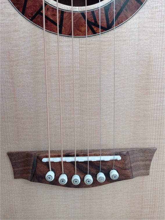

Finished body with bridge glued in place, with bone pins 90, 175, 210
Back brace infilled (infill glued in place with superglue) 93, 179, 219

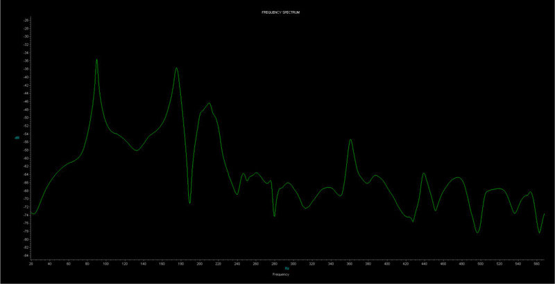

So.... the plan was - add about 600g of side mass to get T(1,2) down to 170 and then trim the back brace to lower T(1,3) to 214
Bolt on the neck and string up....

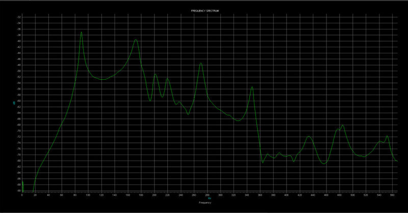

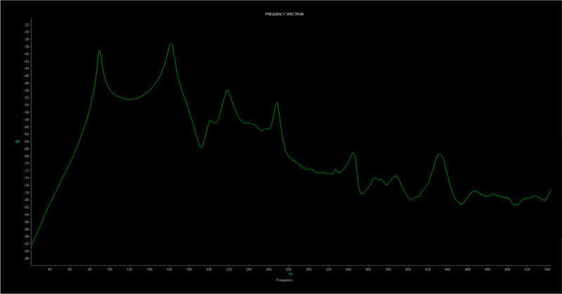

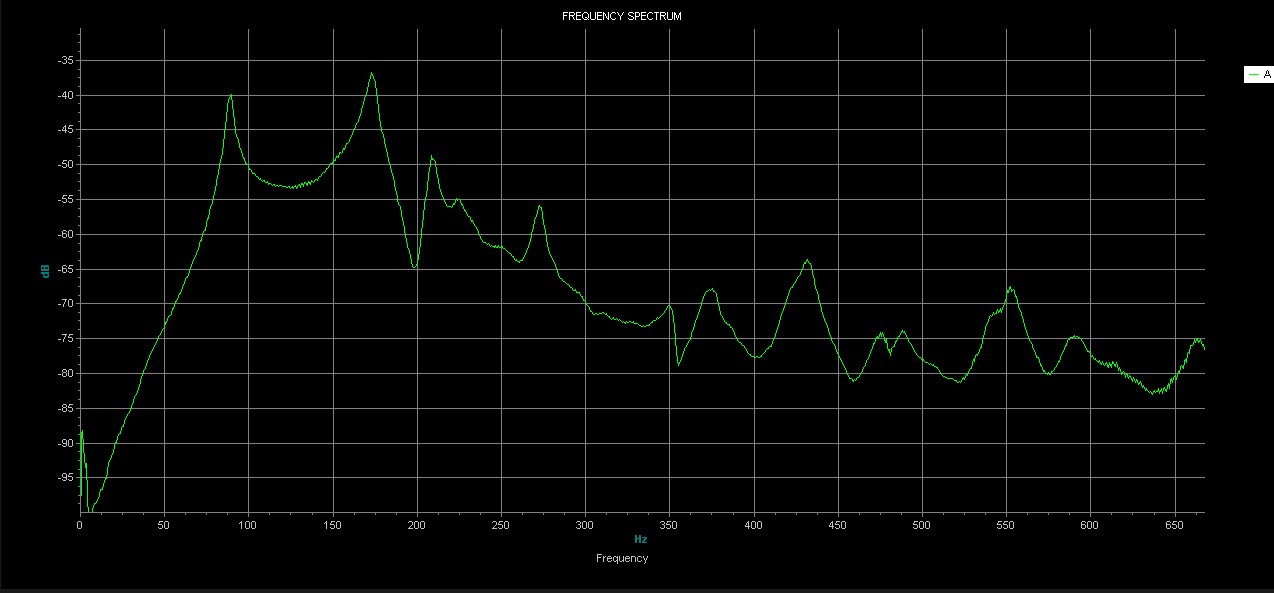

What? Under tension the readings were completely different to what I expected - 90, 161, 217. (Guitar sounded great BTW)

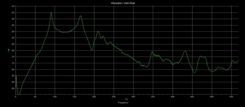

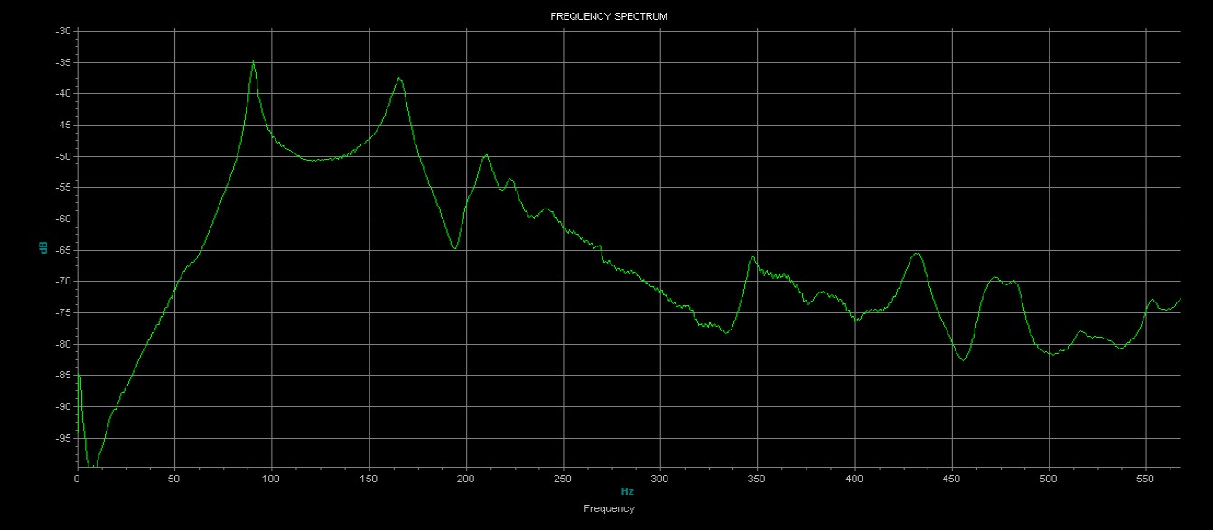

So I took out the side masses and got this plot - 90, 171 and a split 201 - 220
The upshot is - I just don't know what I'm doing..... Can anyone illuminate or clarify for me what is going on?

Stringing up the guitar drops the top resonance T(1,1)2 about 5 Hz and with coupling drops the air and back. Looking at your set of plots I noticed you made changes before stringing the guitar. You looked pretty close with your back low. I would not have made any changes until I had a plot with the guitar under string tension. Because of coupling when you stiffened the back you raise the top and the air resonance. Side mass mostly effects the T(1,1)2 top resonance.

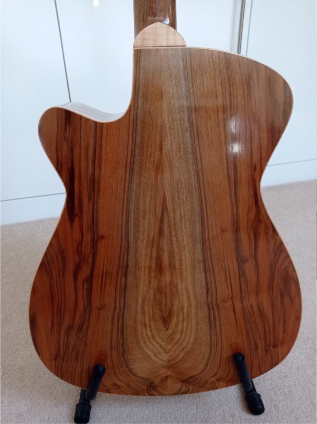

Anyway the instrument looks good, pics of the back and sides would be interesting... and I wonder how you found the Wenge. I read that it isn’t’ much fun to work. Let’s see that rosette that you won’t repeat!

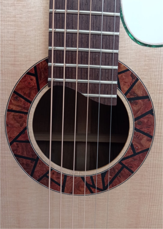

The rosette was fun to make - I was inspired by Martin's (Kiwigeo) multiscale masterpiece. The green celluloid purfling is really striking but proved really hard to scrape level - which then showed loads of gaps that I had to fill with liquified celluloid, which was even more difficult to level!

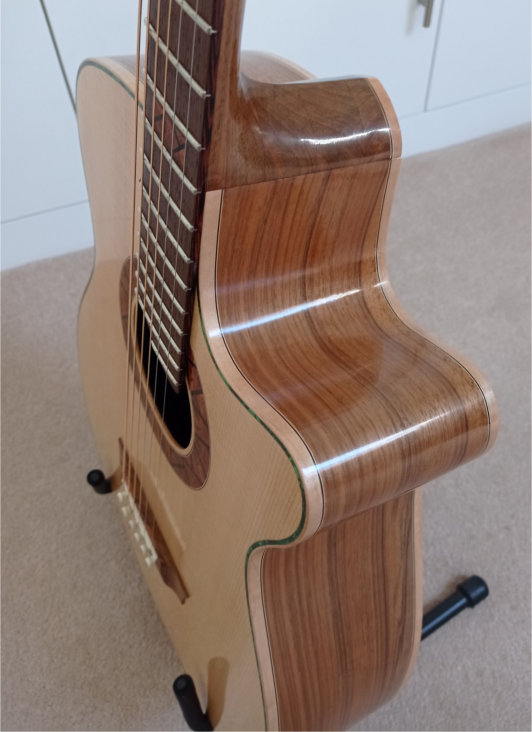

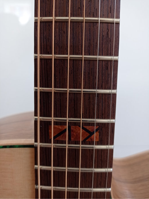

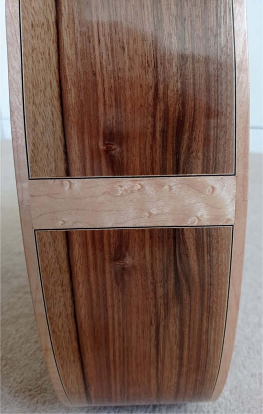

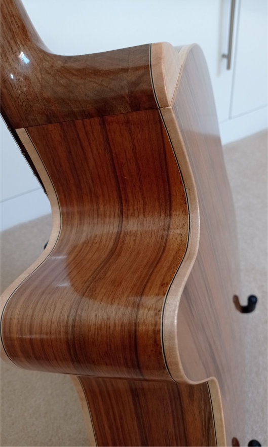

Anyhow, here are some pics, and thanks again
Fret marker.jpg (119.89 KiB) Viewed 33402 times

Gorgeous guitar! The frequency spectrum looks good with a lot of peaks and the guitar came out very close to target before doing anything. How does it sound now? How is the intonation?
Jason Kostal was the inspiration for my segmented "stained glass" rosette

Thanks for putting the photos up. That Walnut is really nice - well matched. I have used American Walnut which is OK but much plainer. A great looking guitar, and a nicely shaped heel.
I was new to CF and epoxy but once into it it was fine, though pretty messy in the first go rounds!,
It is quite funny how design elements descend through a series of builders, re Martin.

Regarding the changing frequency responses, your early responses without the neck mean you couldn't have had strings on, and you may not have had saddle and bridge pins in. Just adding the mass of the strings can make quite a difference which people often put down to loading the soundboard with string tension, when I usually find that the change can be accounted for by the added mass.
To properly identify what is going on you need to know which resonance each peak represents, which can be determined using Chladni patterns. With added side mass and possibly saddle/pins/string mass, the resonances will be redistributed and one may have emerged from beneath another.
The only sure way to find out is to get the Chladni gear out. It would be very interesting to know what is responsible for your peak at 201Hz. I have an idea, but it would be good to see it independently verified.
Your tap responses are very clean, by the way, so well done there. As many have a lot of trouble getting clean plots, would you like to share how you did that? TIA.

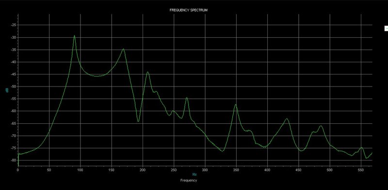

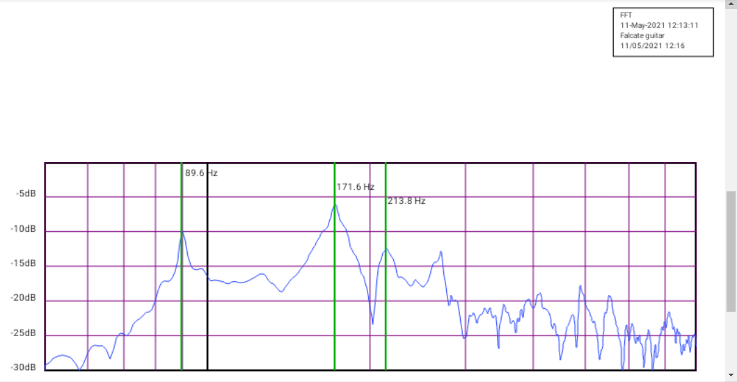

So.... Set up is pretty much there. Intonation is a little sharp, which is disappointing - I'll get on to that later.

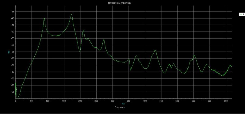

Here is the tap test on VA - 90, 173, 209
I decided to add 230g side mass to shift T(1,1)2 and got this result - 90, 169, 208
I've already infilled the back brace - any suggestions as to how I can lift T(1,1)3 to 214Hz? Perhaps a more substantial, taller infill, perhaps extending the infill wider on the brace?
TIA

Martin thanks for putting this stuff up. I don't think any of us find it easy so info on how other people do it is always useful.
Just for information, to excite Chladni patterns I use an old domestic stereo amplifier (doesn't everyone have one in a cupboard somewhere?) a cheap car speaker which I built into a simple MDF box, and VA to provide a frequency signal. It works fine. The 4 inch or so speaker is about the right size to excite the smaller areas that are resonating.
Even then it is not always straightforward to sort out the various resonances.
Cheers Dave

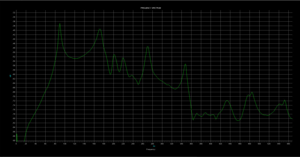

I'm getting frustrated now. In the quiet comfort of my studio I set up VA to do another tap test.... and got 90, 165, 210
Which hints that I didn't need to add 230g side mass.

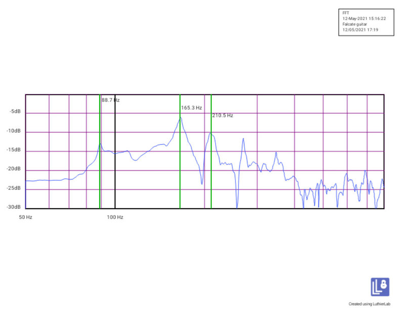

I may be getting clean tap spectra, but the inconsistency is annoying. I was playing around with Luthier Lab and got this spectrum with a single tap, which is what motivated me to check....
I honestly have no idea why the tap test in the workshop is different apart from the ambience.
Has anybody else experienced this variability?

Is it some time between the measurements? Could the guitar be settling in? It is the top that is changing, could the string tension be changing the top resonance?

The guitar has been settling in for a few days - and the top is visibly less arched. I guess this means my bracing was not stiff enough...
