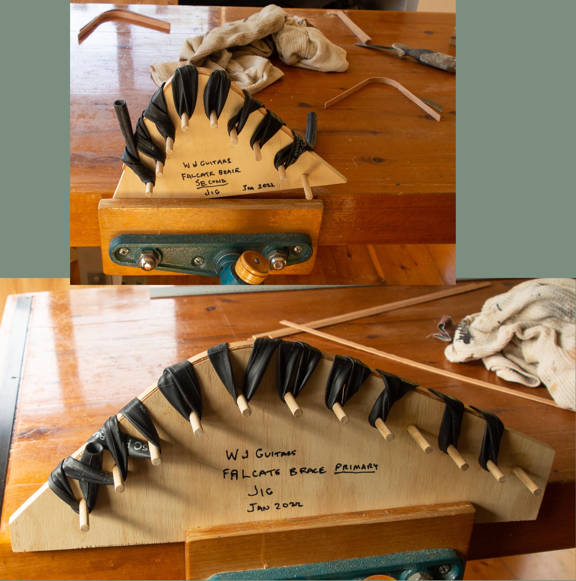

Looking for spruce bracing billets may be an alternate options. I have used Adirondack Spruce pieces cut from billets and then thickness on a drum sander to 1.7mm thickness to make the laminations that can be glued together on jigs that are shaped to make the primary and secondary falcate braces. You need to be careful and take your time to slowly bending the 1.7mm thick laminate strips on a bending iron to minimise them breaking.

Here is a photo of my Primary and secondary Falcate Jigs.
