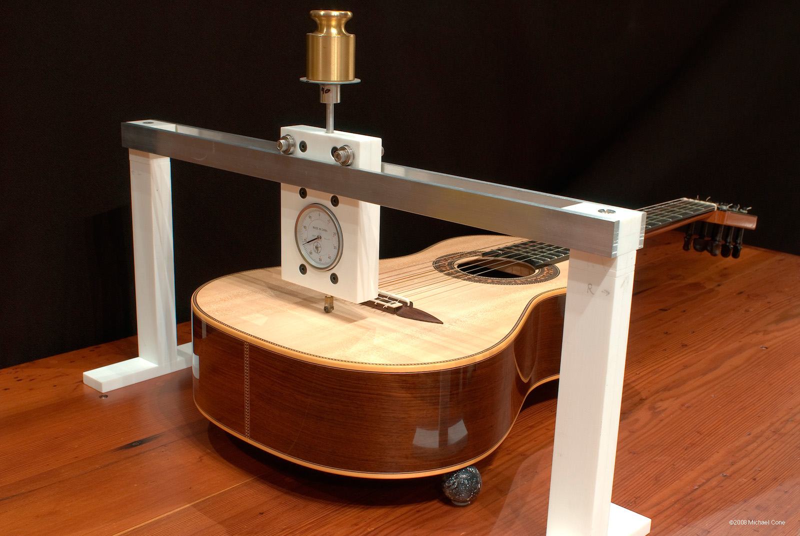

Found this neat construction. It's from Michael Cone ( http://www.coneguitar.com/acoustics/a02.html)
Edzard

That's a nice looking jig, but it has a major flaw. The way it is set up with the base on the table, it will measure not only the top deflection, but also the guitar side deflection, the deflection (compression) of whatever the guitar is sitting on, plus any play in between. These will be considerable and likely affect the measurement substantially. (I know because this is how I made my first jigs). To get rid of all this, the jig needs to rest on the top of the guitar like some of the pictures earlier in this thread. Also, watch out for that pretty brass weight if you happen to bobble it
Re: Top Deflection rig
Yes Craig , that is the problem and why I designed mine to sit on the edge of the soundboard.
It does not then matter whether the guitar is sitting on a towel, foam blocks, or surgically enhanced breasts.....

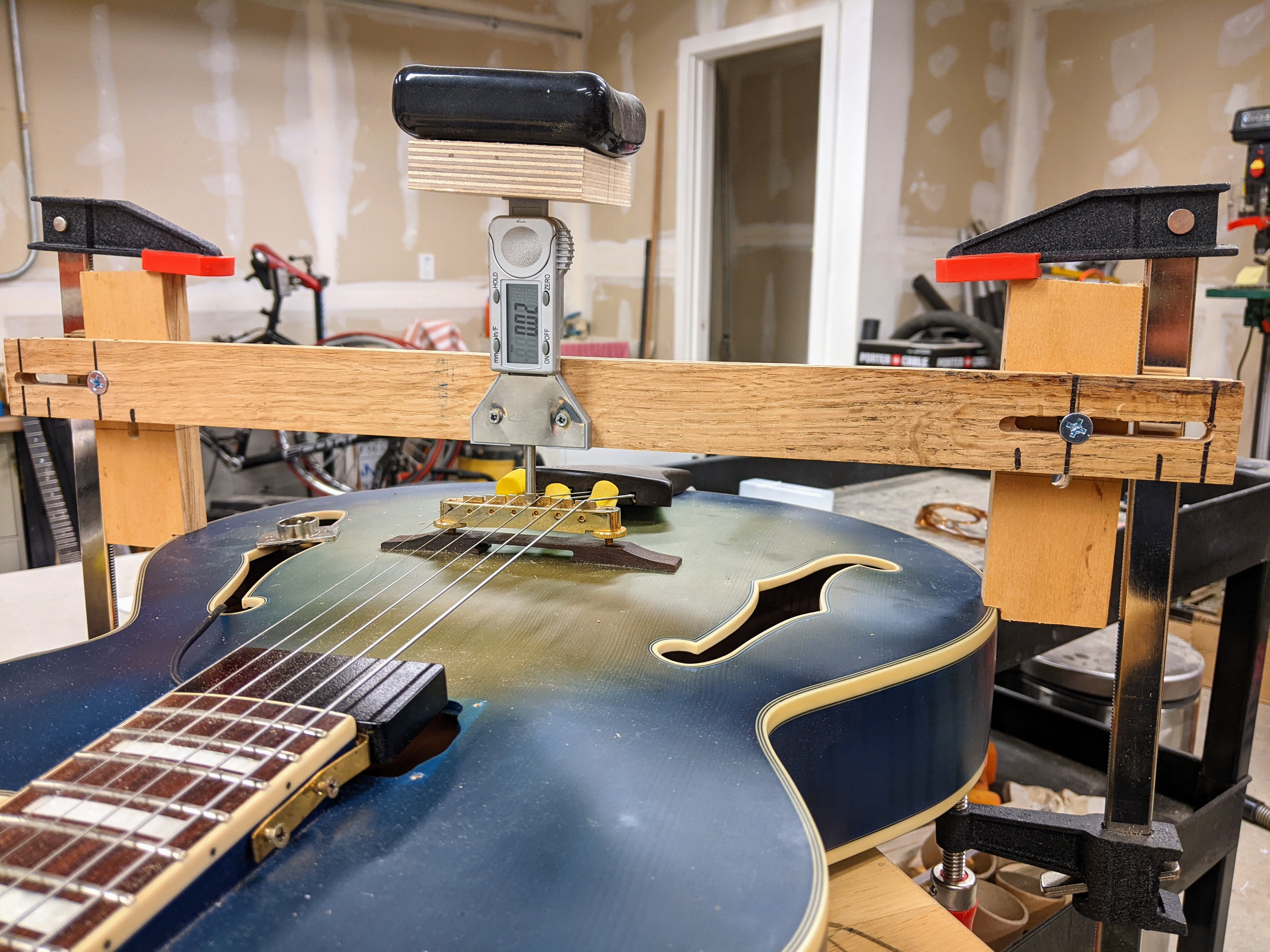

Here's my very crude rig. It can be adjusted for both height and width via slots in each member. It works, but I think there's room for improvement.
For a weight I used a 1 kg lead diving weight (1006 grams, actually).
On this Ibanez archtop (the top of which is greatly overbuilt), I got a deflection of 0.02 mm, giving a stiffness of 50,300 kg/m.
I'm concerned about the resolution of the iGaging depth gauge. If I can only get values of 0.01, 0.02 and 0.03 for this particular guitar, then I can only get stiffness values of 100,600, 50,300, and 33,533. It seems like I need a more accurate gauge.
What other gauge products are people using? Something that reads to 0.001 mm, I think.
Thinking about it more, the problem with this guitar is that it's just too darned stiff!
First, I should have done the calculation in newtons, not kg. In which case, this top has a stiffness of about 490,000 N/m. I think a typical stiffness for a steel-string flat-top is about 47,000. So this top is about 10X stiffer.
At a typical stiffness of 47,000, deflection would be about 0.21 mm. To get that deflection on my archtop, I'd need 10.6 kg!
Hmm. Maybe it's better to move onto testing a different guitar. I don't think I want to put that much weight on this rig or this top.
I can see that a resolution of 0.01 might be fine with a less stiff top. With my 1.006 kg weight, 0.21 mm would result in 47,000, and 0.22 would result in 44,800. That would be increments of 4.5%. Maybe that's close enough.
Greg

Re: Version 2
OK, the last one I showed was a bit crude. But I learned a lot, and have tried to improve it.
For one thing, I bought a better indicator (US$39), which claims 0.001 mm accuracy. Well, it reads to three decimal places anyway...
Two improvements.
1. Longer edge resting on the guitar prevents wobbling.
2. A lever arm amplifies the movement 10:1. It pivots on a small nail 50 mm to the right of the center, and the indicator is 500 mm from the nail.
I think there are still some opportunities for improvement.
I'm having troubles getting consistent readings. I can lift the weight and put it back down and get a reading that's 10% different. I'm not sure what's causing this. Maybe I should just use the traditional method without the lever arm.
I've also tried various weights. I expected the same stiffness, K = F/y. That is, I expected the force:deflection ratio to be constant as the force increased--i.e. if I double the force, I expected double the deflection. Instead I found K was smaller with more force--that is, I got more deflection than I expected with the bigger weights, based on the measurement with the smallest weight. Almost twice as much deflection than expected. This is telling me something, but I'm not sure what. Is it telling me something about the guitar, or something about the rig?
Greg
Two improvements.
Greg

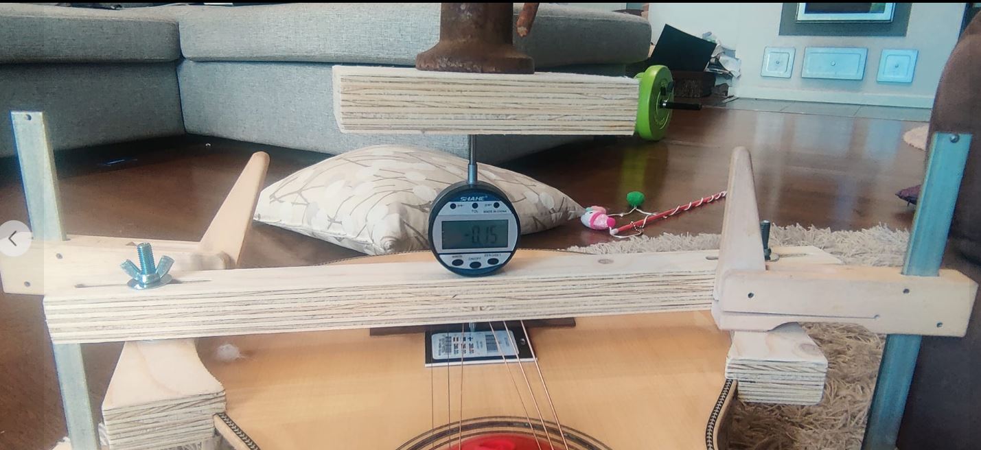

Thanks for all the pics for deflection jig implementations. I proudly copied yours to my jig.
After doing some repetitive measurements, I got a mobility result of ~20 for my falcate braced guitar. The measurement still has some error sources:
- I need to stiffen the horizontal bar to guarantee it does not bend at all by the weight applied. If it bends, I think I get "too" good results
- I played around with the excel sheet with the book equations : as my gauge guaranteed accuracy is +-0.01 mm, I entered such variance to my end result: seems that if I alter top deflection by 0.01mm to one direction or another, the mobility result changes from 20 to 23 or 17 , ie > 10%. For accurate results, I may have to weigh using different weights (like 250-500-750-1000g and use linear fit to find the exact value for K . My feeling is the bigger deflection I get, the smaller the tolerance impact of the gauge becomes.
Orienting the horizontal bar with ply laminations running vertical would reduce risk of flexing.
