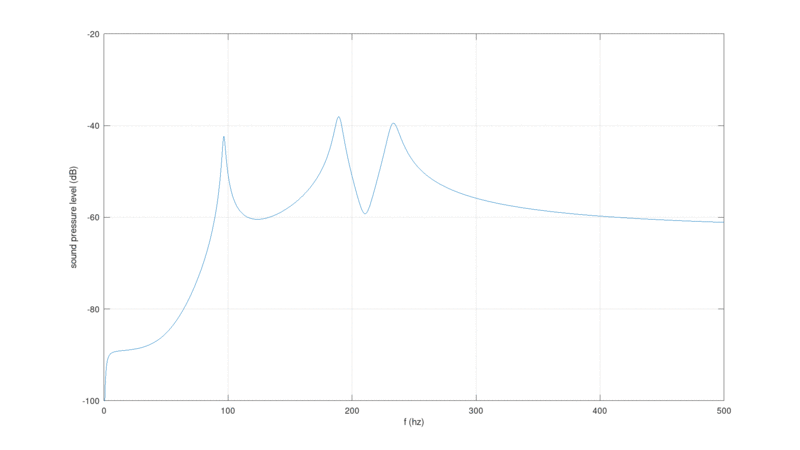

I know this thread is really old, but I just want to give a big "thanks" to Jim Kirby and everyone else who worked on this. And if course Trevor Gore for writing the book in the first place!
I installed the free open-source software GNU Octave (version 6.2.0 for Linux), copied the script Jim posted here, and it just worked! Plugging in the parameters from the book page 2-37, I got a graph nearly identical to the one in the book (some very slight differences, probably precision differences with the Excel spreadsheet software).
The script is surprisingly short for such complicated formulas. I hadn't realized until I looked at the Octave Workspace pane that these formulas involve multiple 1x5000 vectors (of double) and multiple 1x5000 vectors of complex doubles. Matlab and Octave are amazing. I can't imagine doing this in a spreadsheet!
This will allow me to play with different body dimensions and sound-hole sizes to target certain coupled frequencies (air, top, and back) with reasonable confidence that when I build it, it will at least be in the ball-park of those frequencies. And then I can adjust a little in the finished guitar. In addition, the script can print out the uncoupled top and back frequencies so I can target those in the separate components before I assemble the body. Fantastic!
Thanks again to everyone here! This script should be easier to find, it's so useful.

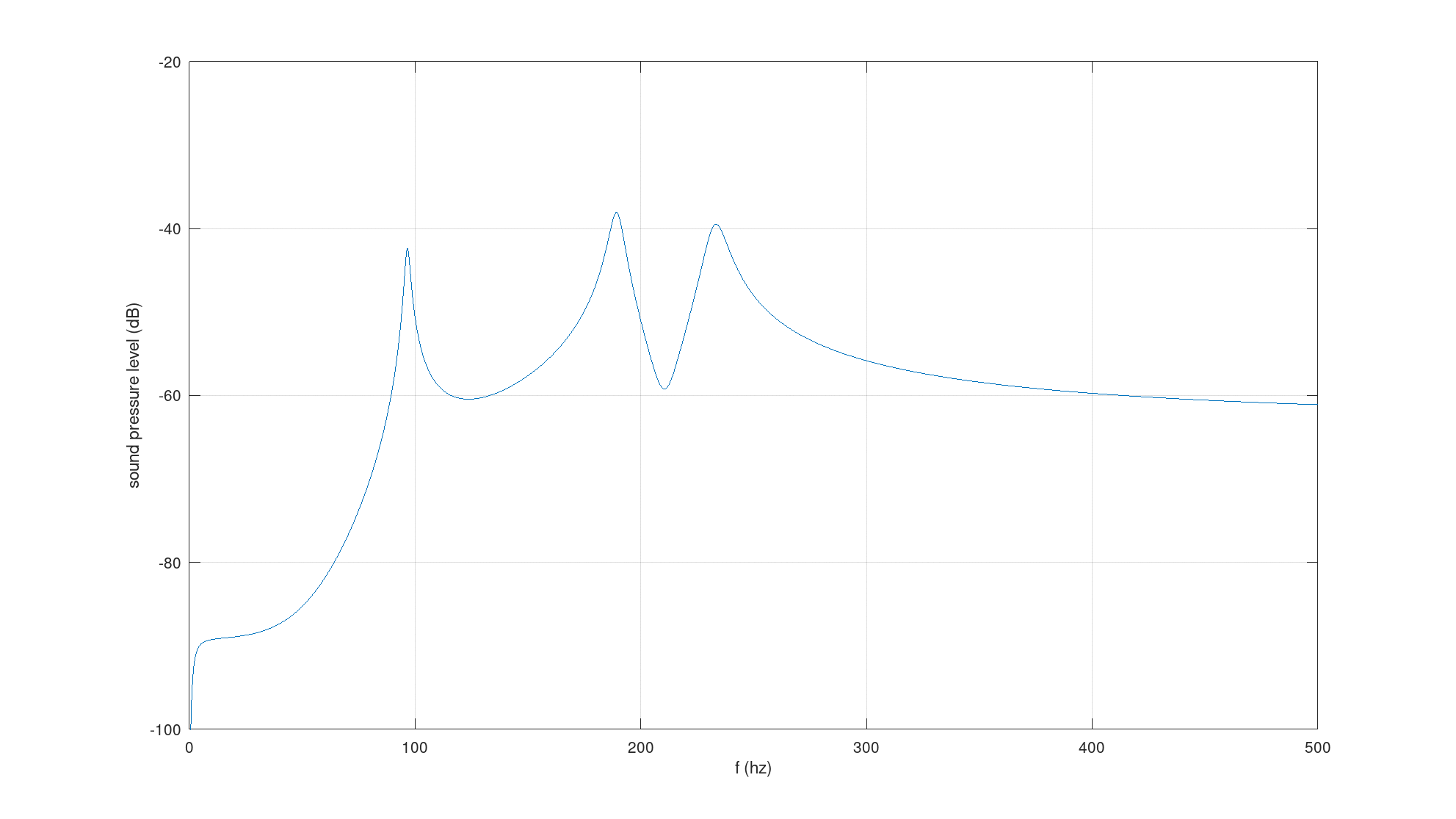

Post by GregHolmberg » Sun Feb 18, 2024 1:46 pm
Can Google Sheets implement the 4DOF model? Yes, it can. It works pretty well, too. The graph appears to exactly match the output from Jim's Octave script (graph I posted earlier in this thread), and is pretty close to the book, Fig. 2.4-4. The differences appear to be in the dB values, but the frequencies of the peaks look the same to me.
4DOF spreadsheet
Anyone can view it, and see the formulas. Anyone can File->Make a copy and change their copy.
I haven't found a way to identify the db peaks though, so you have to do that manually.
I think this was the hardest spreadsheet for this book. Took me a couple of days. Although, the intonation one was no walk in the park!
I hope this helps someone.
Greg
