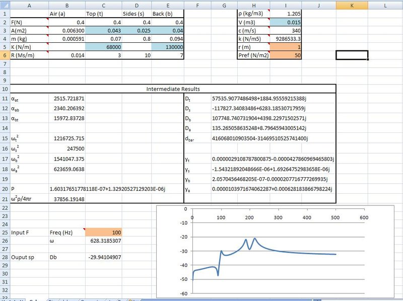

I just hand calculated the alpha products based on your input parameters and got:
alpha at = 2515.72187
alpha ab = 2340.20639
alpha bt = 15972.8378

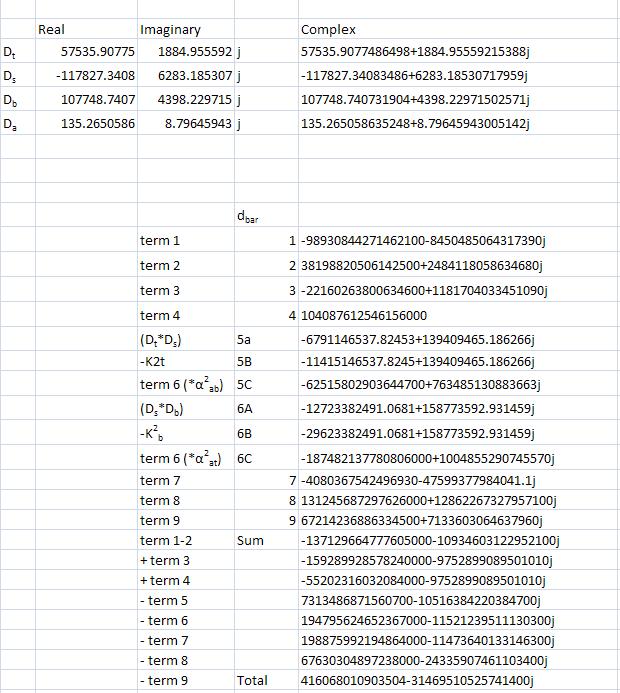

in the spreadsheet I calculated the area and mass values of the air plug and the value for k and had
alpha at = 2506.61132
alpha ab = 2331.73146
alpha bt = 15792.83733
by removing the calculation and changing the parameters to the values in the book I got the same as the hand calculations. If you used Excel to do the calculations then I suspect you are right and it's all to do with rounding as I know that regardless of how the cell is formatted Excel keeps the full value to n significant digits in memory and uses that value in further calculations. It probably doesn't fully explain the plot shape but it certainly wouldn't help as I am wondering about how this problem could be compounded by the IM functions given that there is probably a lot of rectangular to polar conversions and vice versa going on in the background

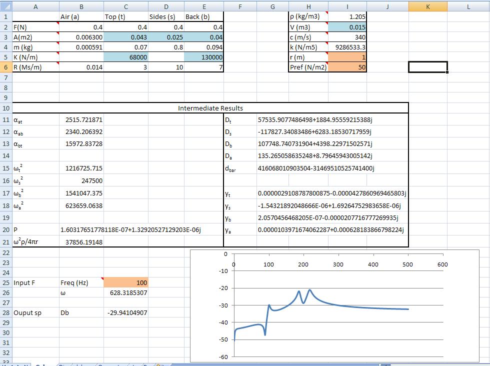

I've copied all the intermediate values to the front sheet of the spreadsheet and attach it to give you an idea where I'm at.

trevtheshed wrote:John, the D's are all a function of ω, so how are you handling that? In your last post you must have them evaluated at a particular frequency?
ω (2piF) - in fact all the values on the screenshot - is the result of the 100Hz entered in the input box. The table (off screen) auto inserts all the values from 0.65Hz to 500Hz and obtains the output value for that frequency from the Db cell and plots those values. Any of the parameter values can be changed manually without effecting the plot as the plot is generated solely by the table using the rules set up by the what_if/data table function.

Dt 57535.9078102831+1884.95559215388i
Ds -117827.340834859+6283.18530717959i
Db 107748.740785237+4398.22971502571i
Da 134.116591266459+8.79645943005142i
Dbar 2.31298863526292E+015-3.13890440436301E+016i
yt 8.92142530804812E-007-1.06182023060313E-004i
ys -3.60260052415647E-006+4.21352341350602E-006i
yb -2.97308070238133E-006+7.88220882586067E-006i
ya 1.20465668054809E-004+1.56376242027309E-003i
It seems to agree, reasonably, up to the real part of Dbar. I checked my coding for Dbar and it seemed OK.

trevtheshed wrote:Dt 57535.9078102831+1884.95559215388i
Yup, problem starts as soon as I hit the IM functions. I think there must be something about the way I am using them. I took your value for Dbar and inserted it and the Y values went wacky. I'll pull up the help on IMProd, IMSub and IMSum and see what I'm doing wrong.

I went through the Dbar calcs last night and I couldn't find anything that stood out. I then calculated (at least using Excel but without the IM functions) a couple each of the products and then sum and subtract terms and got the same answers as with the IM functions so think I am using them ok. I'm down to thinking that I have a mistake in the method (or several) in there somewhere.
Tonight I will plug the calculated values for Yi back into Eq AII 2-25 through 2-28. I figure that once the solution to AII 2-25 equals AII 2-40, etc. then the maths must be correct.

trevtheshed wrote:Yes, the Dbar calc is massive. I did it with IMPRODUCT over 11 columns and then used IMSUM.
You're not wrong!
I broke it down to 21 rows and annotated it as I kept losing track. Plenty of scope for errors though. Hopefully Dom will pick up my blunder as I am going bleary eyed looking at it.

johnosb wrote: Tonight I will plug the calculated values for Yi back into Eq AII 2-25 through 2-28. I figure that once the solution to AII 2-25 equals AII 2-40, etc. then the maths must be correct.
Done this and found that there are about 12 orders of magnitude difference between yt at Eq AII 2-40 and plugging in the y values into AII 2-25. No small difference, you'd reckon it would be easy to find
