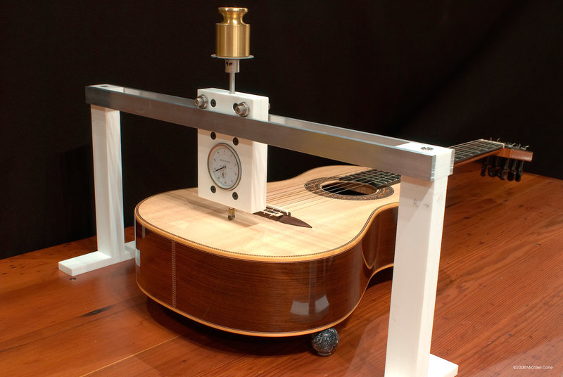

Found this neat construction. It's from Michael Cone ( http://www.coneguitar.com/acoustics/a02.html)
Edzard
Craig Bumgarner
Posts: 195
Joined: Thu Apr 11, 2013 10:28 pm
Location: Drayden, MD, USA
Re: Top Deflection rig
Post by Craig Bumgarner » Tue Nov 10, 2015 3:59 am
That's a nice looking jig, but it has a major flaw. The way it is set up with the base on the table, it will measure not only the top deflection, but also the guitar side deflection, the deflection (compression) of whatever the guitar is sitting on, plus any play in between. These will be considerable and likely affect the measurement substantially. (I know because this is how I made my first jigs). To get rid of all this, the jig needs to rest on the top of the guitar like some of the pictures earlier in this thread. Also, watch out for that pretty brass weight if you happen to bobble it :o
Craig Bumgarner
Bumgarner Guitar Blog

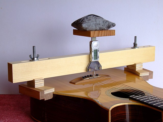

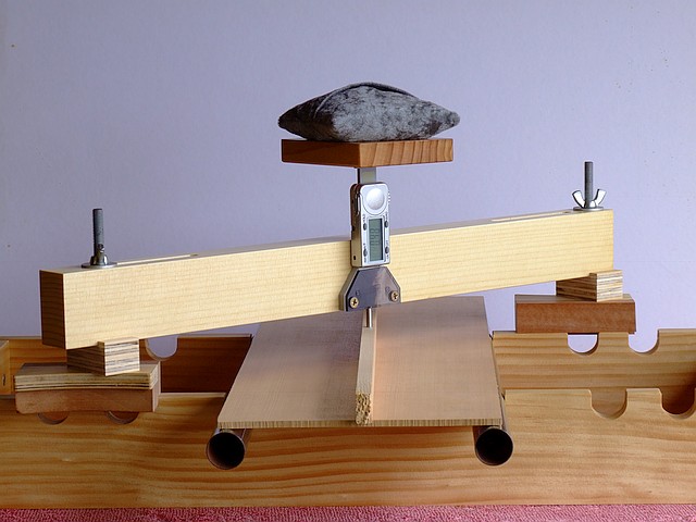

Post by Trevor Gore » Wed Jun 28, 2017 11:51 pm
The traveling 3 day modal tuning course goes far and wide, which means hoping the gear at the destination works OK, or taking your own. The problem is my gear is all made of heavy hardwoods so easily exceeds a baggage allowance, so I thought I would re-do my top deflection rig to a lower mass version and make it multi-purpose so I can use it on a three point bending rig as well.
Here's the new top deflection rig:

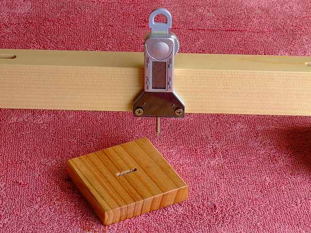

This is all pretty self explanatory if you've read through to early part of this thread. The cross beam is now spruce, so less than half the mass of its Tassy oak predecessor. The gauge has gone low mass digital. It's basically a tyre tread depth gauge by iGaging (as used on the LMII string height jig). The loading is through the shaft as discussed above and the load is 1kg of lead shot in a plastic bag in the "velvet" bag (which is the lining material of Hiscox cases).
The loading platform is a push fit on the gauge shaft:
The gauge has all the usual digital benefits of "zero" and "hold" buttons and reads in mm, decimal inch and fractional inch for those who refuse to use SI units!
The shoe that sits on the guitar (see first pic) now has an extra bit of wood glued on the outside, so the cross beam can be used on my new low mass, knock-down, 3 point bending rig:

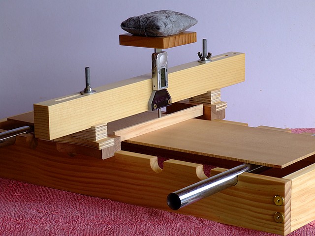

Cross grain stiffness can be measured as well by setting the beam diagonally across the test panel:
The top loading and top reading indicator is much easier to set up and use than my old rig, which was a troublesome top loading arrangement with a difficult to read dial indicator beneath.
The last bit of new gear is a low mass Chladni sig gen, but I'll start another thread for that.

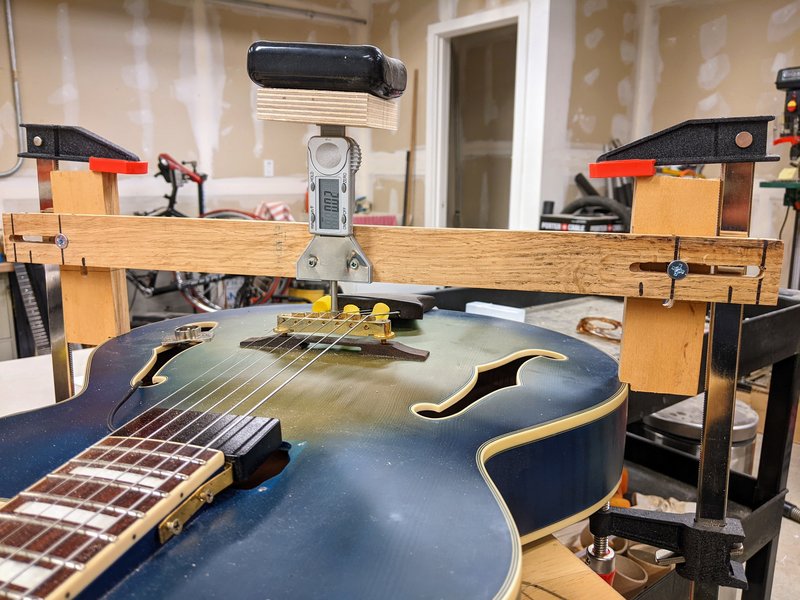

Here's my very crude rig. It can be adjusted for both height and width via slots in each member. It works, but I think there's room for improvement. :?
For a weight I used a 1 kg lead diving weight (1006 grams, actually).
On this Ibanez archtop (the top of which is greatly overbuilt), I got a deflection of 0.02 mm, giving a stiffness of 50,300 kg/m.
I'm concerned about the resolution of the iGaging depth gauge. If I can only get values of 0.01, 0.02 and 0.03 for this particular guitar, then I can only get stiffness values of 100,600, 50,300, and 33,533. It seems like I need a more accurate gauge.
What other gauge products are people using? Something that reads to 0.001 mm, I think.
Greg

Thinking about it more, the problem with this guitar is that it's just too darned stiff!
First, I should have done the calculation in newtons, not kg. In which case, this top has a stiffness of about 490,000 N/m. I think a typical stiffness for a steel-string flat-top is about 47,000. So this top is about 10X stiffer.
At a typical stiffness of 47,000, deflection would be about 0.21 mm. To get that deflection on my archtop, I'd need 10.6 kg!
Hmm. Maybe it's better to move onto testing a different guitar. I don't think I want to put that much weight on this rig or this top.
I can see that a resolution of 0.01 might be fine with a less stiff top. With my 1.006 kg weight, 0.21 mm would result in 47,000, and 0.22 would result in 44,800. That would be increments of 4.5%. Maybe that's close enough.
Greg

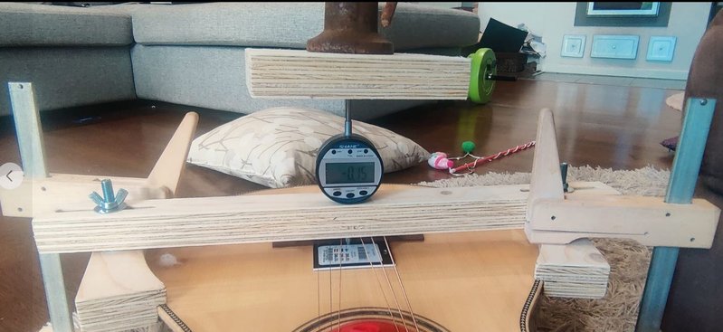

Post by edvinguitars.fi » Mon Jul 29, 2024 4:40 am
Thanks for all the pics for deflection jig implementations. I proudly copied yours to my jig.
After doing some repetitive measurements, I got a mobility result of ~20 for my falcate braced guitar. The measurement still has some error sources:
- I need to stiffen the horizontal bar to guarantee it does not bend at all by the weight applied. If it bends, I think I get "too" good results
- I played around with the excel sheet with the book equations : as my gauge guaranteed accuracy is +-0.01 mm, I entered such variance to my end result: seems that if I alter top deflection by 0.01mm to one direction or another, the mobility result changes from 20 to 23 or 17 , ie > 10%. For accurate results, I may have to weigh using different weights (like 250-500-750-1000g and use linear fit to find the exact value for K . My feeling is the bigger deflection I get, the smaller the tolerance impact of the gauge becomes.
Post by kiwigeo » Wed Aug 07, 2024 9:06 am
Orienting the horizontal bar with ply laminations running vertical would reduce risk of flexing.
