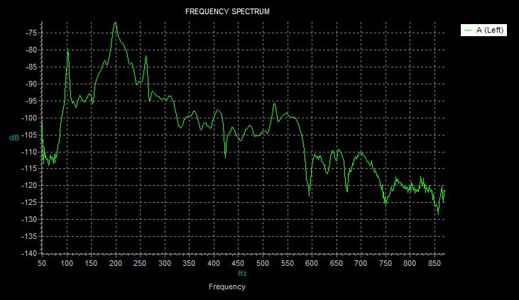

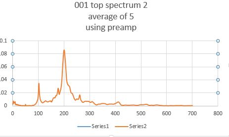

Well even after all this time I am still getting tripped up by Visual analyser.
Apologies if this is obvious to everyone else but...
I have been getting good consistent results for the main peaks in terms of frequency but virtually no info on the other expected resonances. See second figure. Reading the threads I suddenly latched on to Trevor's remark about log scales and I realised I had not set the y scale to log. So see the first pic - it is a one off so a bit noisy but shows much more information on the other resonances.
Hope this is useful to others starting out with this apparently straightforward but in practice somewhat tricky area.
