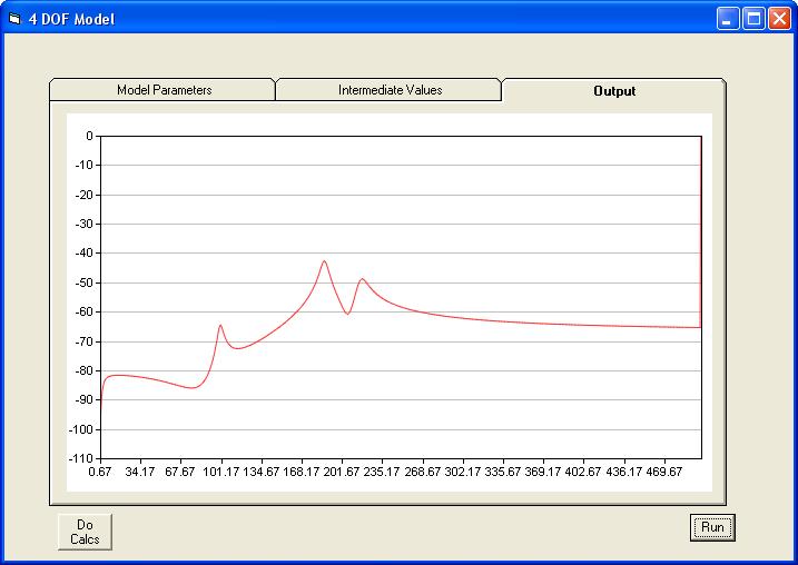

Well, I cracked it with Excel after checking the calcs several (dozen!) times over and not finding anything wrong. I decided to try a different approach and wrote an app to do it. Eureka, worked first up. I still have to sort out a few issues with the plot output format but the shape and amplitude match Trevor's book.
Dom, I've compared the values obtained with Excel and they're all over the place. I'm assuming that there is something about the way that Excel handles the complex arithmetic. I've attached a screen grab of the plot and also of the intermediate values for an input frequency of 100Hz in case you want to chase the Excel solution.
Os

Post by Trevor Gore » Mon Oct 08, 2012 12:54 am
Well done, John! You deserve a medal for perseverance!
Your plot looks pretty close now, but the first peak is about 10 dB down compared to what I got, but the overall shape and the other peak heights are about the same. Given what we're finding out, it's hard to say which is the more accurate.
Tell you what, it's pretty scary how Excel can screw things up, given that half the world's finances are run on it, and I bet few people know that you only get the right answers some of the time.
For the record, what machine/operating system/Excel version were you using? (I'm using a Toshiba Tecra M5 with Windows XP, and Office Pro 2002) and what did you write the app in?

Post by johnosb » Mon Oct 08, 2012 9:48 am
trevtheshed wrote: Your plot looks pretty close now, but the first peak is about 10 dB down compared to what I got, but the overall shape and the other peak heights are about the same. Given what we're finding out, it's hard to say which is the more accurate.
A lot of the calc results are stored in textboxes which I formatted to 2 significant digits, I used those rather than store the results as variables. That's maybe the reason for the slight differences
trevtheshed wrote: Tell you what, it's pretty scary how Excel can screw things up, given that half the world's finances are run on it, and I bet few people know that you only get the right answers some of the time.
You're not wrong. I found that if I calculated (some but not all) terms differently I got different results even though the methods were mathematically the same. You put me on to this when you suggested expanding some of the Dbar terms. I found that the solution to:
-a(BC-D) was different to -abcd + ad and when the terms were evaluated I got different results for subtracting a term or adding a negative term (TermA - TermB compared to TermA + (-TermB)). All very confusing.
