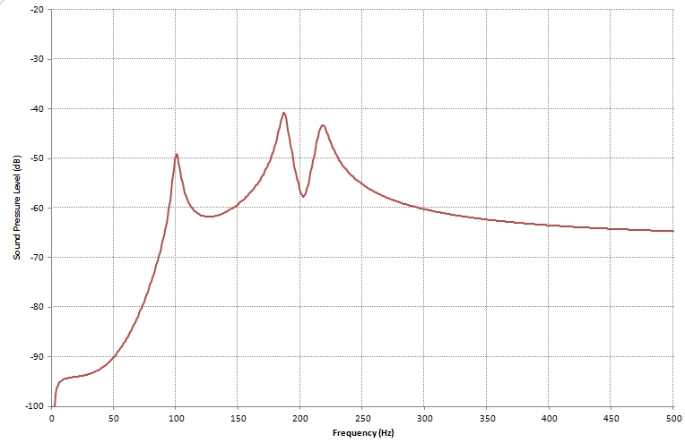

Post by Steve » Thu Dec 27, 2012 2:37 pm
trevtheshed wrote:Jim, I think both John and Dom have been through the derivations (they will correct me if I'm wrong!) and I think they got what's in the book. John has also managed to get pretty similar charts to mine, here: viewtopic.php?f=33&t=4636&start=50#p55463, so at this point I'd say have another look and see if there's an error in your workings. A Matlab solution will certainly be good to have, as Excel is pretty flaky on this stuff, so I'm looking forward to seeing what you have, when you're ready.
I was working through this stuff yesterday too (up to the point of the y's - haven't moved to the next phase yet). I used Excel (both 2003 & 2007 - both got the same answers), and came up with exactly the same solutions (including Dbar) that John reported in the screenshot at the bottom of his post here: viewtopic.php?f=33&t=4636&start=25#p54820. The only big difference that I've spotted between his excel & VB solution was the ya value. I've re-worked that calc about a dozen times & keep arriving at the same answer (excel version). For what it's worth, all of my calculations have been single, nested functions - I was getting the same answers when they were split up.
Somehow we're all misinterpreting your equations (or making the same mistakes) to come up with the same, incorrect answers. The bit that's really doing my head in is that John's final VB version came up with radically different values to your 100Hz intermediates (viewtopic.php?f=33&t=4636&start=25#p54844), but then arrive at the same/similar graph! Do you have any thoughts that you could offer on this? I haven't used VB in a few years, but perhaps it's the only way forward?
Thanks,
Trevor Gore
Posts: 1639
Re: 4 DOF Model
Post by Trevor Gore » Fri Dec 28, 2012 10:00 am
Steve wrote:Somehow we're all misinterpreting your equations (or making the same mistakes) to come up with the same, incorrect answers. The bit that's really doing my head in is that John's final VB version came up with radically different values to your 100Hz intermediates (viewtopic.php?f=33&t=4636&start=25#p54844), but then arrive at the same/similar graph! Do you have any thoughts that you could offer on this?
I have nothing more to offer at the moment, sorry. All I can tell you is that the Excel solutions are pretty flaky and that I'm hanging out for Jim's Matlab solution, as that is likely to be the most robust to date and should cast a lot of light on where/how our solutions are diverging.
Posts: 165
Location: Coffs Harbour, NSW
Re: 4 DOF Model
Post by Steve » Fri Dec 28, 2012 10:46 am
trevtheshed wrote:I have nothing more to offer at the moment, sorry. All I can tell you is that the Excel solutions are pretty flaky and that I'm hanging out for Jim's Matlab solution, as that is likely to be the most robust to date and should cast a lot of light on where/how our solutions are diverging.
Bummer. I'll keep plugging away then.

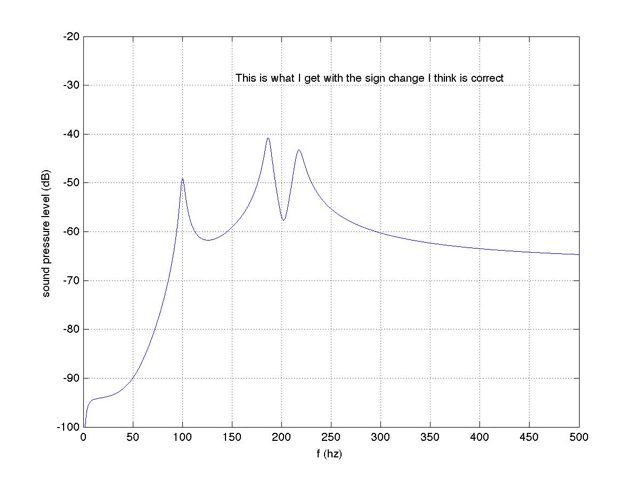

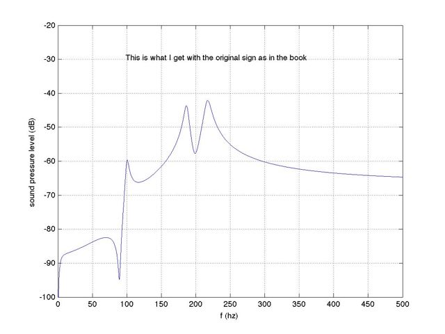

OK, here is what I get. First, two pictures. The first is the book example with the sign change I claimed above needs to be made. The second is what I get without the sign change (i.e., using the formula as given in the book.)
"correct?" version
original version

To summarize, in hopes that someone is checking the math too:
It's not the programming, it's that, if Equ. AII 2-38 is correct (which I think it is), then Equ. AII 2-43 and it's corresponding copy in the main text is wrong. And I suspect the error is purely a typo in the text rather than something that has been incorporated in Trevor's code, which I suspect is correct as it gets the proper form for the main air peak. (Trevor please check your code).
I feel bad causing such a ruckus within my first 10 posts on the forum.

Jim Kirby wrote:To summarize, in hopes that someone is checking the math too:
Jim, I'm a bit rusty on matrices so haven't been able to check the derivations that you have been looking at. What I have done is complete my workings in Excel. My results appear to be the same as your matlab outputs (including your modified AII 2-38)...
...& your modified version of AII 2-43
Like I said, I haven't checked the equation derivations, but your change certainly produces a closer match to Fig 2.4-4, apart from the differences in the 0-100 Hz range.

Jim Kirby wrote:As for the math, the Wikipedia article on determinants is enough to go by. (I admittedly checked myself).
I had a go at this & have to agree with you that I'm getting a positive value for the first term in in Equ AII 2-43 (ie., F(+Kt.Kb.alphaab +...). My solutions for AII 2-40 & 2-41 were the same as documented in the book, but I'm getting a different answer for AII 2-42 - for the final term on the top line, I'm getting Ds.alphaab^2, rather than Ds.alphaab.alphaat. Given my skill level in the area of matrices I'm happy to be corrected. For what it's worth, I changed my calcs for yb to see if it made a difference, but alas the numbers are similar enough that the output graphs looked exactly the same, so right or wrong, it's not going to make a difference.

Post by Jim Kirby » Sat Dec 29, 2012 11:55 pm
Steve,
Ah-ha, you found another typo in AII 2-37. That lower left element in the 4 by 4 should always be alpha_at except in y_t, where that is the column that is replaced. With a proper alpha_at in AII 2-37, AII 2-42 is correct.

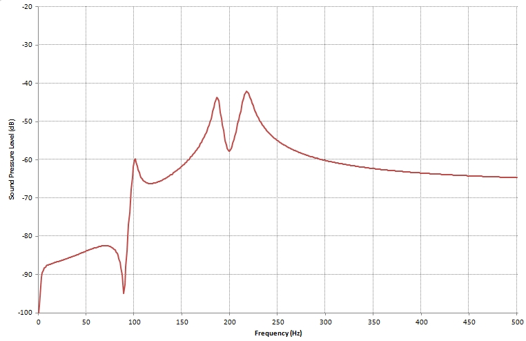

Dom,
I'm curious about the mismatch in the air resonance peak after my change as well, given that the rest of the plot is really close to Trevor's. I want to spend some time checking on what parameters that peak is sensitive to - maybe something that isn't all that well constrained? (i.e., can I regain the fit to the experimental data by reasonable adjustments of material properties?) Is the spectral analysis of the experimental data subject to comparable computational uncertainties itself? (I think Trevor uses VA usually? I have no idea what the guts of VA's computational engine is based on.)
But right now, I'm too busy keeping certain parts of the world's infrastructure safe from tsunamis (or at least telling them in advance how deep a pile they are in if anything happens).
