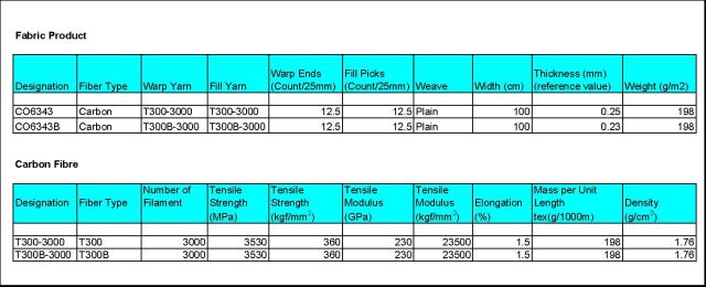

I've had some more enquiries about the specification of the carbon fibre that I use and after a lengthy search I managed to get the following information from the Toray website. I can't get a link to work directly to the correct page, however this:
http://www.torayca.com/en/index.html
gets you close. From here, look for the "Product lineup" panel on the right and hit "more details" under "Torayca Fabrics" and it will take you to a table of cloth specs. The product I am using is either the CO6343 or the CO6343B. I don't know what the difference is between these two, other than the B designation of the yarn. It may contain a binder (???)
You can get the material properties of the fibre by hitting "more details" under "Torayca Carbon Fiber" again, in the panel on the right.
The fibre is 3k tow, 198 gram/1000m, which is what it says in the book.
Here is a summary table of the products:
Now you should be able to source something similar wherever you live. The strands that I use for overlaying braces are just yarns (which contain 3000 fibres) pulled from the woven cloth.
