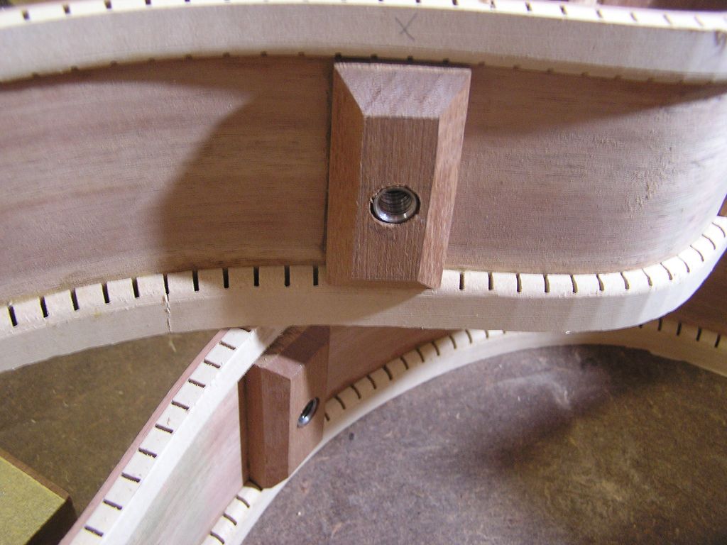

One critical thing in execution, however, is that the masses are intimately attached to the sides. i.e. when you bolt the side masses in, seriously tighten the bolts. If you have issues in execution, the masses not moving with the sides is the most likely cause. Also be aware that the bolts can "ease" over time as the wood creeps a little, but is easily fixed by re-tightening them.

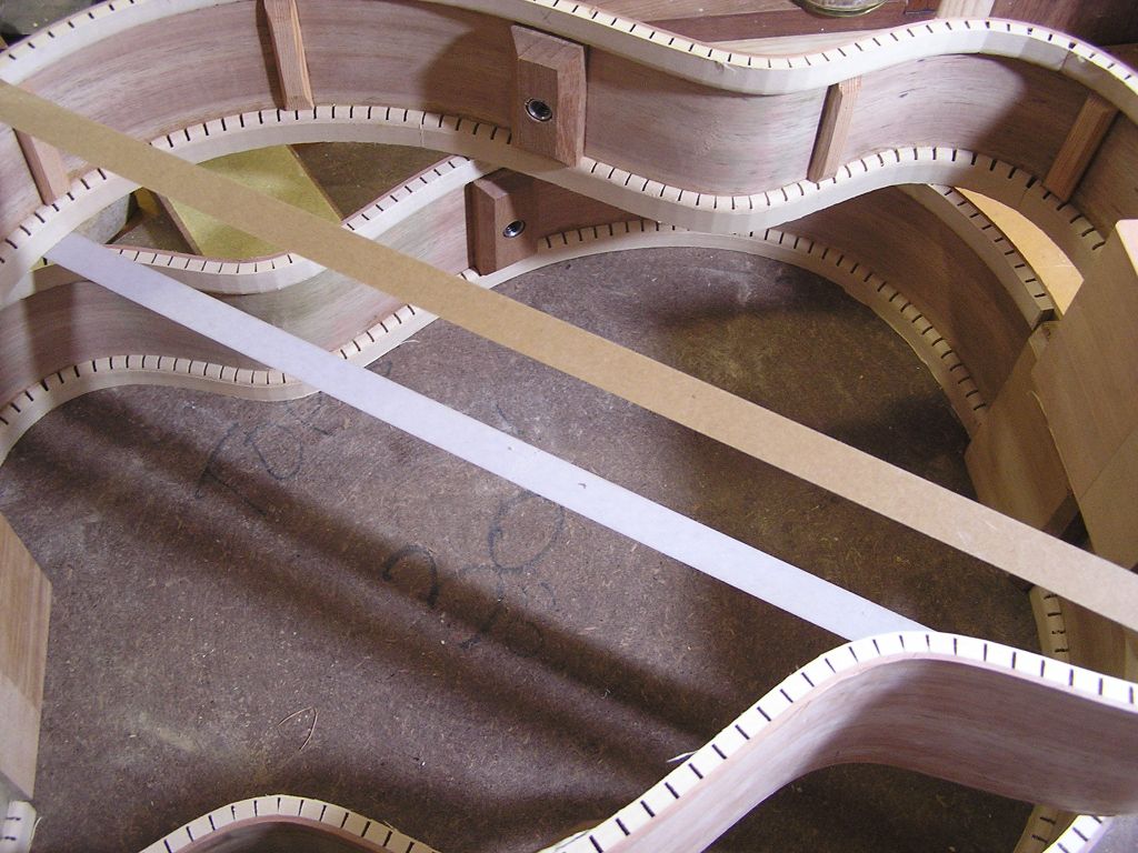

I love the concept of being able to trim the frequency of the top by adding mass. I have incorporated the mass attachment points into my latest two builds. I am loving the books...I am all over the place in my reading though as there are so many goodies in there. I look forward with interest to seeing the results of this concept in action.
Ps...My guitars are not always held together with tape!

Will moving the side mass blocks to the waists change or be a waste of the effort,, or will be rendered useless?
Seems like they are designed to oppose the bridge placement
Re: Mass Loading Sides
See the Build Volume, page 2-30 for further reading on this.
I meant to say the DESIGN Volume, page 2-30 for further reading on this.
I’ll have to read it again, though Since I don’t remember if the book states, “no!, don’t put the block in waist,””, is why I was asking. I know it places them each side of bridge, so I’ll bet they are for loading mass near bridge and ineffective in waist area.
I have a reason I want to do this on just this one guitar which I won’t disclose, but you might be able to guess,,
