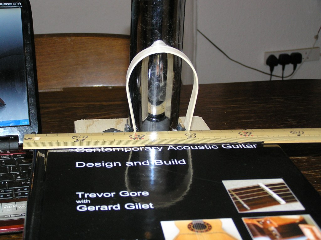

I like the sound of a former and dowels with the "rubber band" - I'll probably back up the laminations with flexible steel banding (Pallet banding stuff).

I use titebond to glue the laminations , But a Trevor Pointed out It does make them Curl a bit because it' water based, and then I have to Tidy the Sides up un the Drum samder, So In future I'll try some Techniglue , You should be able to Find something Similar, try a Marine suppliers . It's best Described as Gel Like, and Does not Run everywhere one part is a Honey Colour the other looks a little Like vaseline ..

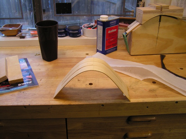

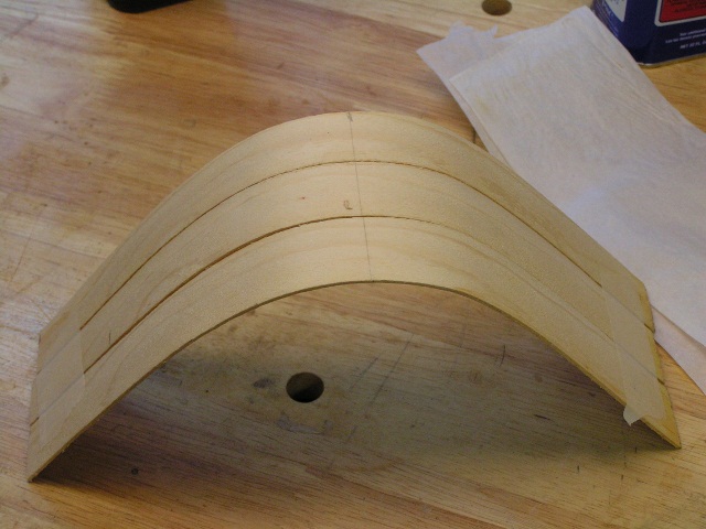

adirondack spruce ..bent at 300 degrees...sprayed with supersoft ..
my first shot at falcate bracing!!!

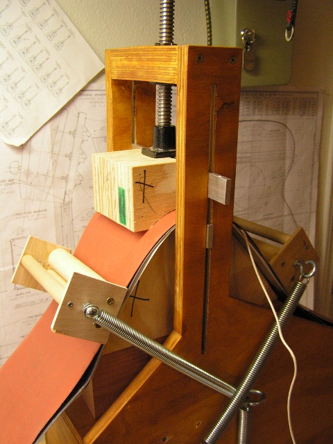

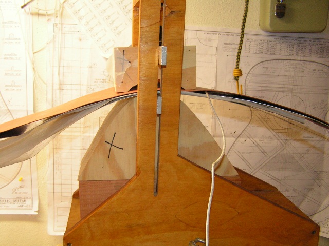

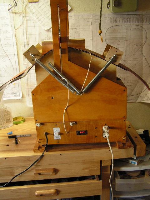

Hi Wes, Thanks for Posting yr pics...I will make a form for my bending machine now and use my electric blanket just like sides.
Best of luck with your falcate...I just finished my first a couple of weeks ago and was glad that I grasped the nettle and got over my fear of the whole CF thing. The guitar is definitely noticeably louder than my x braced ones and that is with all things being equal like string height and top at 180Hz. It is definitely the way of the future for my steel stringers....

I think I have said this before but for the tightly bent secondaries in Sitka I use 4 thinner laminations rather than 3, bent over a hot pipe. Still get some failuires but mostly that works.
West system epoxy with some filler to increase viscosity gives a nice relaxed time to clamp up.
