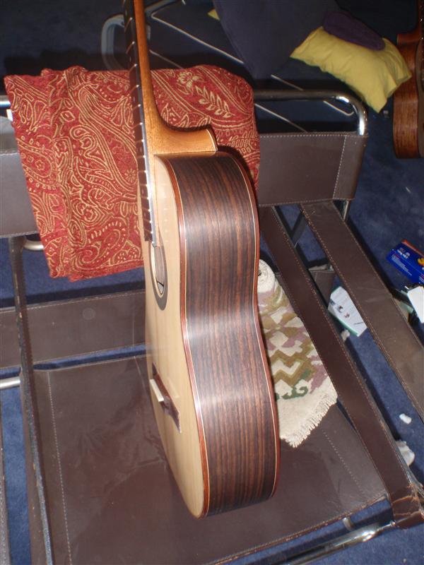

This the best pic I have at the moment and both guitars are away from home at the moment. Its a bit hard to see it here. I let it touch the top above the neck block then just tapper it a bit so it rides above it for most of its length. this pic is during setup so I'm still tweaking things. I made 2 like this and I liked how they came out.
The neck on most of my guitars has a steel truss rod under most of it but not under the neck extension. (These classicals have light weight aluminium truss rods). I wondered about adding some steel or brass mass under the fretboard around the extension to try to even it up the sound a bit. Obviously more important on cutaways. This would be simple to set a decent thickness plate into the extension, then I can concentrate on the neck adjuster mechanism and not compromise sound. Any thoughts?
BTW, My archtop based on Bob B design has a pretty thick extension, and its square so its bigger than the neck down at the nut so I'd have to say there is nothing wrong with that design. But any neck joint where the fretboard is glued to an unsupported top with a few braces across it would suffer which is most Martin style designs.

That looks pretty neat, Dom. To my eye, it looks like it might be a bit floppy by the time you get to the 19th. Have you got it strung yet? You'll know straight away if you have a problem.
If you do, it'll be a case of going "millennium" on the next build, or cutting a pocket into the upper bout so you can get more thickness of neck wood beneath the high frets.

Thanks Trevor, I have strung it and its brother up. I made a narra one for myself and this one for Julie. They both came out really nice but Julie's is better sounding.
Anyway, do you think it is stiffness that we want in the tongue, so a light but very stiff tongue - thinking carbon fibre, or is it having mass that matters most so a steel plate? Or both. I am thinking about violins which have a curved fretboard tongue so it is stiff but it still hangs out there without support and doesn't seem to bother the purists.
I just don't like the idea of cutting a hole in the top of the guitar with an adjustable neck and I do like the raised tongue, I just want to make it work on a deep cutaway.

What you want is low admittance in the tongue (so the wave in the string is reflected back). However, if it plays well and you can't hear a difference above 12, why change it?
