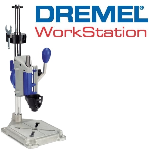

Post by charangohabsburg » Wed Apr 03, 2013 12:07 pm
P Bill wrote:A lot depends on the quality of the drill press as well. [...]
Will this one be OK? :D
Ultimate drill press in conjunction with mortiser attachment!
Re: mortiser or drill press mortise attachment
Post by kiwigeo » Wed Apr 03, 2013 4:11 pm
Yeah that'd be fine....for working on watches.
Post by charangohabsburg » Wed Apr 03, 2013 11:59 pm
Glad you did not say "Swiss watches". :lol:
