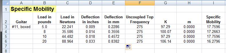

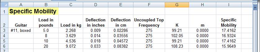

Okay, I'm going to assume then that my calculation is basically right. Being metric, the zero count will depend on whether one uses Newtons, Kg, mm or Meters. From here out, I just need to be consistent. As the graph in Figures 1-7.8 and 1-7.9 uses a scale of 0-30 on the Y axis, I'll use what gives me a similar order of magnitude. As Kg is in the units, I'll use Kg for the load and centimeters for the deflection.
I tightened up my measurements a bit. In my deflection method of old, I used weights from 5 pounds to 20 pounds (2000 to 9000 grams) and measured deflection in thousandths of inches. I have lots of records like this from my own guitars and known good examples, so I am hopeful my measurements will correlate with the much lighter loads (400 - 1500 grams) used in the book.
I put load and deflection numbers for one guitar, just a body at this point, into Excel and here are the results. I'm happy to see the Specific Mobility numbers are reasonably close for the various loads. Hopefully, this suggest some degree of accuracy and consistency across the various loads.

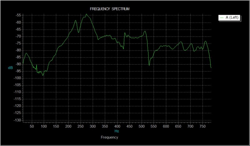

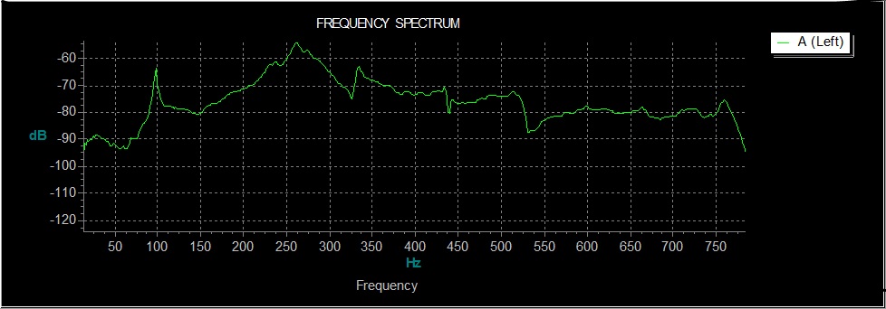

As a separate issue, I'm surprised by the measured uncoupled top frequency which I take to be 278hz. This is the highest peak on the FRC (below), but note there is a second, lower peak just before it at 232hz. From the book, I had expected the uncoupled top main to be lower than the coupled top main (258hz), but this isn't what I got (maybe I read the book wrong, I can't find the reference now). In this case, it actually went up.
Maybe something wrong in my testing? (plugged hole with a 16mm thick styrofoam plug, nice tight fit to sound hole). Anyhow, FRC curves of coupled and uncoupled top below, comments appreciated.
BTW, the high main monopole frequency seems to characteristic of this Selmer style guitar. Part of why I'm being finicky about all this is because these guitars do seem different so while the principals in the book apply, the numbers I'm getting are different.

On second thought, maybe better to use Newtons and mm:
Thanks for everyone's help on this!

I wonder if that double peak on the uncoupled top frequency is abnormal? It looks like a remnant of the double peak is also present on the coupled top curve.

To work through my calculation of mobility again, I'm thinking these are the elements:
Data: Measured DEFLECTION in mm, under a measured LOAD in Newtons. Uncoupled top MAIN RESONANCE FREQUENCY (f), in hertz. I'm pretty confident about the deflection and load, at least at the higher loads I use, as I have done them many times and results have been very consistent. My loads are applied w/ barbell weights which might be off a little bit, but not much (I just weighed one, it is 23 grams short of the 5lbs (2268 grams) it is labeled as). The uncoupled top main is just what I read off the FRC in VA, tapping an unstrung body with a plugged sound hole and I have little experience with this, so I could easily being doing something wrong here, especially as my main top resonances seem so much higher than other guitars. I did an FRC on a decent dreadnaught guitar, however, and it was right in the ball park with the book for dreads, suggesting my FRC setup is okay.
Calculations, based on the book, in Excel formula format:
Thanks for your patience and help, I'm not at all fluent with the physics and mathematics of your book, but I do find it very interesting and much of it make a great deal of sense to me in a general way.
I would guess my tops to be a bit lighter than a flat-top SS guitar, based not on actual measurement of FT-SS guitars, but on supposition (danger, danger). Mine have considerably less bracing, both in number and dimension, and often a cedar top that is not much thicker than what I commonly see on FT-SS guitars. No bridge patch and a bridge that typically weighs in at < 12 grams. That said, I have no idea what the range for top weight is for guitars other than my own. Much of the Selmer stiffness comes from the considerable arch both in the long and cross directions. The arch is ~10mm measured at the outer edges of the top with a straight edge resting on the bridge area, ~ 7 foot radius if you think that way. I suppose this contributes substantially to stiffness without adding mass. I will say Selmer guitars are loud compared to most guitars and this is one of their primary desirable characteristics as they were developed in the 1930s and 40s to play acoustically, both rhythm and solo in jazz ensembles of 4-5 players, often in crowded, noisy rooms.
- Specific Mobility = 1/(SQRT(K*m))
- K = LOAD/DEFLECTION
- m = K/((2*3.1416*f)^2), where f is the uncoupled main resonance of the top by way of recorded tappings in VA.

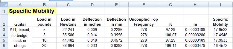

I see in my last Excel screen shot, the formatting of the column for m was only to 4 places. It still calculates correctly, but looks better when formatted to 8 places.

I've got my time cut out for me over the next few days, Craig, but I'll run your numbers through my program later and see what I get. Your mass numbers look very small compared to mine. You might want to check your zero count there. If I'm reading this right, your numbers are suggesting 3.2milligrams (!) as the effective mass of the top (column H), if your units are kilograms.
- Posts: 1643
Re: Equation 1.7-1
I've just run your data through my program and get much the same answer as you, Craig. So it seems that the Selmer guitars do have a very low effective mass! Your intermediate numbers look odd, though!
Re: Equation 1.7-1
It looks like K has been calculated in N/mm (instead of N/m) which in turn has modified m, which looks like it may have given a result in s/kg x 10-3 to line up with the units in the graph?trevtheshed wrote:I've just run your data through my program and get much the same answer as you, Craig. So it seems that the Selmer guitars do have a very low effective mass! Your intermediate numbers look odd, though!

Yes, that's right. In order to get the zero count right compared to the graph, I used Newtons and millimeters for load and deflection.Steve wrote:It looks like K has been calculated in N/mm (instead of N/m) which in turn has modified m, which looks like it may have given a result in s/kg x 10-3 to line up with the units in the graph?
Trevor, thanks for running my numbers through your program and checking my calculations. I'm still skeptical about the data I'm imputing, but can fine tune that as time goes along. For establishing K for instance, I notice that no matter how solidly I chock the guitar, there is 2-3 thousandths of play before applying load. Can't feel it, but if I push down on the edge of the guitar, the dial indicators register, which of course they should not. Some small amount of this may be flex in the sides but at least some of it is back lash in the chocking. This wasn't to important to me in past deflection measurements as I wasn't using them for anything other than comparison against similar measurements on other guitars and if all the measurements are overstated by .002", it really didn't matter, especially when I was looking at deflections in the .038" range. But .002" makes a considerable difference in SM, especially if the load and deflection to calculate K are small. I need to cook up a better (and faster) means of chocking and measuring for K.
Also, still not sure how valid that 278hz uncoupled top main really is. This is without bridge, neck and strings. That double peak bothers me too. I'll report back once I get it string up in a week or two. I ran the FRCs on an older guitar of mine last night, with bridge, strung up, well played in. It is a Selmer style as well, but more heavily built than what I build now. The uncoupled top main came in at 230hz, the coupled top at 240hz and the uncoupled back at 230hz as well which seems rather suspicious. Deflection with 5 lbs. was .007", so running this through the spreadsheet gives a SM of 11.5. If SM relates to volume as I understand from the book, the lower SM is not too surprising as this guitar has good tone but is not as loud as what I build now.

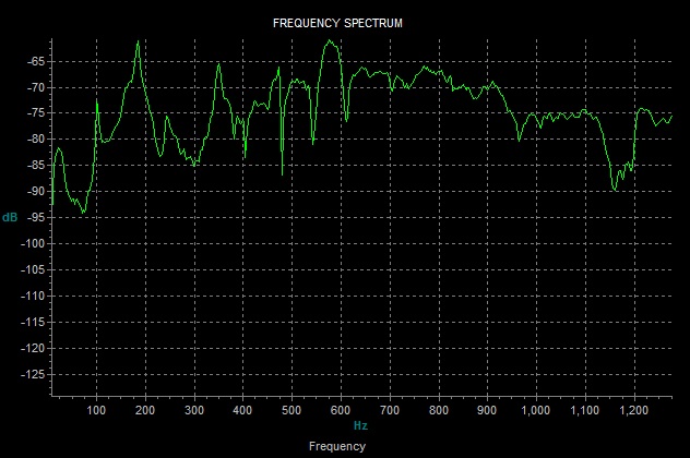

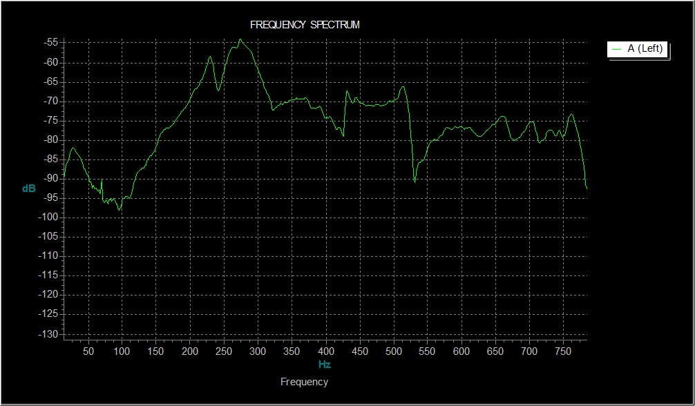

Sorry to be a pest, but I've got a couple questions about MM and target monopole peak resonance frequency. If I may.....
What is the basis for target monopole peak resonance frequencies? Good examples? From what I understand, which, granted, isn't much, the higher the frequency, the higher the stiffness or the lower the (effective) mass. If deflection under load is already pretty high, then a higher frequency must mean lower effective mass and a high MM. Correct? And if so, why isn't a higher frequency (assuming no scale note conflicts) always a good thing. In reading the book, the effort seems to usually be to get the frequency down, not up.

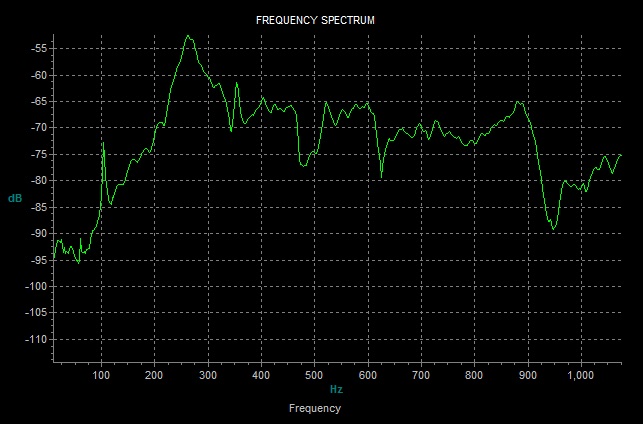

The Selmer style guitar I just boxed looks like this (no bridge, neck, etc.):
IF....., that is, I assume the uncoupled top monopole freq. is 258Hz. But look, if you will, at this graph.
How would you interpret the double peak? Which would you use in the MM calculation? I get these double peaks a lot. I'm guessing peak means the highest in amplitude, 258Hz.
Aside.... Any idea what is going on at 440Hz - 520Hz?
BTW, my 400mm x 470mm thicknessed cedar top (3.3mm) and profiled top weighed 158 grams before bracing and the braces below the sound hole in total weighed in at 35 grams.
Thanks,

I think Craig that getting the frequency down is because it is a bit easier than up, so you have a target to aim at, you build a bit above then once you have strung up you drop things a little to exactly where you want them. You have to decide on which frequency you want for the air or top etc. You may choose say 151Hz for air and 226Hz for the top, you then aim a bit higher in the build and drop it post build unless you can build it bang on your choice without adjustment.Craig Bumgarner wrote: In reading the book, the effort seems to usually be to get the frequency down, not up.
From what I understand you will have to Chladni test to be sure of those peeks unless you know them well enough to guess and I reckon all the tea leaves would just keep falling of that pliadge end of your style of guitar, might make things difficult. Good luck.Craig Bumgarner wrote:Aside.... Any idea what is going on at 440Hz - 520Hz?
- Posts: 1643
Re: Equation 1.7-1
Yes. Good examples for flat tops in specific sizes. Check out Table 22-1.Craig Bumgarner wrote:What is the basis for target monopole peak resonance frequencies? Good examples?
Yes, if you have a higher frequency for the same stiffness.Craig Bumgarner wrote:If deflection under load is already pretty high, then a higher frequency must mean lower effective mass and a high MM. Correct?
Because, generally, you still want the guitar to sound "in genre" for the type, which means hitting specific modal resonances. If you don't mind a Dreadnought sounding like a Parlour you can do it differently, of course. If you pitch the main resonances higher it's like turning the tone control to treble. You gain treble and loose bass.Craig Bumgarner wrote: why isn't a higher frequency (assuming no scale note conflicts) always a good thing.
It's much easier to drop frequencies than raise them. Hence building a little stiff then dropping stiffness or adding mass to achieve target.Craig Bumgarner wrote: In reading the book, the effort seems to usually be to get the frequency down, not up.
I'm guessing, but two possibilities come to mind:Craig Bumgarner wrote:But look, if you will, at this graph...
1) The split peak is something to do with the back. On flat-tops, when the sound hole is plugged, the strength of the coupling of the back to the top via the air is similar in strength but opposite in phase to the coupling via the sides and so they cancel. Therefore when you look at the spectral response of a top tap, you see only one peak - that of the uncoupled top. This relationship, which is just fortuitous for flat tops, may not happen with Selmer style guitars, so you see a residual back peak, which means the top is not uncoupled from the back so you get a "peculiar" result for the top frequency which will knock-on into the mobility result.
2) Because of the pliage in the top, you may have a long dipole very close in frequency to the main monopole. I can't see these two modes being strongly coupled, which is good, because if this is the case, when you figure which is the monopole you should still get a good number for mobility.
So you'll have to figure out which modes the peaks represent, which should be a bit of fun with Chladni patterns unless you have a handy holographic interferometry facility you can bludge!

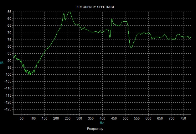

I've been thinking about this overnight and figured if the stiffness is about where I want it, then mass is the next major thing I have to play with. This morning, I added 71 grams to the bridge area with magnets. This dropped the un-coupled top from 258 to 180Hz. The weight was chosen at random, and obviously quiet a lot, ~ 30% of the total braced top, but wanted to exaggerate to see what would happen. Pretty dramatic change, at least on the graphs. Plugging 180Hz in the MM calculation reduces MM to 16.7. (all this in on a closed body, no bindings, no bridge, no neck, no finish).
I also noticed that the coupled top FRC has more peaks with similar amplitude, albeit less amplitude, as opposed to what I see without weights. I'll be interested to repeat this once the guitar is finished to see what difference I can hear.
