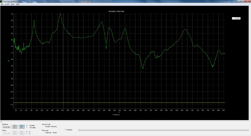

I have this graph and would like to know exactly what those three peaks beyond the main top mode are. They occur at 351Hz, 379Hz and 441Hz respectively. Then there is one more at 674Hz.

Those three peaks are likely the cross dipole, long dipole and maybe the first partial of the long air, possibly in that order. The big peak up at ~675 is possibly the cross tri-pole, but there's only one way to be really sure.

Oh and if that one is the cross tri-pole how do I go about getting it down on the next guitar, maybe lower the CF in the bridge? Hmm or thinner edges of the sound board?

On my SS guitars the cross tri comes in at 500-550Hz.

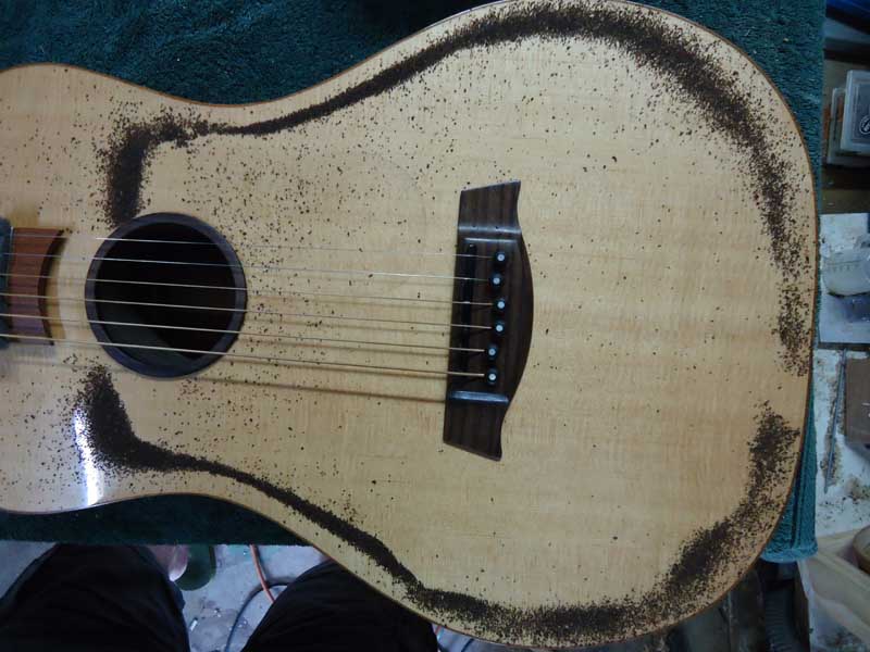

Today I learned two things, the first was a good thing as it seems at least I am making good use of the sound board for a 14 fret to body guitar. The second thing I learned not long after the first thing was that speakers are not supposed to have mini built in smoke machines (seems a infinite baffle and I might not need to turn it up so much)

Nice monopole...

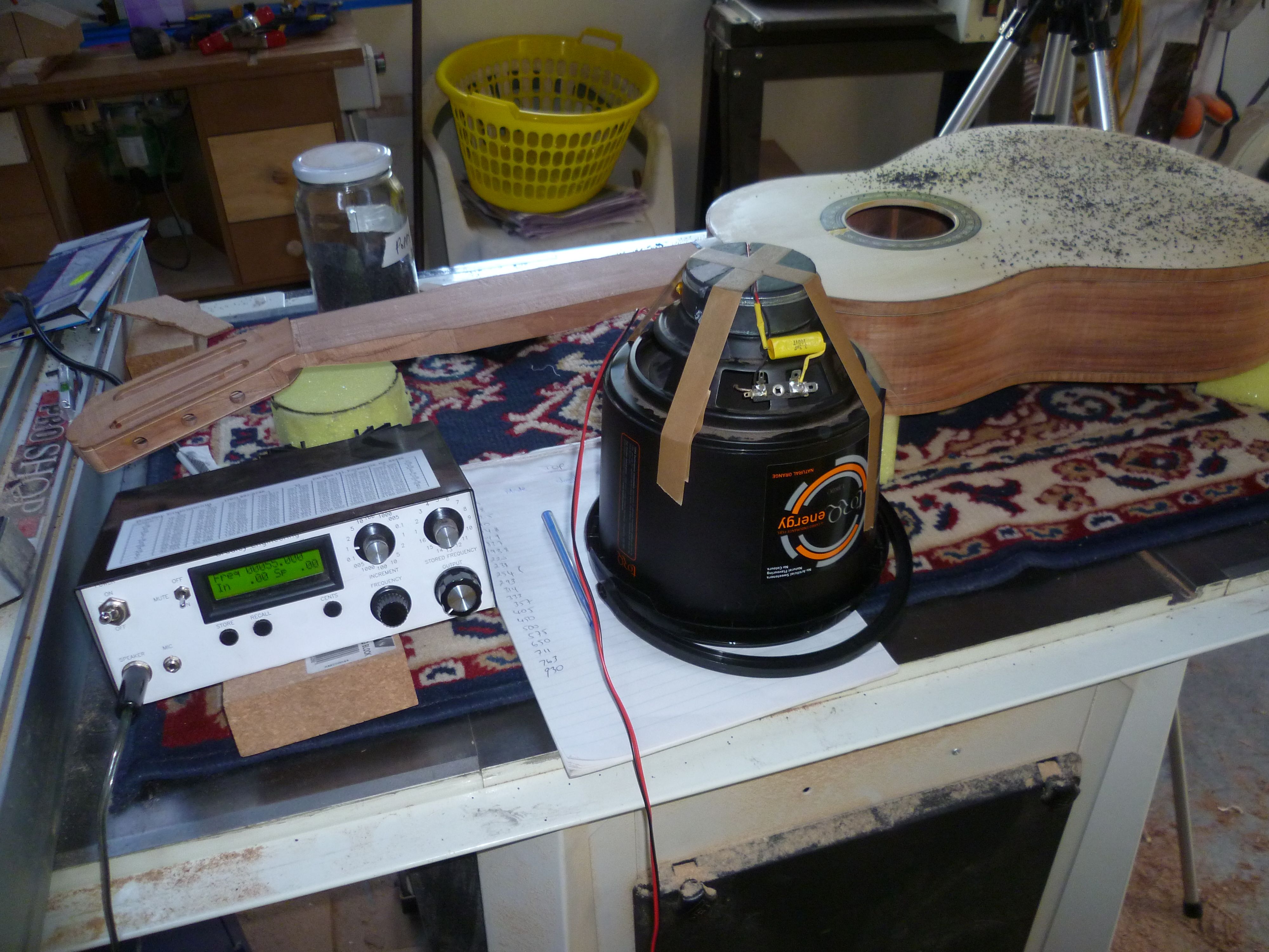

Heres my Chladni set up. Its a Bradley 50watt signal generator and a 6" 50watt speaker I got from Jaycar.

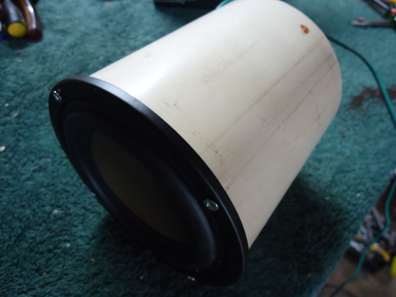

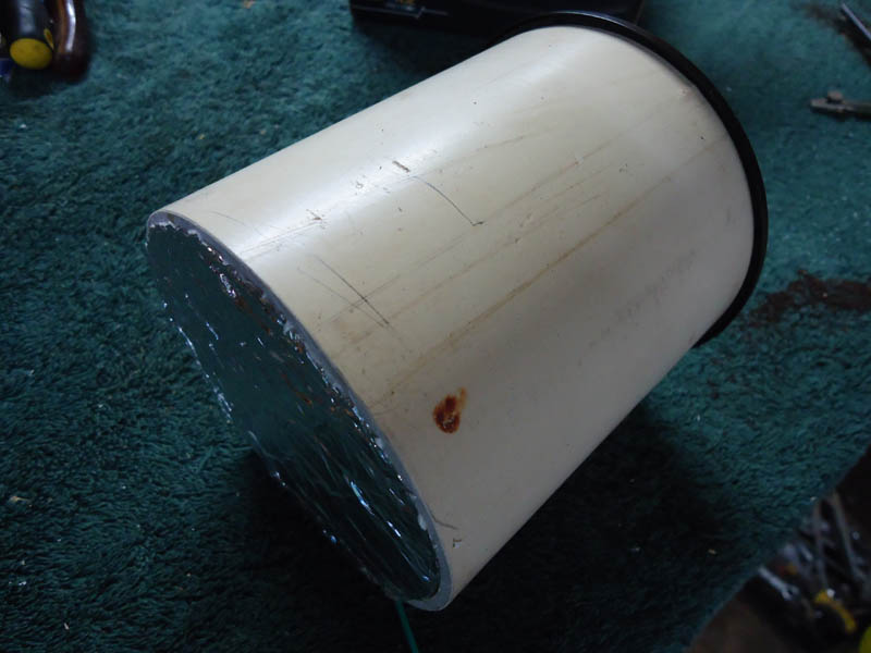

I didn't think of that way to solve the phase cancellation problem of the un-housed speaker(I tried to solve it by turning it up, 50w speaker + 65w amp = smoke machine) but it looks like a good way of doing it to direct the sound. In the end I bought a new $15 50w 4 inch and shoved it in PVC pipe with a bit of foam and a polystyrene plug in the back( I got the plug from Stu, If you need any polystyrene just buy one of his lino prints and he will pack it in some handy material you can add to your pile of useful junk)
I tested it and it is plenty loud now with out much volume from the amp then I put it all down, opened a beer and started reading that black book again to try to work out how to get that cross tri-pole in a better place.

BUGGA! I got the cross dipole which was the 351Hz peak but then burnt another speaker so I am not sure of the rest and have given up. Will just move on to the next guitar and try again when that one is complete. Maybe I will buy a cheap 15 or 20w amp for next time.

Hmmm. I've never had a problem burning out speakers and getting decent patterns. My amp is 15 watts RMS. Maybe check that your speakers are rated RMS rather than "music power" or some equivalent marketing term. Another tip is to hold the speaker over where you think an antinode is going to be (which is the advantage of a smaller speaker) so that you are not trying to excite poles of opposite phase with the one phase of excitation.
