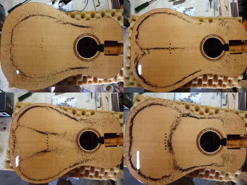

The top is supported with pyramidal foam blocks , a la Al Carruth and i try to put the tip of these under the node lines.
I cut the blocks from an acoustic foam panel like this one: http://www.thomann.de/gb/the_takustik_s ... schaum.htm.

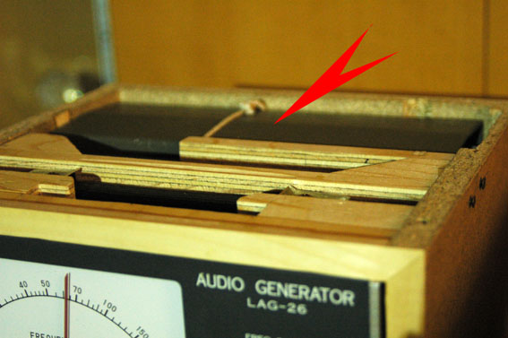

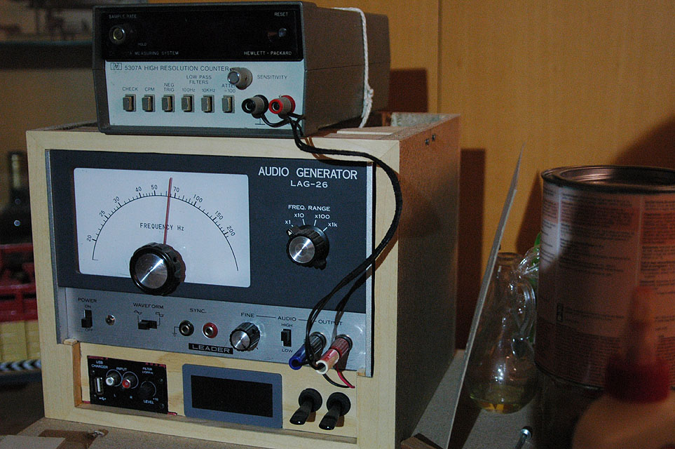

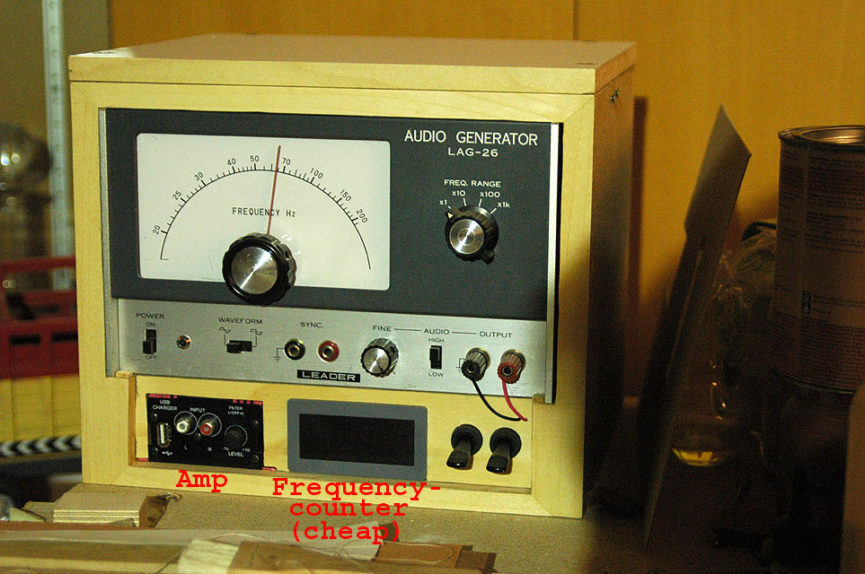

I have a very similar tone generator (also 600 Ohm output impedance) and combine it with a frequency counter:
I (sometimes) use this inexpensive (about 10$ IIRC) frequency counter, but it is quite quirky because when changing the frequency on the tone generator dial it will display most of the time between 0.5 and 1.5 off, but when I switch the FC off and on again it always is spot on.
How do I know it is off? Well, I also bought another FC with which I can compare. It is a tiny bit of overkill, but I got it for a reasonable price (there are also new, Chinese ones around for about 100$ I think).
Hidden in the box behind the TG:
... and connected:
It is much nicer to work with the big frequency counter connected, but the inexpensive one does also a fairly good job.

For me recording a tap tone is easier and much quicker than setting up the whole Chladni pattern thing. I only use Chladni patterns when I am in doubt which peak is which. The two methods complement each other.
Here's a link to an eBay offer of the frequency counter I've built in. I recommend to combine it with a toggle switch in order to get accurate readings (see my former post).
