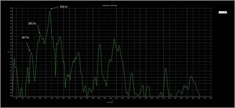

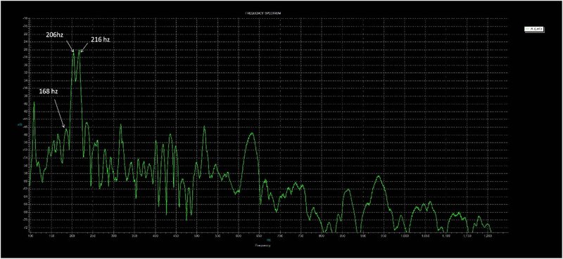

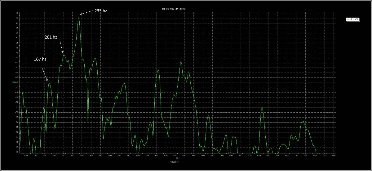

Hello all,
A real quick introduction: For starters I'm familiar with many of you at the OLF and some of you may be familiar with me as well. But for the many who aren't I've been building for about 20 years and study as much as I can. I have a very low output of a few instruments each year. I enjoy this and have a day job also. I recently purchased Trevor's fine set of books and am trying to absorb all I can through them. There's a lot there! Anyway enough of that and onto the subject at hand.
Below are three spectrograms of three different guitars. The first two are hybrid dual fan bracing a la Byers and the last one is a 9 fan Fleta using Coutnals plan. My question revolves around this peak at 168-ish Hz. It's there on all three and I'm not sure what it could be. At first I thought it was my tapping hammer (eraser on a stick), so I changed to a finger, still there; a pencil, still there; a different room, still there. It really surprises me it on all three guitars.
I used a Zoom H4 as the microphone. Any thoughts would be greatly appreciated.
I'm happy to answer any questions.
Dual Fan
Dual Fan
Fleta
Dual Fan
Dual Fan
Fleta

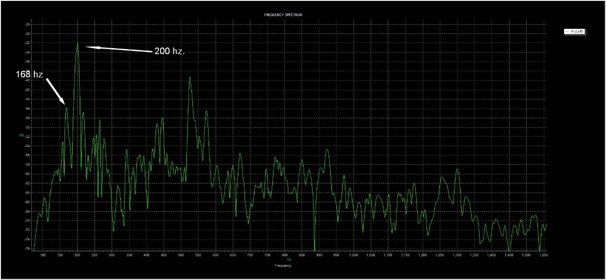

Re: peculiar 168 hz in tap response

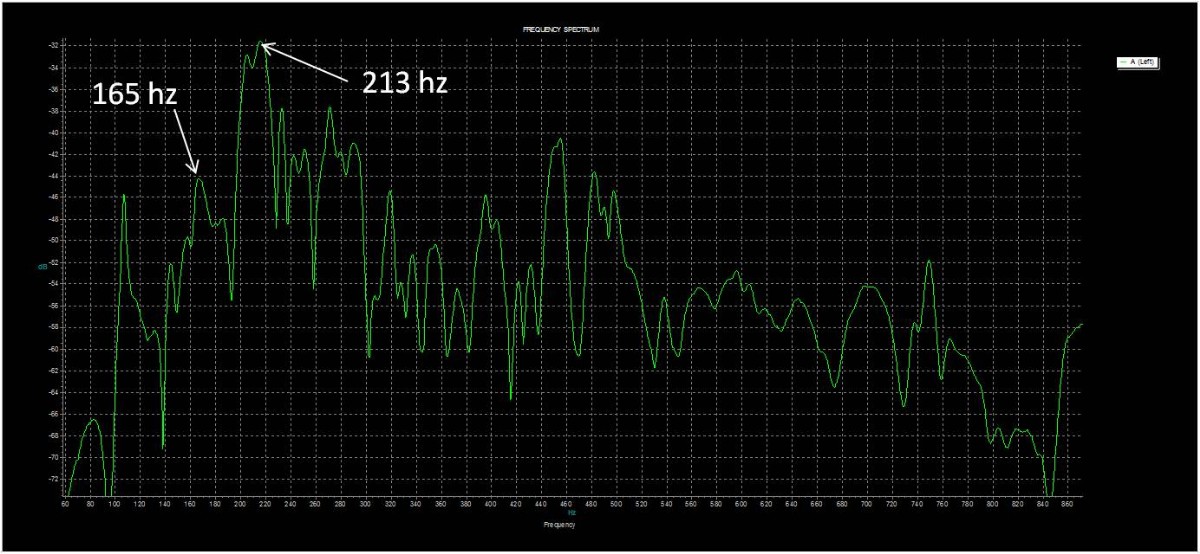

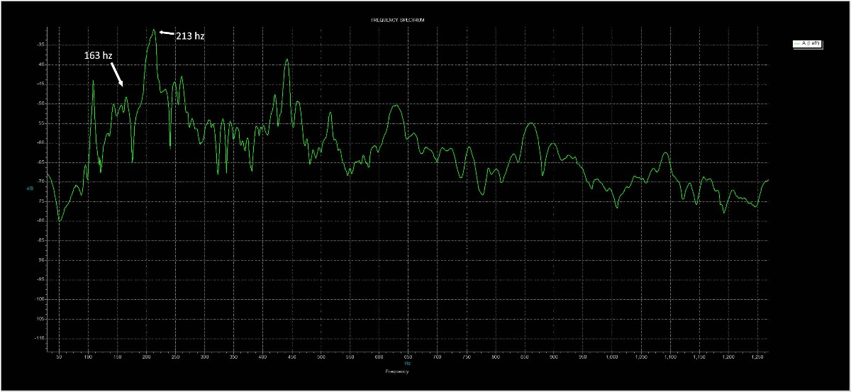

Ok, so I tried this again a couple of different ways.
Concerning Visual Analyser it's labeled 2011 and I have the FFT sample size set to 16384 with a sampling rate of 11025 hz.
This guitar that I'm re-tapping is the first graph shown in my original post.
In this graph the guitar is tapped with the sound hole plugged, the microphone is in the original position (1 meter out in front of the lower bout) and the guitar is on a stand, strings of course are well damped
I believe what is T1,1 dropped to 200Hz and the 168 Hz is still there. This next graph is the guitar tapped in playing position and the mic is about 1/2 meter off of the lower bout. The graphs a little different still. Thanks for the input guys.
Jim, it seems to me that you are still getting spurious results. If you have a stable measurement method and a stable guitar, you should get the first 3 peaks (at least) within ~0.5 Hz whenever you tap. So I think there is something still awry with your measurement method.
Here's a few things to try:
1) Hold the guitar as you would when playing, strings damped, mic about 1m away, pointing at the bridge
2) Make sure you get only one tap per buffer update (you should be able to see the screen refresh each update). Be sure there are no double bounces of the hammer
3) Try a different mic if you have one. A dynamic mic straight into my PC works well for me. I'm not sure what your Zoom stereo mic will be doing, but if you can use just one capsule you might find it better
5) Stay away from anything else that "rings", e.g. other guitars, your bench top, rooms that are particularly live, etc., and things that make noise like your computer fan, air con, etc. and things that induce electrical noise; magnetic fields, motors, fluorescent lights etc.
Your plots should be coming out as "clean" as those shown in the book. Those plots are just as it happened, no post production or anything.
Keep us informed on how you go.

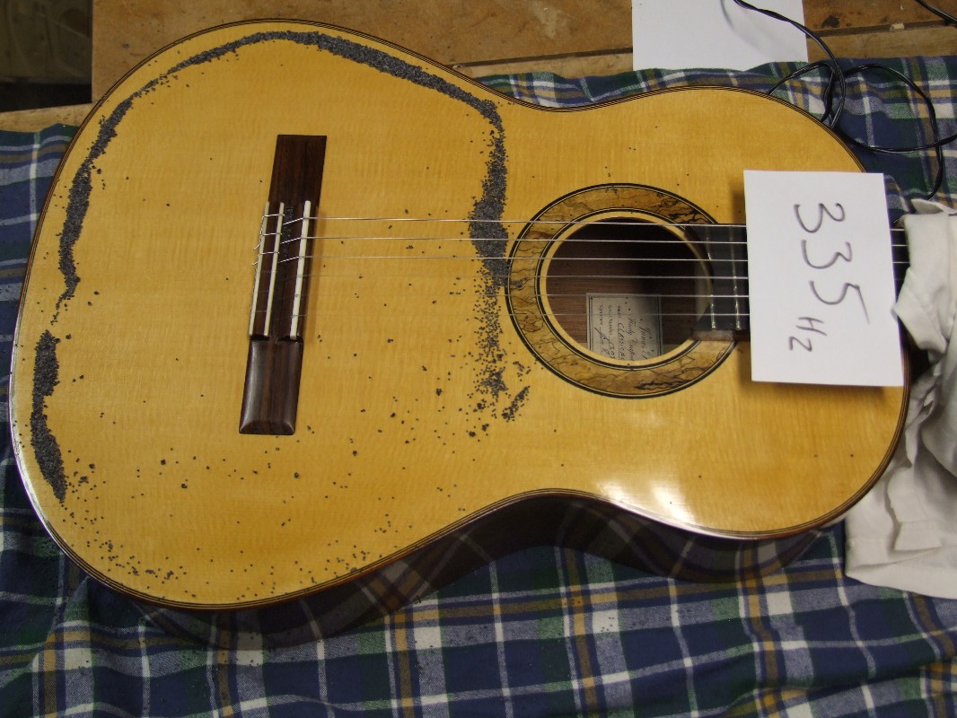

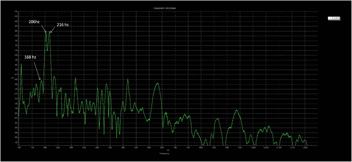

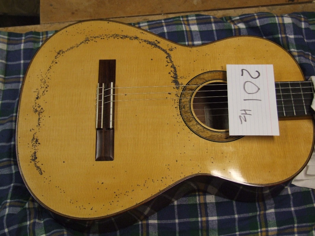

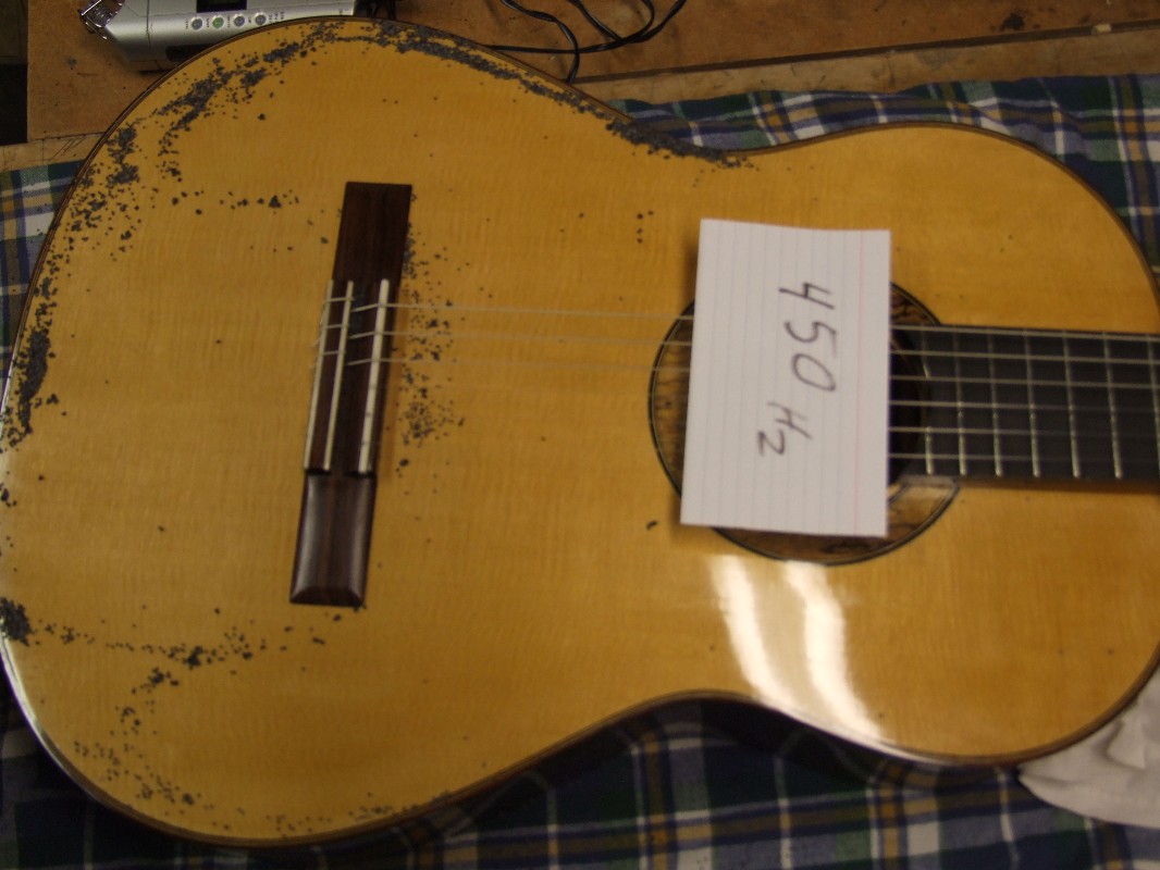

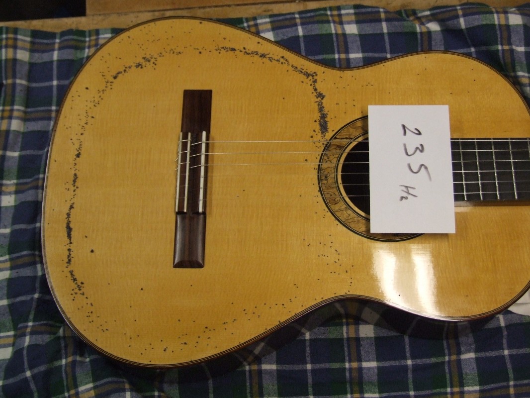

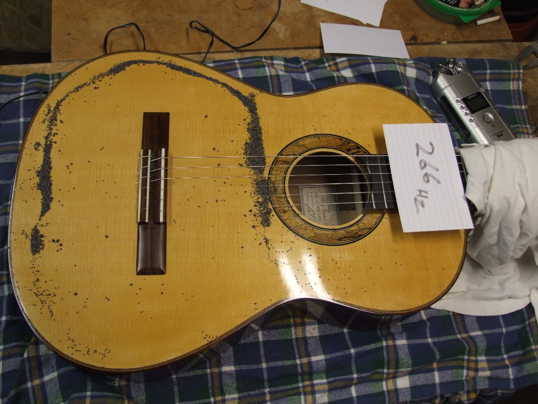

All right I'd thought I'd try to update this.
I was able to grab a speaker for checking the Chladni patterns at our local thrift store today. A KEF model 102 reference speaker for $3 !
I'm reattaching the spectrograph from the first post that is from this guitar just to make it easier for people if they're interested in comparing the the spectrograph with the patterns.
When I checked the 167 hz pattern there was nothing there, which I suspected. The confusing thing for me now is all the patterns look the same! Aghhh!
I made recording of the speaker to check the frequency being put out and it's spot on with some background noise about 40 db down.
In order to get the patters I just held the speaker box up over the top, maybe that was a mistake, I donno.
A quick comment about the guitar. It sounds really good, it's responsive, it's loud and a little punchy. A lot of people like it. I'll try to attach a recording too.
Well, here goes;
Well, here goes;
Jim,
The Chladni patterns all look like monopoles except for the last one. Does the instrument have standard fan bracing?
Right, Jim. I still think you have a bunch of weird stuff happening here, so let's see what we can figure out.
First up, a KEF 102 Ref (if you got the whole cabinet) for $3 is a real steal. Add a few zeros for what a working pair of cabs would normally go for!
Looking at your Chladni patterns, I would be saying that you have a T(1,1)2 at 201Hz, a T(1,1)3 at 235Hz, a cross dipole at 266Hz and probably a cross tripole at 335Hz. The mode at 450 Hz could be something like a T(4,2). So why do I say that? Well, I think the T(1,1)2 and T(1,1)3 are self explanatory and in the right frequency range. I don't think the 266Hz is a monopole. The reason I say that is because the outboard node line is pretty close to the edge, suggesting momentum equilibrium within the top, and a cross dipole is in the right frequency range. You may have shaken all the tea leaves off the central node line going through the monopole frequency with the sweep, but if you drag your finger widthwise over the top driving at 266Hz you should be able to feel the node on the centreline, and confirm it by sprinkling some more leaves there. I'd put up a similar argument for the the cross tri at 335Hz. There is nothing in your pics to suggest a long mode in either case.
The nodes of the multi-pole are evident in the lower bout of the 450 Hz mode. I think it has a node line going across the guitar, pretty much through the bridge. If you're really careful, you should be able to get quite a clear pic of it.
The next issue is that the spectrogram looks nothing like I would expect! I've tapped hundreds of guitars and not seen anything like you've got. However, the sound recording suggests a guitar that has the sort of frequency response that you've shown. It sounds somewhat weak in the bass and a bit on the nasal side. Whether it actually sounds like that in real life, only you can tell, but I'm guessing that it doesn't. So, presuming you used the Zoom mic to record both the taps and the playing, the finger of guilt points towards there being something odd about the Zoom mic.
The easiest was to test that is to find another mic, something like a Shure PG 57 or a similar respectable (not necessarily exceptional) dynamic mic. Do some tap tests with that and see what happens. I've used the internal mic on my lap top, external electret mics and external dynamic mics, all plugged directly into my laptop. For whatever reason (impedance matching, automatic gain control or ???) the dynamic mics (of whatever brand) come up with the cleanest and most repeatable plots. Most of the book plots were done with a Sennheiser dynamic mic, which died at age ~30 yrs) but the PG57 I use now produces very similar results, whereas other mics of other types don't, when plugged directly in to my laptop.
So Jim, that's as much as I can tell you and a lot of that is based on some pretty shaky assumptions. Let us know how you get on and maybe we can figure it out.

Ok I just switched to doing my tap testing with VA running native on an HP laptop rather than via virtual Windows on a Mac.
I'd revert back to running VA on the Mac but the new MacAir doesn't have a bldi mic input!!!
All that has changed in my setup is the computer and the fact Im running VA with Windows 8 on PC rather than Windows 7/Parallels on the Mac.
Its got to be fan noise right? Ive turned off fluro lights and any other electrical device in the workshop except the computer and pre-amp power supply. Ive got both of the latter sitting 5m away from the mic.
- Posts: 1639
So Martin, what's the problem?
If it's noise that looks weird (i.e. not 50 Hz, fairly random etc.) here's a coupe of things to look at:
1) Digital "Earth loops". These don't look or sound like analogue earth loops. I had this happen when using an M-box with my Toshiba laptop via the USB port. Drove me crackers. The current lap top has a 3 pin power plug on the power supply. I had an old power supply from the previous Tosh. That was two pin. Swapped the two power supplies, which were otherwise compatible. Problem gone.
2) Overloaded input. You might be over-driving the input (one problem) and/or interacting with some automatic gain control, likely embedded somewhere in the computer rather than in the pre-amp.
Neither of these problems looks or sounds like their analogue equivalents.
