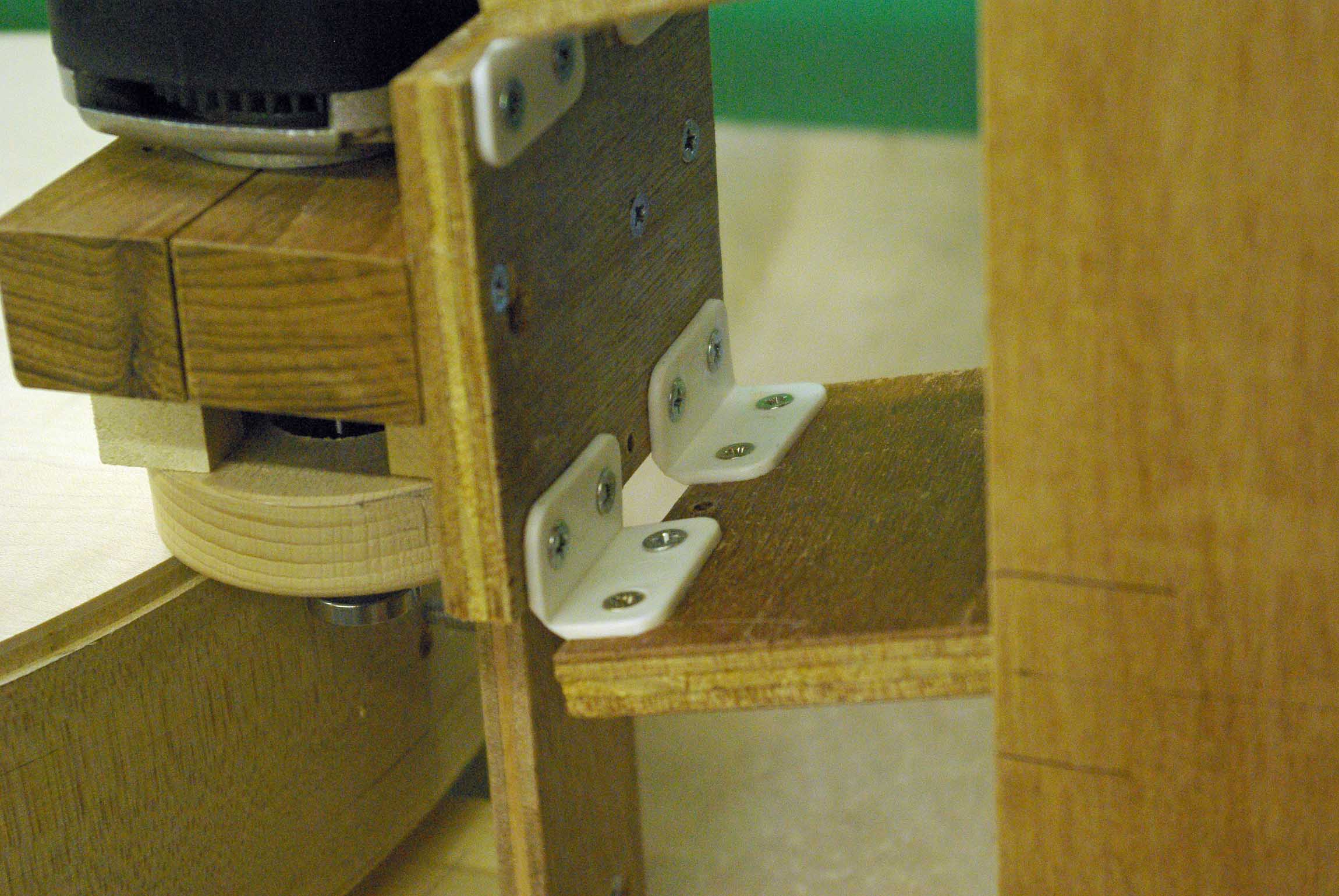

Matt I had to search a bit here in the UK. Most of the plastic hinges that came up were like ordinary butt hinges with a hinge pin. I eventually found a couple of sites listing them as caravan accessories - presumably because of the damp.
This was one of them for people in the UK:
http://www.leisureshopdirect.com/carava ... white.aspx
I originally built a binder with brass butt hinges but there was indeed a lot of play. The plastic ones were better but still left some flexing. However it didn't matter. Much to my surprise the Heath Robinson looking device worked really well. Well worth building. I got really clean, regular binding channels.
Cheers Dave M
