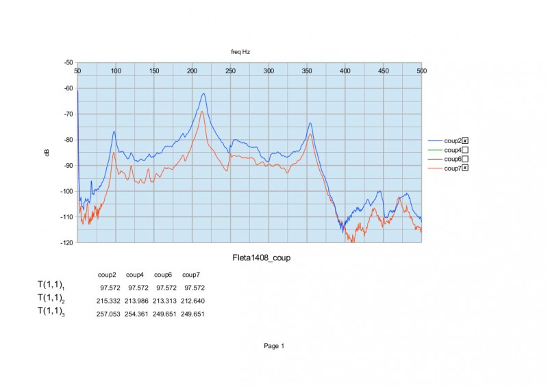

My first tap test just after closing the box is as in image Fleta1408_coup.jpg as the blue line:
What I can see so far is:
1. T(1,1)2 at 215Hz is too hight;
2. The peak at 257Hz I assume is T(1,1)3
After a few sand job on the back (red line):
3. The T(1,1)2 drop a little to 212Hz
4. The assumed T(1,1)3 "disappear"

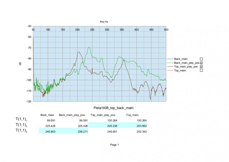

At first I though the peak at 249Hz was the T(1,1)3. But it have no change after the sanding, so I conclude that it isn't. To make sure that is the case, I make another tap test on the uncoupled top and back:
5. The B(1,1) is at 238Hz
6. The T(1,1) is at 205Hz
So, I ask for some advise on what to do next:
7. Should I sand the borders of the top, to make the frequency drop?
8. Why T(1,1)3 is not so prominent like seen on the book and the others posted here? Is that because it is only 3 semitones higher from the top? B(1,1) at 238Hz doesn't seems it is too stiff.
I don't if that is useful at the moment but, if I did the math right, the "monopole mobility" is 40.37 (s/Kgx10-3) and the "flexural Rigidity" (EI) is 26.32 Nm2

Hi Jorge,
At this stage, I'd be installing the binding, applying the finish and installing the bridge, saddle and strings (get the guitar complete and strung)
All these things will have an effect on the finished resonances.
Tapping the top once you have done that will give you a guide to what you need to do
Making modifications now is too risky
The Fleta has a 4 brace back which may be too rigid to give a T(1,1)3 regardless

Jorge, there will be significant changes to modal resonances as you proceed through the build. The most significant change will be the addition of the bridge so it is worth spending a bit of time attempting to predict what will happen when you glue it on. Simulating the effect of mass is quite easy, but simulating the effect of the added stiffness that the bridge gives is not. Section 4.6.1.3 covers this and has a chart that you may be able to make some predictions from. If you add some mass to the top in the bridge postion (say 15grm or whatever your bridge mass is) and then measure the T(1,1)2 you will be able to see how much the T(1,1)2 drops. If it doesn't drop to your target (say 190Hz) you can be pretty sure you'll need to make the top less stiff, because the bridge itself will add stiffness (as well as mass) and so the T(1,1)2 will not drop as far. At this stage, I wouldn't do any more to the back as that can be easily tuned if necessary when the guitar is finished and it is much easier to make it less stiff than to make it stiffer.
