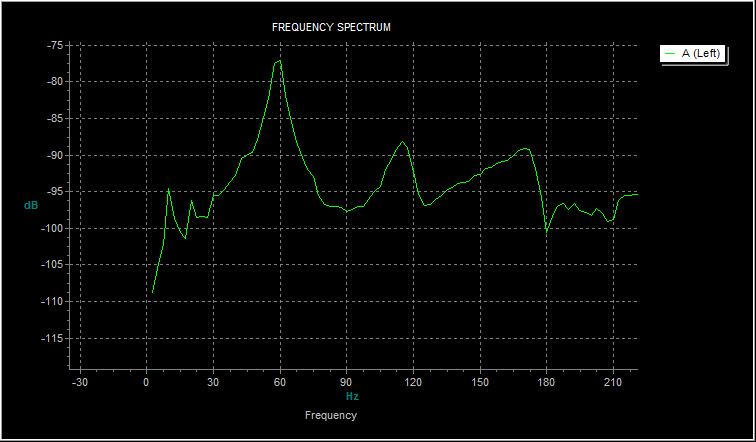

I several tops where I have troubles finding the Cross Grain mode. When I tap/recored I find (mostly) two frequencies which stand out.
For example I have this top:
And the following recordings:
Twinsting vibrationmode (fLC) at 59 Hz.
Long grain vibrationmode (fL) at 84 Hz.

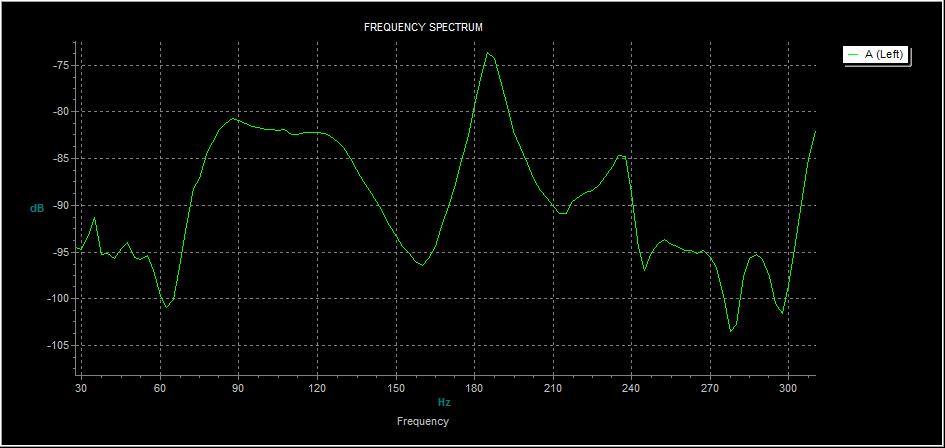

Then the Cross grain vibrationmode (fC):

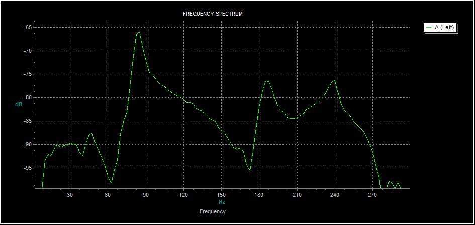

Or moving allong the node line:

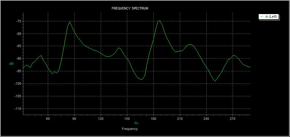

and

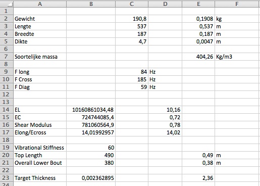

With F Cross at 185 Hz I get a Elong/Ecross of 0,78.
With F Cross at 87 Hz I get a Elong/Ecross of 63.4 (which seems very high).
Can I therfore exclude the 87 Hz mode for the Cross grain?

Checking P 4-63, Table 4.5-3, I'd say the 185Hz figure is likely the correct one, given the thickness you have.
