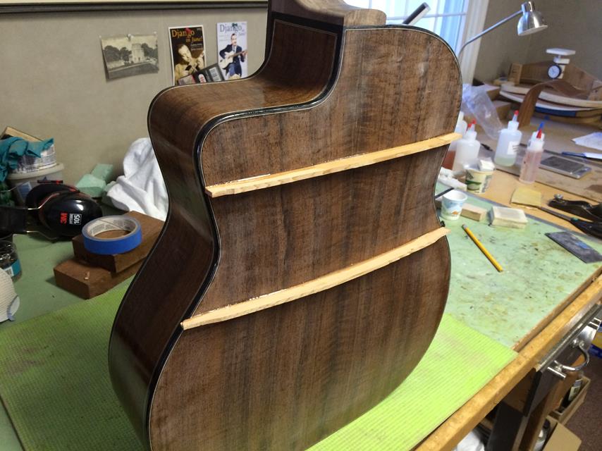

Here's what I ended up doing. Epoxy filled the back until the grain was fully filled and smooth. Then glued a couple pieces of scrape 4mm cedar top material to the back with five minute epoxy. The laminated back is the first I've made with an violin back shape. I thought with the shape and one brace, it would be stiff enough, but not so.
I started with pieces about 30mm tall and shaved them down until I got the peak where I wanted it.
The test braces should be able to be carved off and the residual epoxy feathered out eventually.
The guitar is definitely improved with close to four semitones of separation between the back and top. So, now all I have to do is figure out how to get the braces inside a 54 x 70mm sound hole. I'll probably have to take the top or the back off, but if anyone has a better idea, I'd love to hear it.

Right, I had a 7x18mm ladder brace at the max width of the lower bout already. Molded archtop like backs with a single brace were used on some vintage French gypsy guitars. This was my first go at it and I misjudged the stiffness. I thought the shape would lend more stiffness, but it was less than I guessed. The inside brace plus two outside braces makes three in the conventional locations for a Selmac.

A number of the French vintage gypsy guitars had soft backs, molded (laminated) to a dish or violin back shape, some with only one or no braces at all. Soft being a back with B(1,1) lower than T(1,1)2. Deflection under a 1kg load can be over 0.30mm! The result is usually light weight, high volume, quick attack and good sustain. On the negative side, there can be an excess of resonance, ringing and lack of clarity and nuance.
I've been paying more attention to the backs on gypsy guitars and find some I like best have backs that are 2-3 semitones higher. In my test guitar above, the back was at 200hz and the top at 235, fairly common for a soft back gypsy guitar. The added exterior braces took the back to 265. I thinned the top edges a little and added 8gr to the bridge and got the top to 212. Pretty drastic change, eh? From 2.7 semitones below to 3.8 above.
The result is equally dramatic. Louder, more clarity, less resonant, better balance and more nuance. This guitar is a little too brassy and this did not change. Darker strings will fix that I think.
Ha, the doctor will see you now! Taking the back off is probably easiest way to go, the only (interior) brace is not socketed, so with bindings off I can probably zip the back off with a hot knife without too much trouble. The linings are fairly stout which should help as well.
