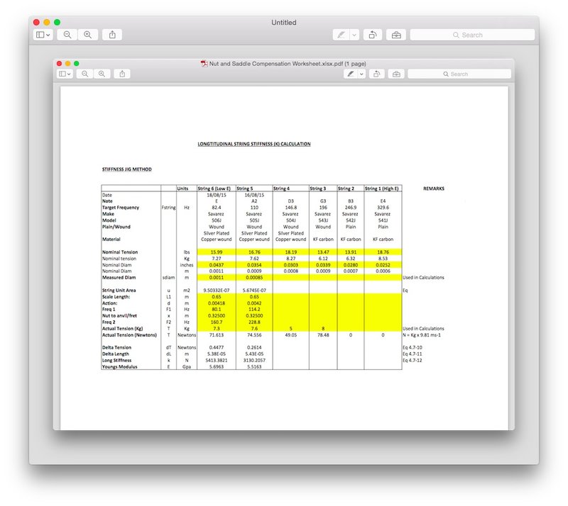

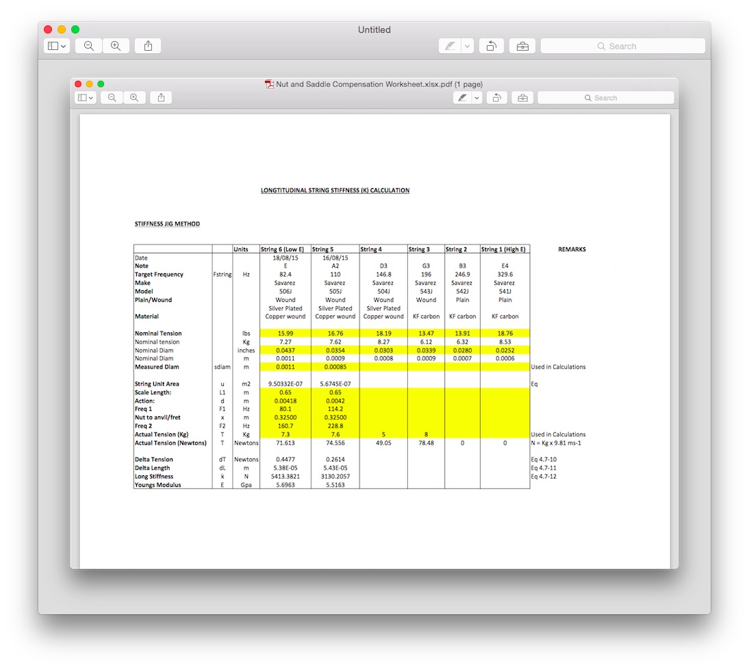

I put the low E string back on the jig for a few more days and re-tested. Results in table below.
- Posts: 1647
Re: String Stiffness Jig results
That looks a lot closer to what I've been getting for k.
