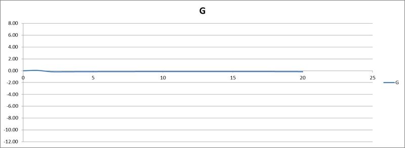

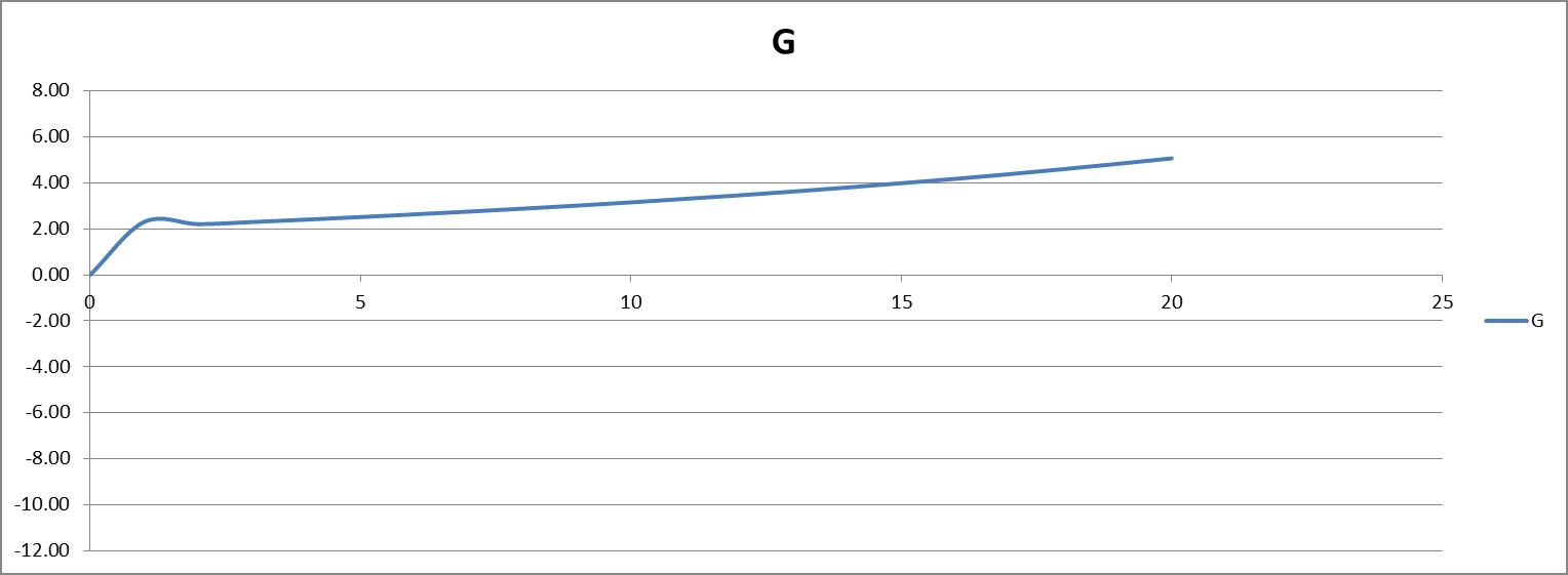

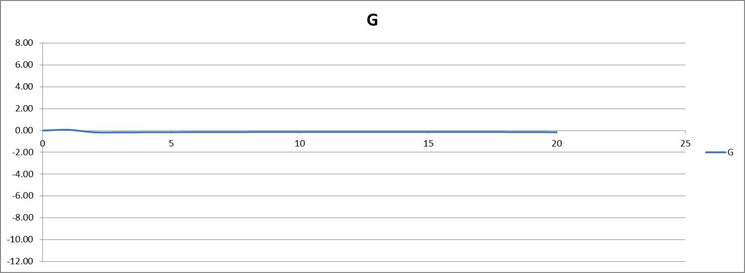

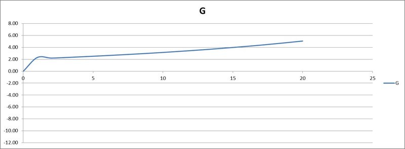

I'll give you my 2 cents worth in response to questions 2 and 3. For calculating the action values at each fret position, I don't think it really matters whether you use the compensated length or uncompensated length. The component of the action value due to neck relief is quite small and the method of combining an circular component and an elliptical component is an approximation anyway. The real curved shape of an initially straight neck that results from the tension applied by the strings and the forces applied by the adjusted truss rod can only bet determined by structural analysis. It depends on the shape and the taper.
When I was first tackling the compensation calculations, I was also unsure whether to use compensated or uncompensated lengths in the various formulae. That's why I developed a "Trial Compensation Value" approach. I could use the trial compensation values in every equation. It was also easier for me to understand the process with this approach.
Following is a brief description of the method I used. Of course, it is based entirely on the method and formulas in Trevor’s books. While the results I got in my calculation spreadsheet seemed correct, I can’t guarantee the method is correct. That’s one of the reasons why I am giving the description below. Perhaps some learned luthiers could review it to see if there any errors of logic. I would be quite happy to send the Excel spreadsheet to anyone interested (PM me).
The part of the calculation process that I will describe starts with a set of action values, ds,n, one for each fret. The method for calculating these is as in the book. Here is the main section of the spreadsheet. At the top of the spreadsheet is the basic input data which should be self-explanatory. Yellow cells contain input values. The trial compensation values are in the blue cells.
Columns 4 to 8 calculate the components of the “path Length” Ls,n which is in column 9. The value of l1 is determined using the trial nut compensation and l3 is determined using the trial saddle compensation. The length increment in column 10 is calculated using Equations 4.7-24 and includes the trial compensations. The tension increment in column 11 is calculated using Equations 4.7-31. The target frequency in column 12 is calculated using Equ 4.7-33.
The tension of the unfretted string is calculated using Mersenne’s formula, using the actual (trial) string length (= scale length – nut comp + saddle comp). The fretted tension values in column 14 are obtained by adding the appropriate tension increment in column 11 to this value. The fretted frequency is then calculated using Mersenne’s formula from the fretted tension and the vibrating length of the string, which is l3. The intonation error in Hz and in cents is then simply calculated from the fretted frequency and the target frequency.
Following are graphs of intonation error vs fret no. The first is with no compensation and the second with nut compensation of 0.8mm and saddle compensation of 0.5mm. It is really quite a quick exercise to determine a suitable compensation amount for the nut and saddle. Using optimisation techniques to determine these is great if you are a spreadsheet whiz. However, there are only two values to optimise for each string. One of those mainly affects the lower frets and the other the upper frets.
Any comments, verification of method or results would be appreciated.
