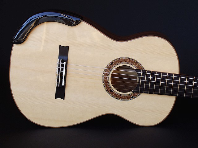

First thing I'd ask is why a bevel?
Whilst a bevel is easier on the forearm for sure, it also puts your arm onto the top, adding a lot of damping. So I usually go for an arm rest, which takes the pressure off the forearm and also takes the forearm off the top. And no need for any thickness adjustments.
Here's one:
...and, of course, it's removable...
If you're definitely going the bevel, just deduct the top width lost. Probably 15-20mm.
