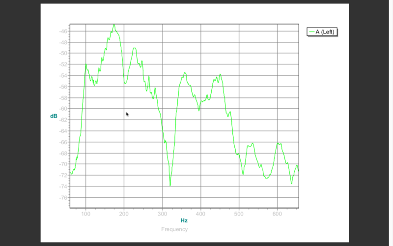

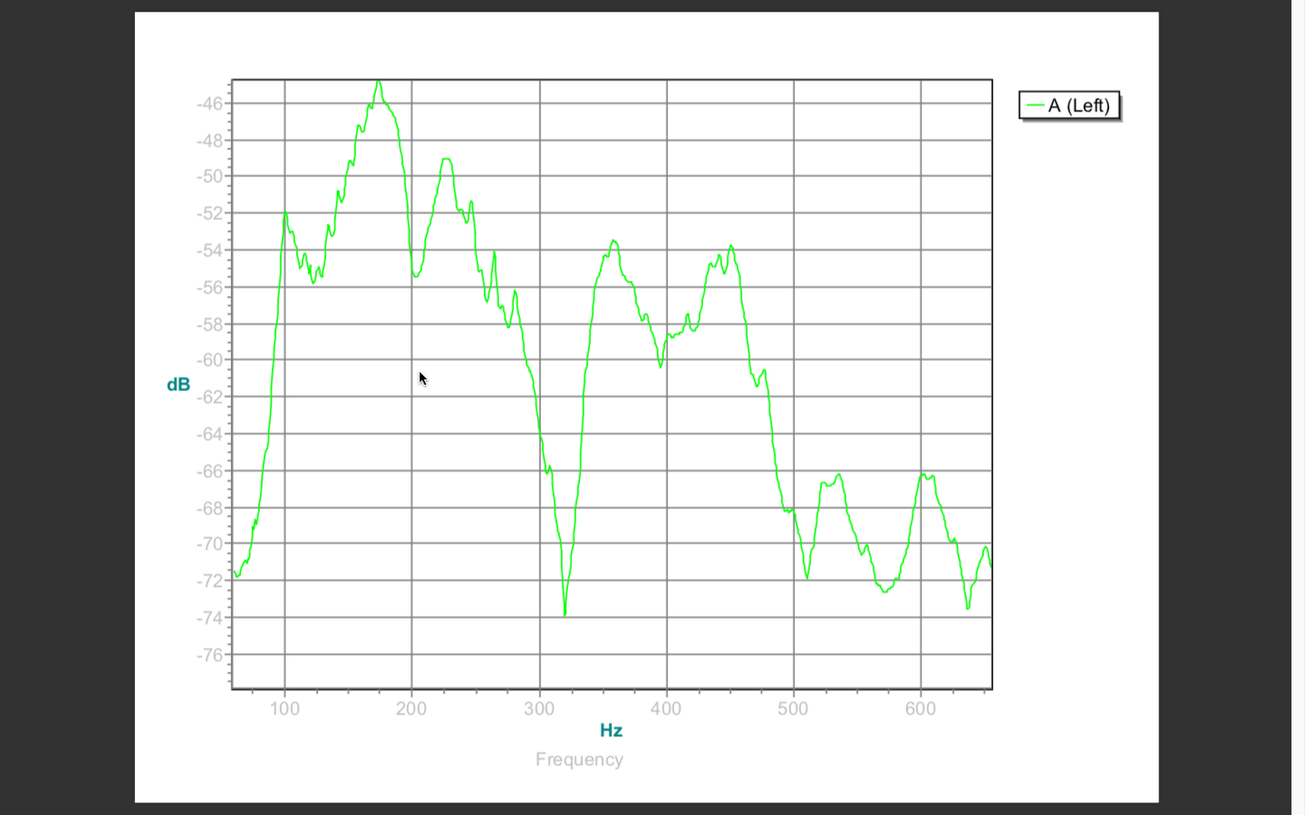

I just completed the "box" based upon the falcate design in your book. I am using an Englemann Spruce top with Sapele back and sides. Attached is the frequency spectrum. The main top T(1,1)2 appears to be quite a bit lower than expected in the design book... Can you take a look and tell me your thoughts and how I best proceed, please? Be frank, you will not hurt my feelings...much...8-D Also, I used the spreadsheet to determine the initial plate thicknesses...Thanks in advance, Ron Rapp in Roxborough, Colorado USA.
- Posts: 1641
Re: Prototype Gore Guitar Freq Request
According to your chart, the T(1,1)2 is at ~175Hz, which I would consider too low at this stage of the game for a "normal" guitar.
First thing is to check your measurement set-up for VA and associated hardware so that you are confident you are measuring correctly.
If you are, you are likely to end up finished with a T(1,1)2 of ~ 160Hz, which is definitely on the low side, but maybe still a workable guitar, depending on your sonic tastes. The question to seek answers to is why is it that low? To help you answer that, I will need to know a lot more about how you put the guitar together; materials and dimensions etc..

I re-tapped the box with it in my lap, and attached is the resulting chart:
T(1,1)1 = 97
T(1,1)2 = 172
T(1,1)3 = 227
Thanks for looking into this again.
Ron Rapp

OK, thanks Ron.
The plot still looks a little raggedy, but much the same frequencies as last time. Why the T(1,1)2 is that low is hard to say. The plate properties and thickness prediction are exactly what I get in my spreadsheets. The braces are larger section than I use, but that should result in higher rather than lower frequencies.
Is the rest of the build according to the plans? Did you end up on the target plate thickness? Is the CF as specified, bridge plate as specified etc. etc.? Do you have any photos of the braced top you can post?
Otherwise, it's down to Section 4.11.

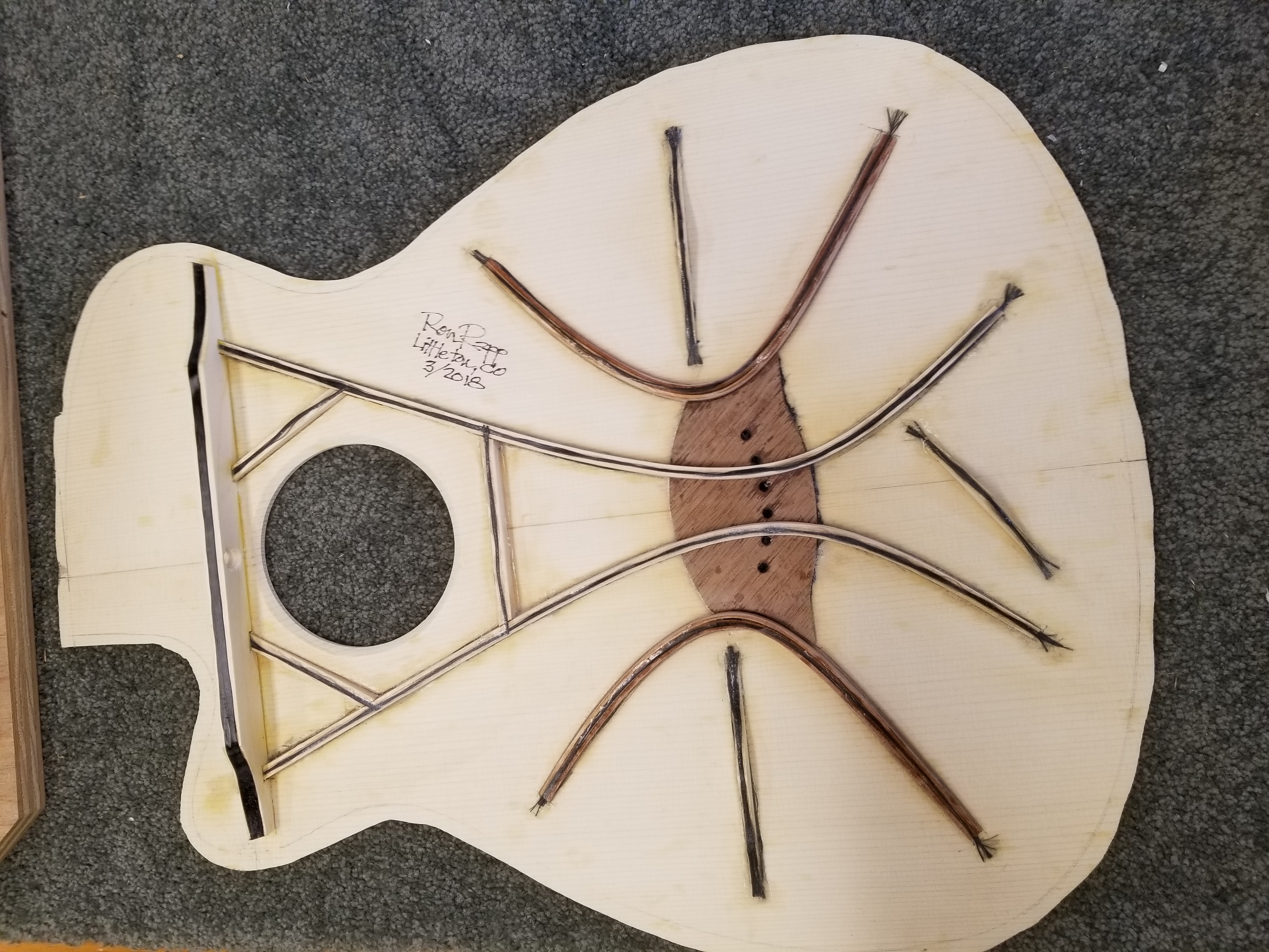

Thanks Trevor,
Looks like it is back to ol' Section 4.11...
As you can see from the picture, my epoxy/carbon fiber skills need work, but I think my wood fitting skills are reasonable...
If you see any "Oh, THAT's the reason for the low frequency", please let me know...

Nothing jumps out from the picture. All I can think of that's left is the quality of the epoxy mix (were the proportions correct, was it mixed thoroughly, was it warm enough to cure properly, etc.?) And finally, how is the fit between the underside of the primaries and the bridge plate? Are they glued down properly?

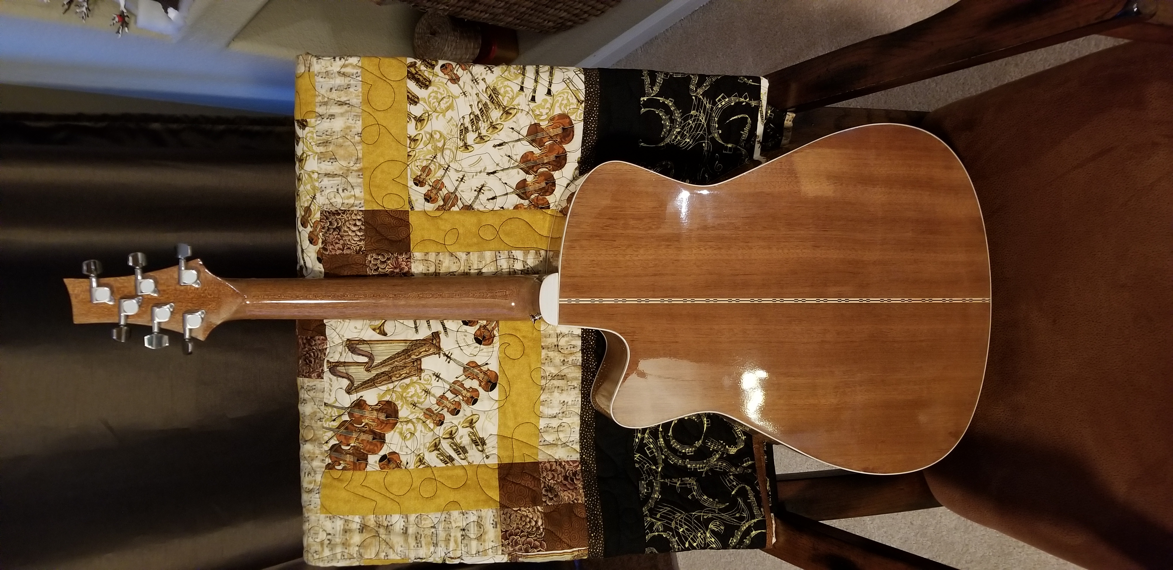

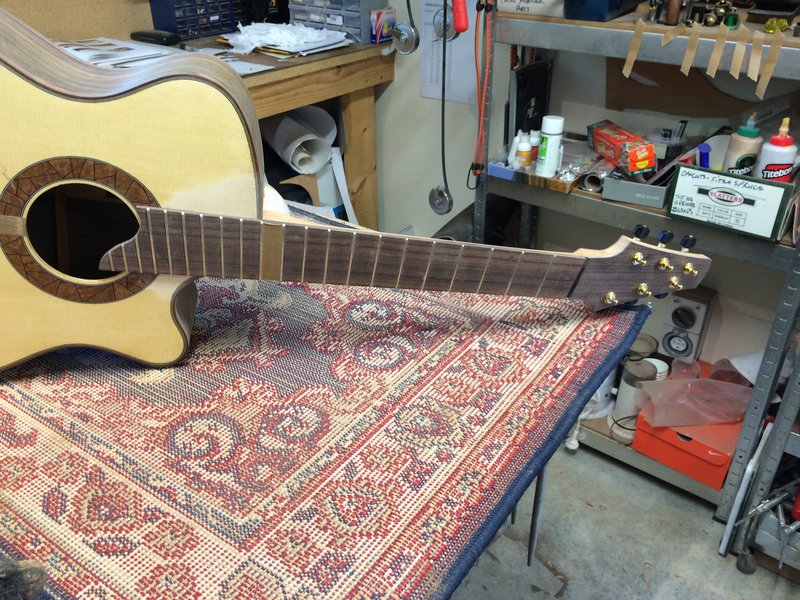

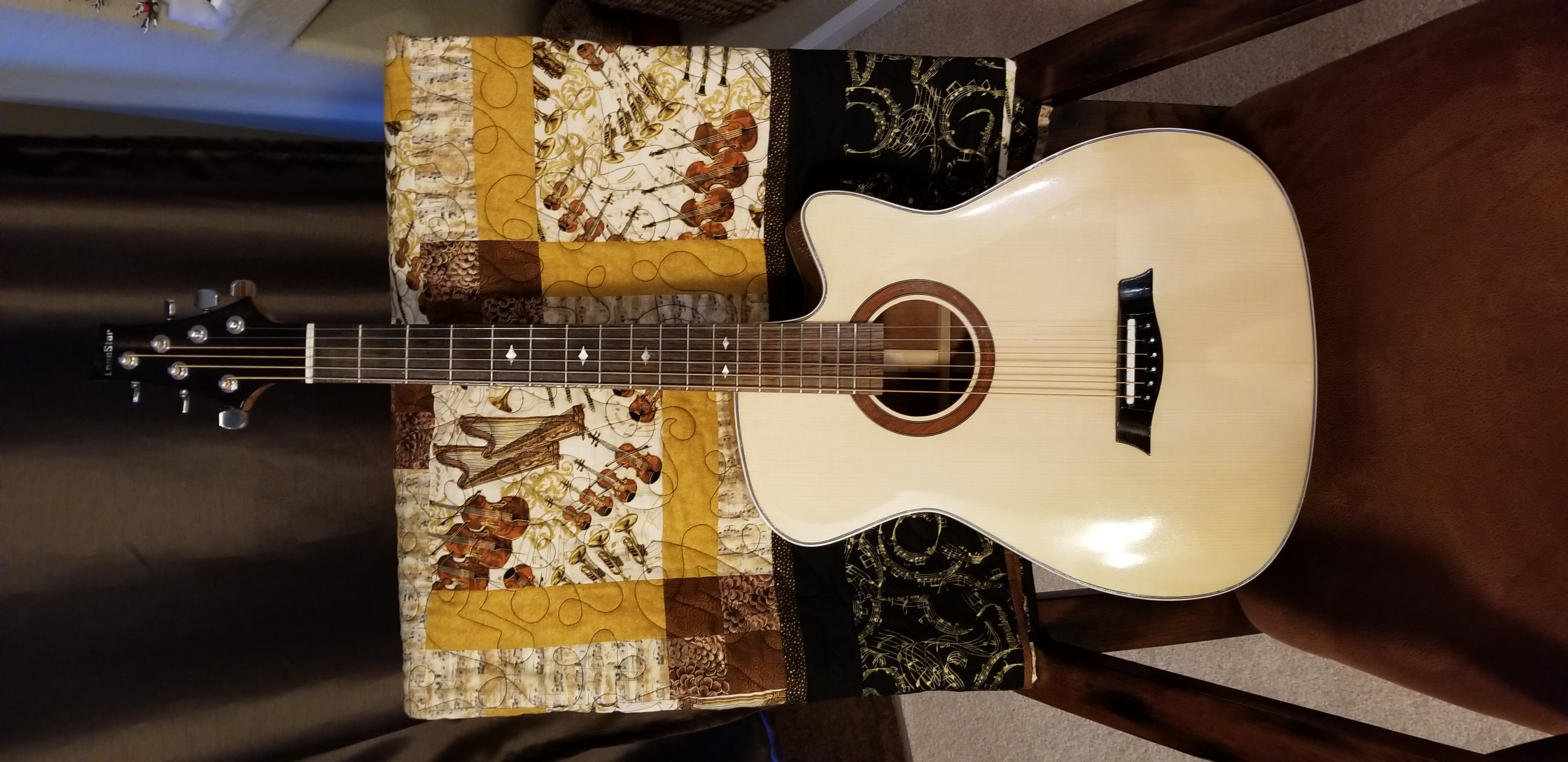

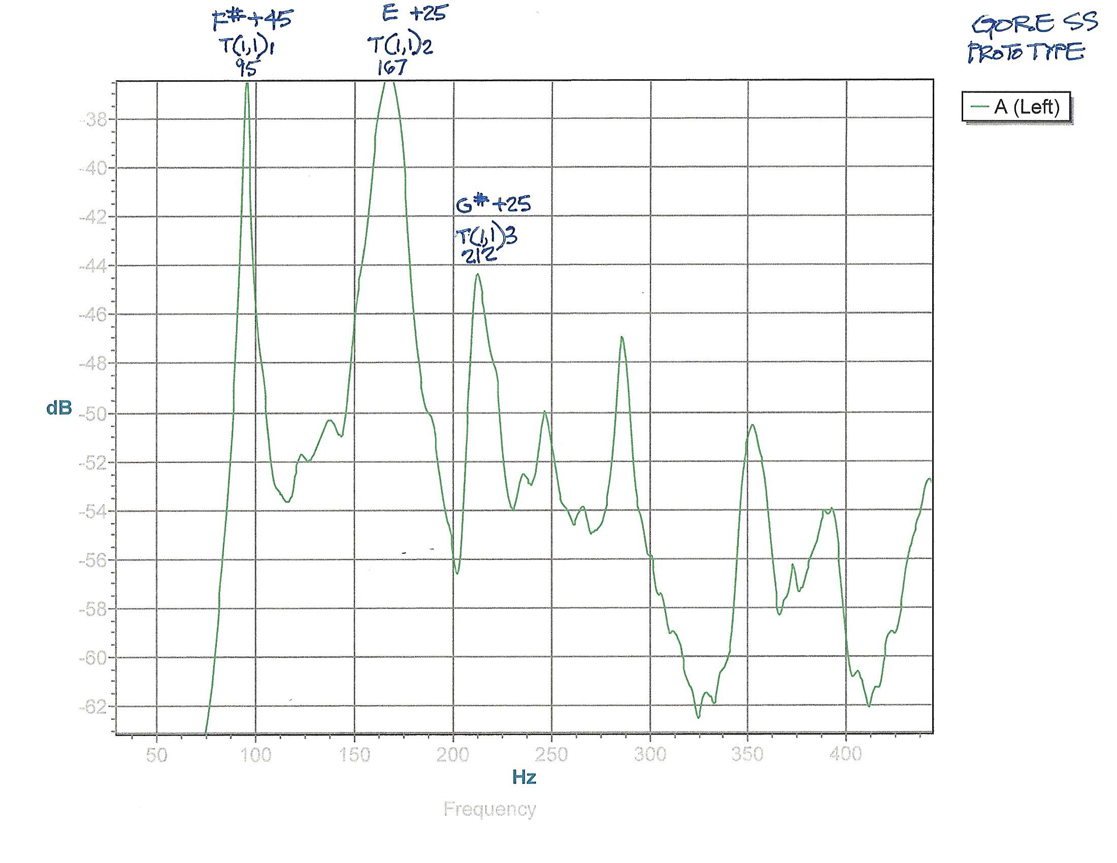

To follow up, the tap test for the finished guitar is shown below, along with some pictures...
Wow! That's a nice looking guitar Ron. Nice clean lines and not too much bling.
Just one question...what's going with the missing 19th fret? Have you yet to do the final shaping of the fretboard end?

Very observant Martin!
I guess indecision got in the way...
I was planning on putting that fret in, but then started thinking about trimming the fretboard down, and ended up in no-man's land...
What would you do with it?
Thanks,
Ron
Thanks,
Ron
On most of my Gore builds I finish off the end of the fretboard as Trevor does in his books with the double curve. It's a bit of a pain when you're continuously reaching through the soundhole to fasten and unfasten the neck bolts but visually I think it looks nice. You're current fretboard probably doesn't extend into the soundhole far enough for this design to work. On my builds where the fretboard ends close to the edge of the soundboard I generally put in a curve of same radius as the soundhole and have the fretboard just nudging the edge of the soundhole at the apex of the curve. I suggest you make up a few cardboard mock ups of fretboard ends and place them on the fretboard to visualize how they'll look.

The guitar looks great and I bet it has a good voice as well. I just round the end of my fret boards off short of the 19th fret.
Martin, thanks for the response! Yes, I don't have enough material for a double bend...but maybe a sound hole curve...
John, thanks, I have been following your builds on Robbie's forum! Good work!
If I trim back the fret board then my T(1,1)1 should increase...which would be a good thing if I don't land on 98 Hz (G)...maybe incremental trimming?

Looks great, Ron!
Do you like how it sounds?
BTW, anything you do to the fretboard will increase the T(1,1) frequency. Whilst not a regular solution, it is OK to leave the fretboard end as it is. It would be far from the first with that treatment.
