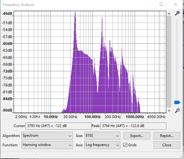

Hello all! Quick question (hah) - how would you interpret these results? Do they make sense?
I'm tapping the back panels for a new guitar. They are slightly figured walnut, 4mm thick, 217mm x 605mm, mass 297g.
If I had to guess, I'd read the results:
fL = 38
fC = 98
fLC = 52
It seems like this roughly comports with the values in Trevor's book, the Walnut being less dense than Rosewood.
I have a spreadsheet with some of Trevor's formulae and have plugged the above data into the Youngs Mod Dynamic Method tab... but I'm not sure which formula to use to calculate a final thickness. This is for a Gore-style J45, using plans from the book.
What do you think? Thanks so much!!
Chris

- Long Grain fL
- Long Grain fL.png (34.06 KiB) Viewed 12461 times

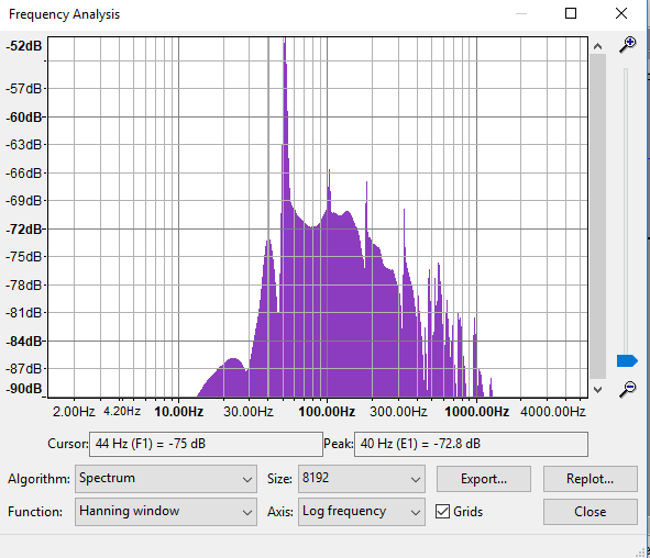

- Cross Grain fC
- Cross Grain fC.png (32.82 KiB) Viewed 12461 times
- Twisting flC
- Twisting fLC.png (30.26 KiB) Viewed 12461 times
Re: Tapping panels for thickness?
Ok, rereading, I realize the formula I'm looking for is 4.5-7. One confusion I have is what is the variable "p"(square root) in the top line?
Elong/Ecross? Density?
I think I'm understanding the rest.
Thanks!
Chris,
The "p" is ρ (Greek "rho") and is the symbol for density. See Fig 4.5-4.
There's more stuff on coding up Equ. 4.5-7 here and here. The typos have been fixed in the 2nd edition.

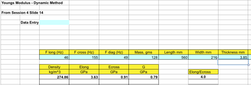

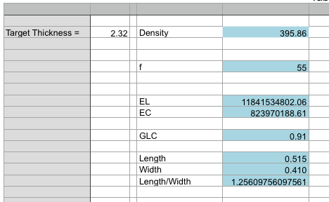

Well, after some trial and error, I got some results!
Using numbers from the book and the threads you pointed out, I was able to come close to your target thickness for Englemann #1, so I think my equations work.
However, 2.3mm for a back seems a leeeeetle too thin. So perhaps my frequency measurements are faulty.
Just a point of clarification... When using the Youngs Mod Dynamic Method formula, the actual measurements of the panel being tested are used, but when using formula 4.5-7, the dimensions of the guitar you intend to build are used, correct?

- Posts: 1643
Chris, the density seems very low for walnut at 395.9kg/m^3. ~570 kg/m^3 is fairly typical. Having said that, 2.3mm for a back panel thickness is fairly reasonable for a live back.
Correct. Be sure to use the right dimensions in the right places. Panel dimension for Equ. 4.5-2, 3 & 4; box dimensions for Equ. 4.5-7.

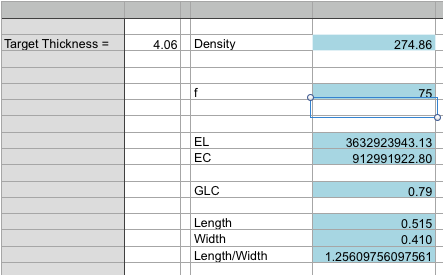

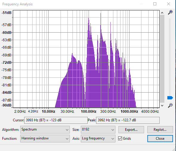

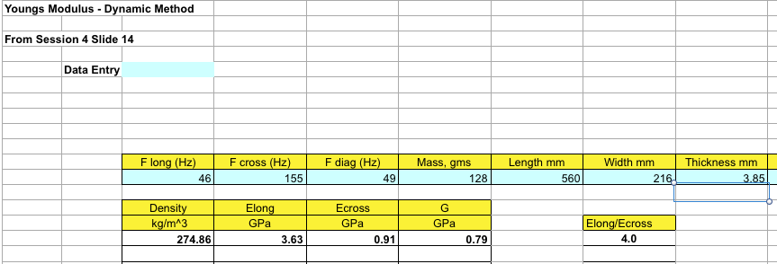

Well, I tapped the Redwood top I have... mixed results. I'm intending on building a Gore-style J45 (very light X-bracing).
I tried several different tapping methods and got pretty consistent results.
This is a piece of tempered Redwood. It's very well quartered, very light and very stiff.
The panel itself is already thinner than the formula recommends for a steel string guitar.
So, either: 1) my measurements are off (FL,FC,FLC), 2) I can build, but take very little off the panels, 3) this isn't a suitable top for a steel stringed guitar.
Thanks for taking the time to help, I really appreciate it!
(As an aside, Trevor, my wife was in Sydney on business a couple weeks ago and thoroughly enjoyed it! She only really had a day to see the city before holing up in offices, but it was enough to spark the urge to come back someday!)
Chris
Chris
- Posts: 1643
