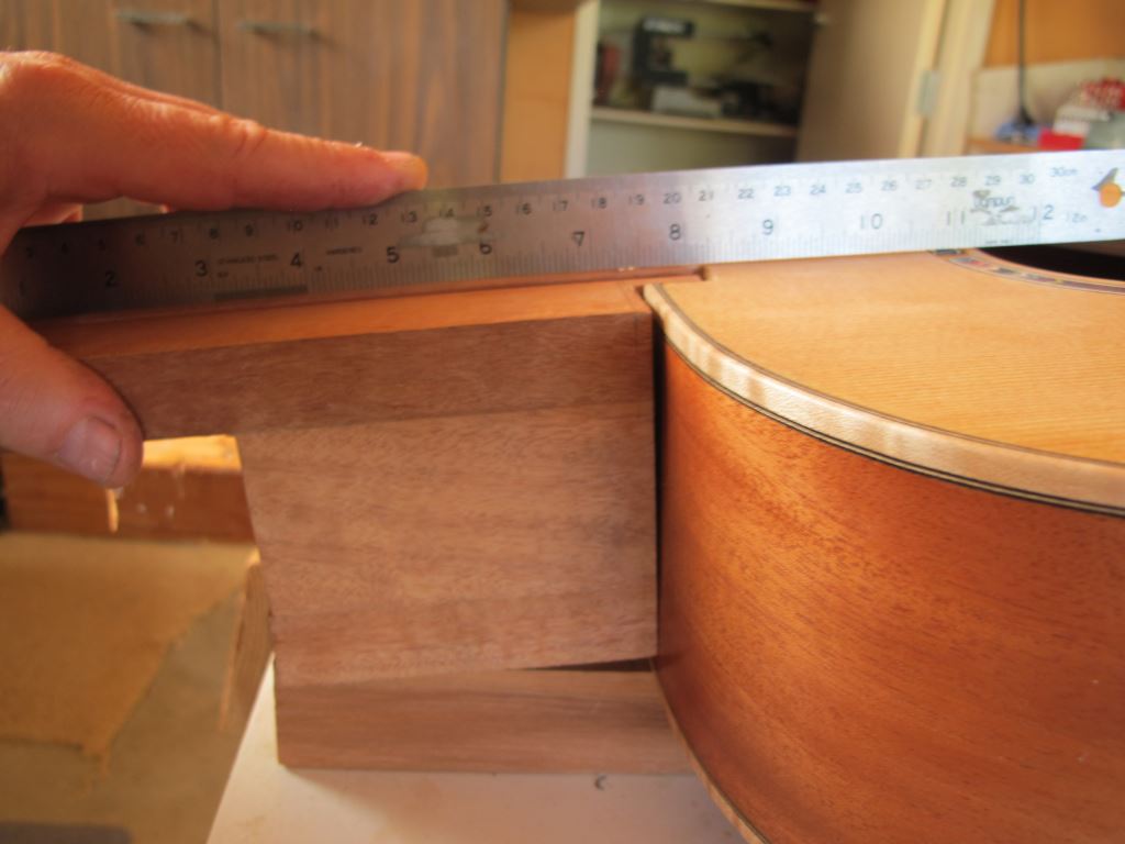

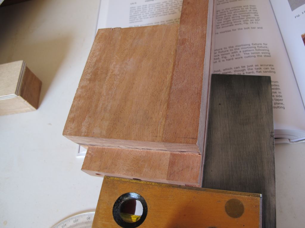

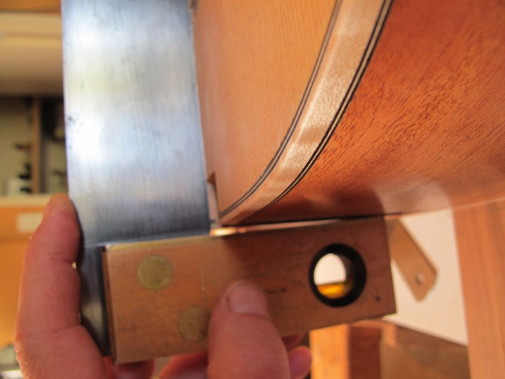

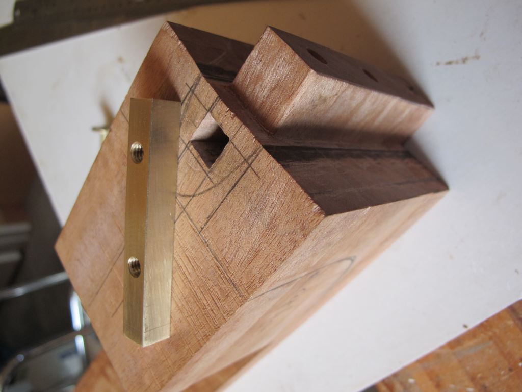

I've just drilled the holes in the neck and bolt bar after having done the mortise and so on -everything is referenced to the top of the neck and the front of the tenon. I think I have your point 2 above fairly OK but I have point 1 completely wrong. Then it goes on to say "before any holes are drilled, the neck pitch angle has to be correct (and also the yaw and roll). " Ahhhgh! Hang on. The mortise is drilled before any correction to the neck angle isn't it. Then the holes are drilled perpendicular to the face of the tenon which is at 90° to the top of the neck - that is what it shows on the plan? Lining up the neck and the body, there is a MAJOR correction to be made to get the right angle but I can't see any detailed reference to this prior to drilling the holes in the book and how to do it.
So, the question is, have I got the order wrong (or have I somehow got the body shape wrong. I was pretty careful to get the alignment right?) The body has to have an angle as shown due to the curvature of the top to give the 2.5 mm over the saddle as you explain above. So some departure from 90° must be expected, but if I trim the shoulders of the neck to rake the neck back, the mortise hole will be less than 5 mm from the front of the heel wont it? Can you please suggest where have I gone wrong and can I retrieve the situation? Thanks Richard
- Posts: 1643
Re: Bolt on bolt off neck - order of operations
From what I can make out from the pics (the wide angle distorts things a lot) you didn't have the neck fully fitted before you started drilling holes (both the mortise and the bolt holes). It seems that the major problem is that the tenon is too long to allow the cheeks to sit down against the sides. The fix is just to cut some of it off so that...Trevor Gore wrote: ↑Wed Jun 20, 2018 8:58 pmBefore any holes are drilled, the neck pitch angle has to be correct (and also the yaw and roll).
It looks like you may be having to cut some sort of wedge off the end of the tenon. That's OK. If you drilled the bolt holes and mortise as specified, referencing off the top of the neck and the top of the upper bout, they will now line up, which they wouldn't have with the tilt that the the over-long tenon caused.Trevor Gore wrote: ↑Wed Jun 20, 2018 8:58 pmWhen the neck angle is correct, the mortise and tenon joint should still be reasonably tight (i.e. not flopping about) but there should be a gap behind the tenon, i.e. between the back of the tenon and the back of the body mortise. This gap is uncontrolled, but is typically~ 1-2mm and may be tapered.
So, if I'm reading this right, no need to panic. It's a simple fix.
Neck fitting details are in Section 14.3 et seq.

The reference surfaces are the top of the neck and the upper bout of the guitar box. If the jig is clamped down to the top of the neck or body, you will drill holes in the neck or body parallel to the respective surface, the same distance down from that surface. So if your jig is right, the holes in neck and body have to line up and that is why the same jig is used for both neck and body drillings. The angle of the back of the tenon, or that the top makes to the sides of the box, is irrelevant to the jig. It references only from the top surfaces and the sides of the tenon or mortise, not the back. That was covered earlier in the thread, in this post (don't flex the plexi).
OK, with the tenon shortened the neck is now tilted forward? If so, shaping the heel will help pull it back (assuming it's not a cutaway) due to the 5 degree undercut on the shoulders. That will get you at least half way. If you have 4mm of wood in front of the bolt bar you should be fine. Don't jack up the bolts too tight, though. The steel and brass will always beat the wood even with 5 or 6mm in front of the bolt bar.

Thanks Trevor. Well, with significant fiddling I've managed to overcome the above fitting problem and now have a functional bolt-on-bolt-off neck. I still can't say I completely understand the way the geometry is arrived at as the angle of the heel block must change as it is shaped and contoured due to the undercut, as you mention, so the initial adjustment of the heel block will be undone after carving. That's something for me to ponder and understand. But I like the removable neck concept and it looks like a really solid joint!
