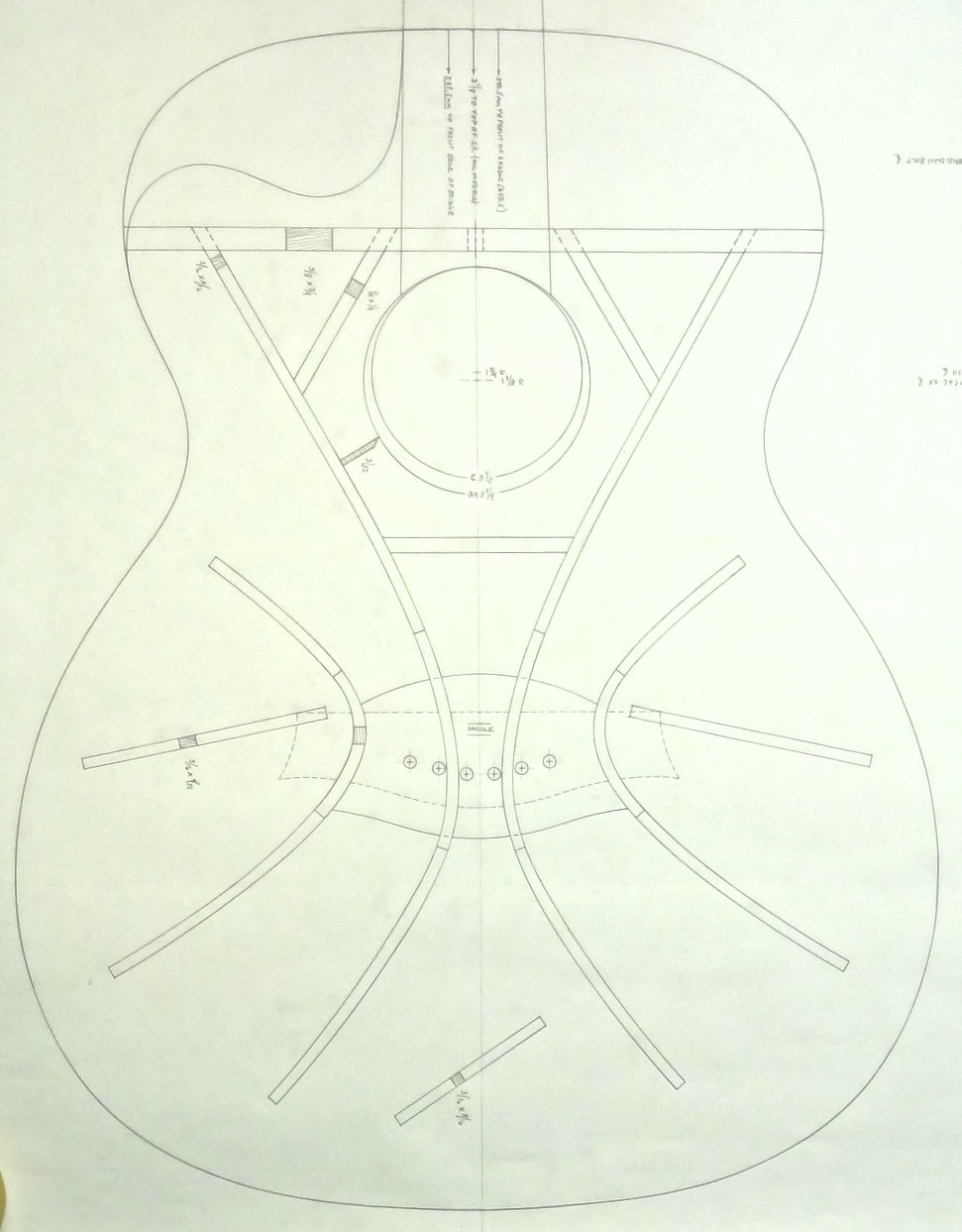

#2: See attached bracing plan. Because of the 14 fret design, I had to shift the falcate bracing pattern quite a bit. Following the falcate bracing criteria of Build page 7-11—especially item (e) requiring braces to divide the lower bout in equal angular segments—my side tertiary braces are not perpendicular to the guitar centerline, but at a rather large angle to it. They could be perpendicular if the inboard brace ends aren't placed under the front corner of the bridge, but that criteria seems important to me.
Will this placement of the tertiary braces adversely effect vibrational modes, and ultimately the sound of the guitar?

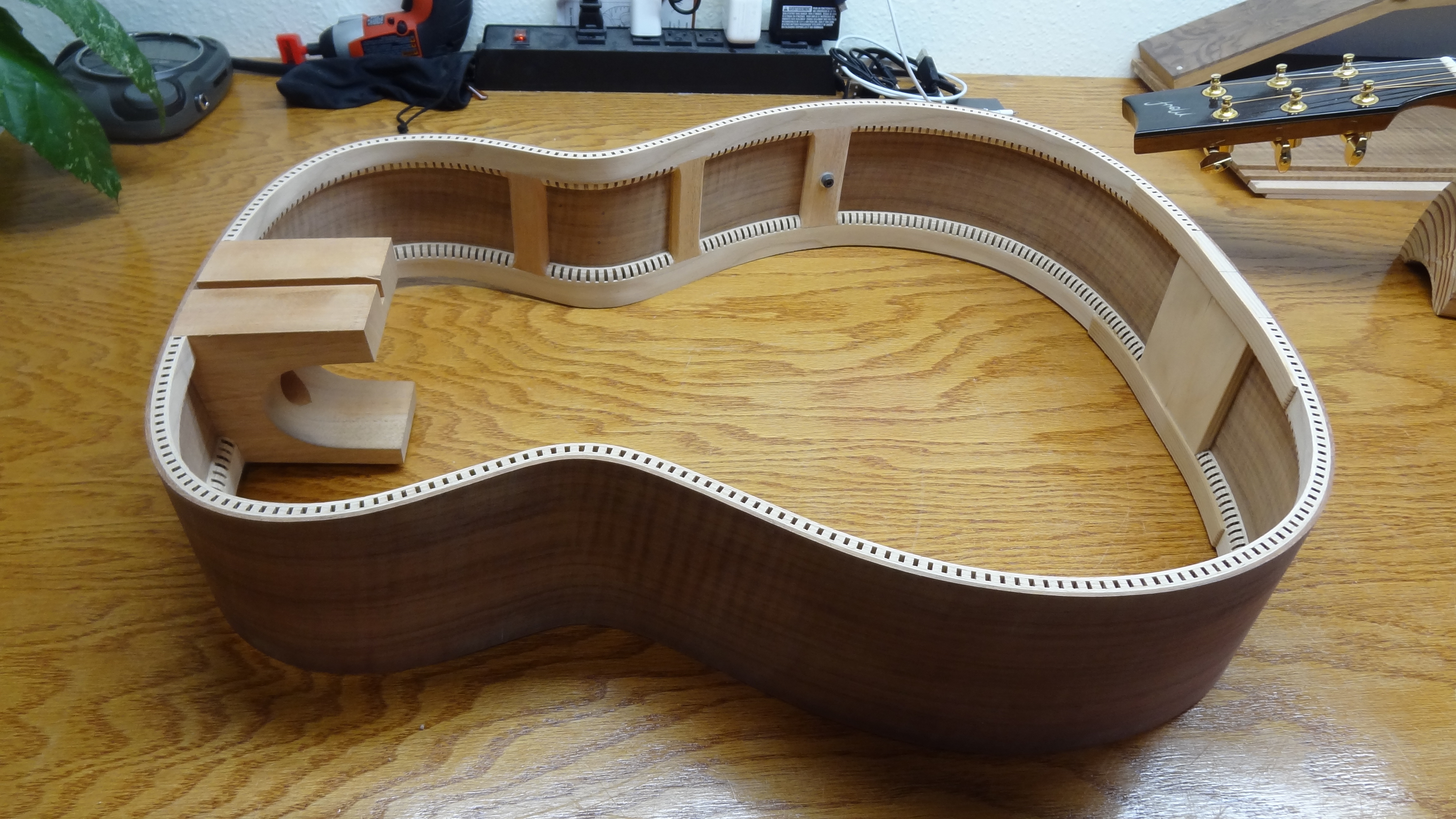

This technique was used for all the back's ladder braces, the top's upper transverse brace and the upper ends of the X brace with seemingly no ill effects. The top's upper transverse brace is not quite as big as the falcate design at only ~6mm by 19mm (1/4” x 3/4”) in cross section and cathedraled to a sharp point. It seems that both of these aspects of the upper transverse brace are at odds with the very stout structure that is the falcate tradition. My head block is somewhat more robust, however, being made out of a single block with a substantial shelf and foot extending rearward for the top and back panels to glue to (see attached). It is also a bolt on/off design.

#2: ... Will this placement of the tertiary braces adversely effect vibrational modes, and ultimately the sound of the guitar?
I doubt it.

#3: ...does anyone have any thoughts on how brace ends should terminate? Is it primarily tradition to let them into the sides, or is there a good reason for it?
As a general rule I let upper bout braces into the linings for better structural support and feather lower bout braces to nothing, short of the linings, so as not to lock up the motion of the top. You may find Al Carruth's post in this thread of interest.
