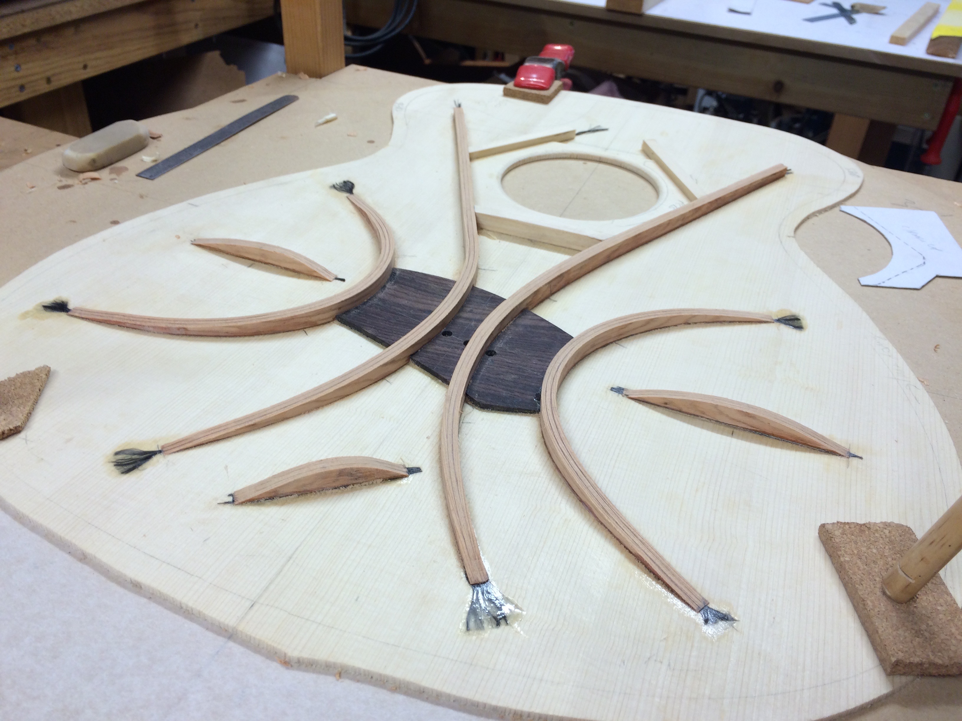

Forgive a forum newbie inquiry. I've come to the fountain of falcate knowledge looking for some answers. I'm building my fourth falcate guitar and considering making it a multiscale. I'm wondering whether it's best to shift the falcate bracing pattern to account for the angled bridge in a multiscale, and if so, how best to go about it. I suspect this has been covered here before, but my attempts to search the forum brought up only the current thread. Any input/guidance would be most appreciated. I would also be interested in Trevor's thoughts regarding multiscale guitars in general. Thanks!
Posts: 10897
Re: Adapting the method to multiscale and 7-strings?
Post by kiwigeo » Fri Mar 01, 2019 7:38 am
tvanevery wrote:
Thu Feb 28, 2019 11:52 pm
Simply offset the short tertiary braces to suit bridge wing ends and adjust arc of secondary braces so there is roughly equal areas of top between braces. My multiscale Gore build is documented here on the forum.

Thanks, Martin. Your post allowed me to find your multiscale blog which was very helpful. The bracing on my top is finished and should be closing the box soon.
