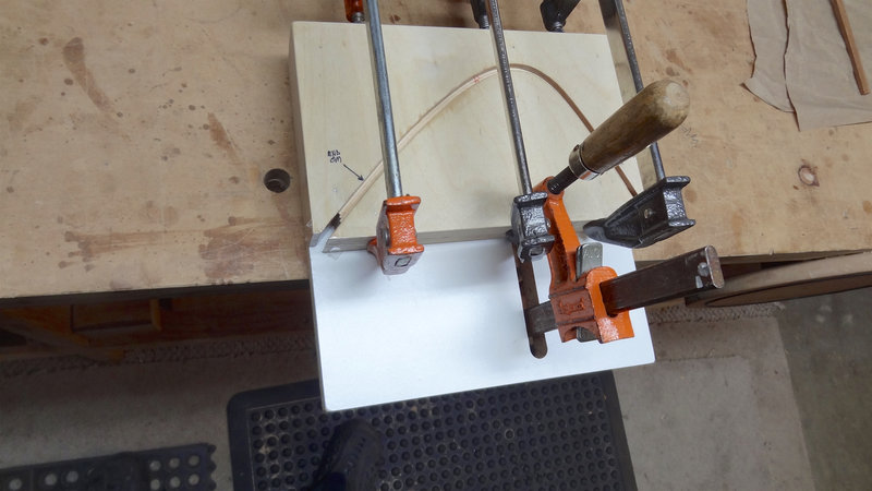

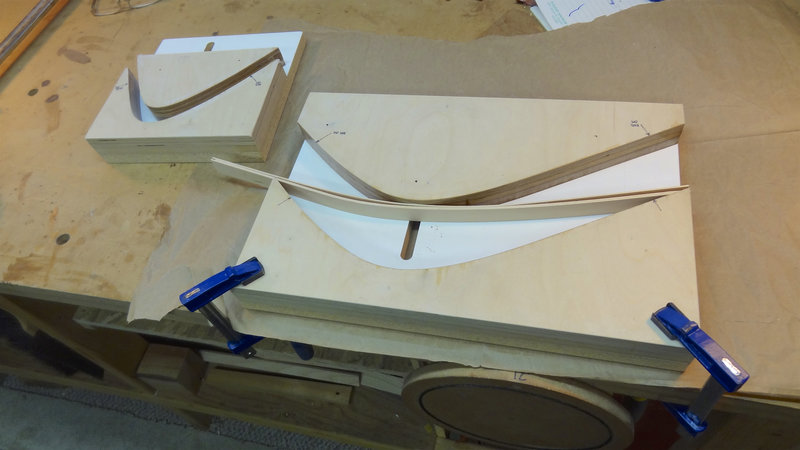

I have had 100% good luck with sitka. I use very precise male/female forms that clamp together and support the wood well. I use three, 1/16" thick plys. The forms were made using a 3/16" diameter, bearing guided straight router bit so they exactly match the width of the three finished plys.
I glue with TiteBond, and because the forms clamp so tightly there is no warping across the width; little if any spring-back.
For the primary braces, I bend and glue them dry with good luck.

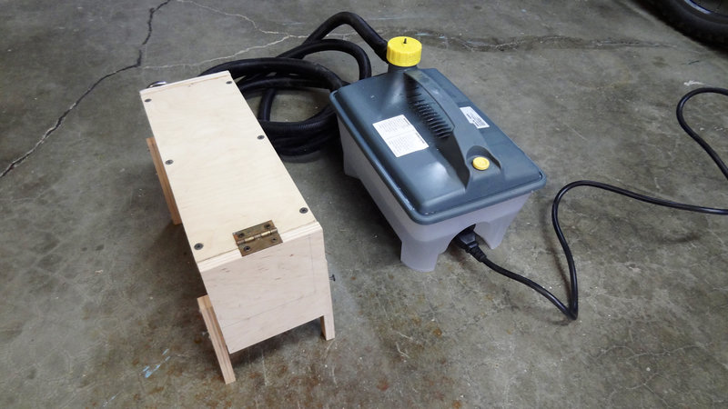

The tightly curved secondary braces are a bit more finicky. I made a small steam chamber and steam the three strips for about 5 minutes. They bend in the form without any issue. Of course, they need to cure and dry out before gluing together.
I've done a lot of steam bending over the years, so I have the steam generator. You can easily use a kettle and a hose as well.
Falcate brace bending forms. Dowels slide in slot for precise alignment.
Secondary brace bending form.
Steam generator and steam chamber.

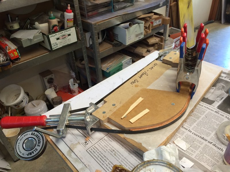

Nice looking jigs Erik. My brace bending jig is a bit more "agricultural" :) I use epoxy resin to glue up strips that are around 2.2mm thick. The strips are held against the form with a picture framing band clamp with additional clamping pressure supplied by spring clamps. Paste wax is applied to the form before glue up to stop the braces sticking to the jig.

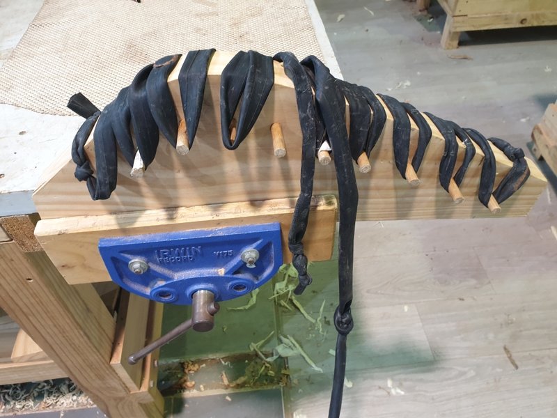

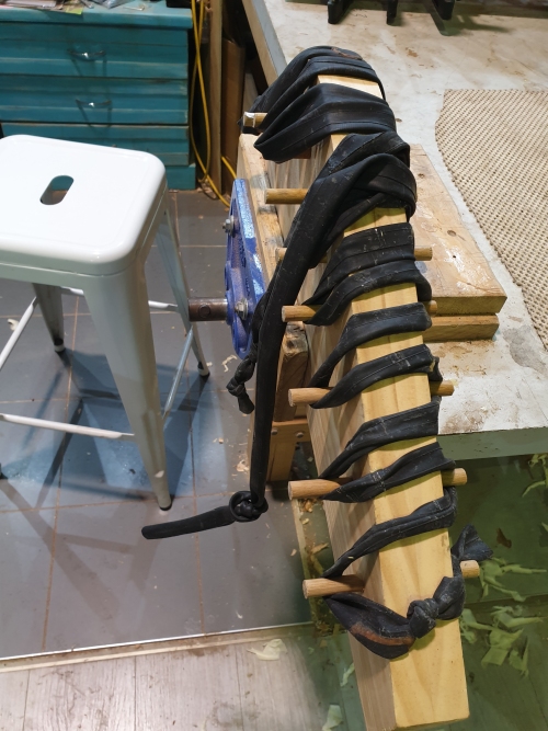

Below is my 'bondage' :lol: clamp for the primaries, same for the secondaries.
The jig is 30mm wide, i glue up my falcates at 25mm then slice down the middle to get to 2x matching halves.
The black rubber is bike tyre tube kindly donated by the guys in lycra who were having breakfast at the table next to me at the local cafe one sunday morning.
