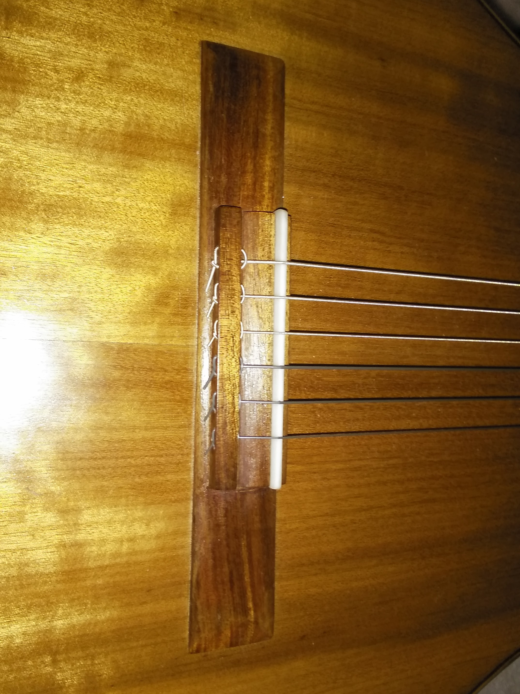

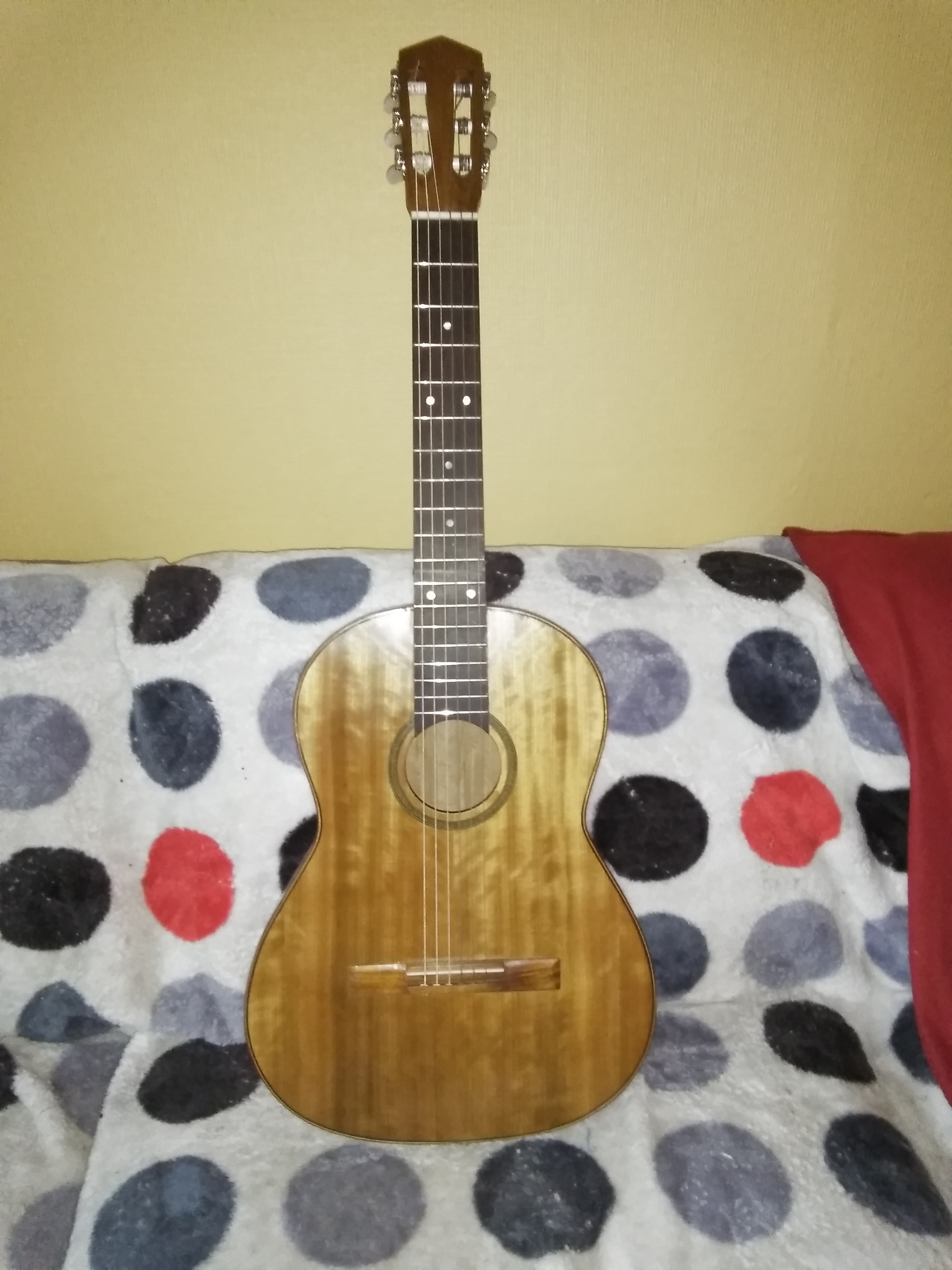

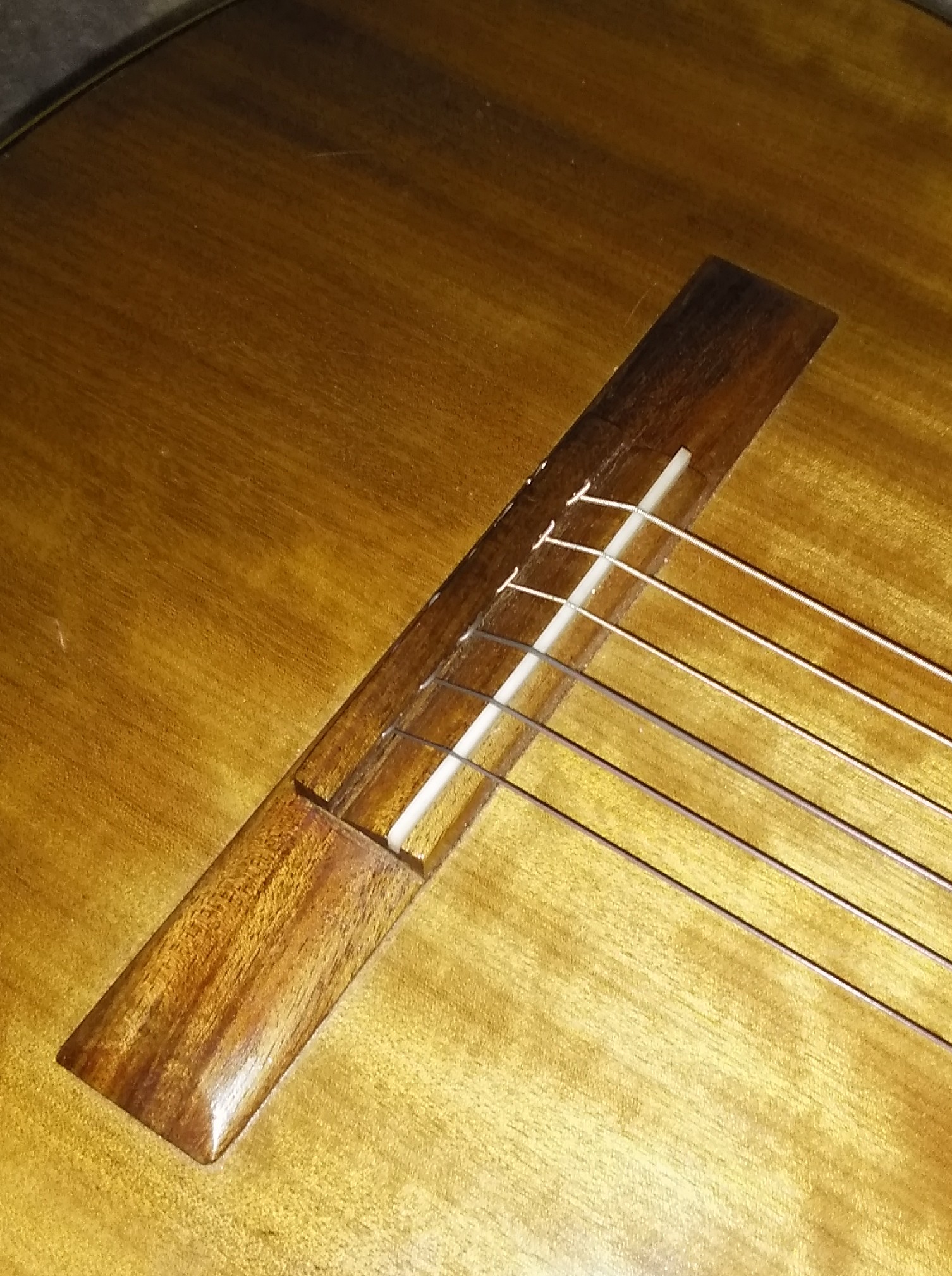

NZ grown Aussie Blackwood, 9mm high 13mm to the strings, under 20gms without the bone(from memory )The top is mangeao which is somewhat heavier than spruce. It was made to Josè Ramonillos design. I can't really say how good the bridge is being the only guitar I've made. I had it in at a guitar shop to get a more honest opinion than my mates gave. The shop owner was a bit disparaging about my workmanship (and fair enough too), but he liked the sound. Which was enough encouragement to start another.

Nice, I like the look of the top.
I've made a blackwood bridge before too but I didn't weigh it at the time. But haven't tried laminating one yet.
Are you building another classical??
