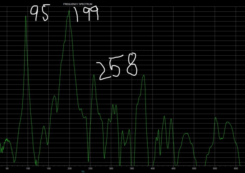

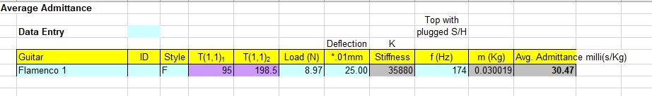

I am trying to match my results from my first Flamenco. It is an amazing sounding instrument. All of the flamenco players that have tried it have been shock at its sound. I watched them go from skeptical to slightly interested when they felt how light the guitar was, to very engaged when they started playing and spending a lot of time with the instrument. My thought at the time was to go very light on the top and make up the stiffness with the braces. It sounds like a flamenco and not a classical.
The resonances are 95 Hz 198.5 Hz and 157 Hz. The bridge rotates 1° and monopole mobility is 30.47

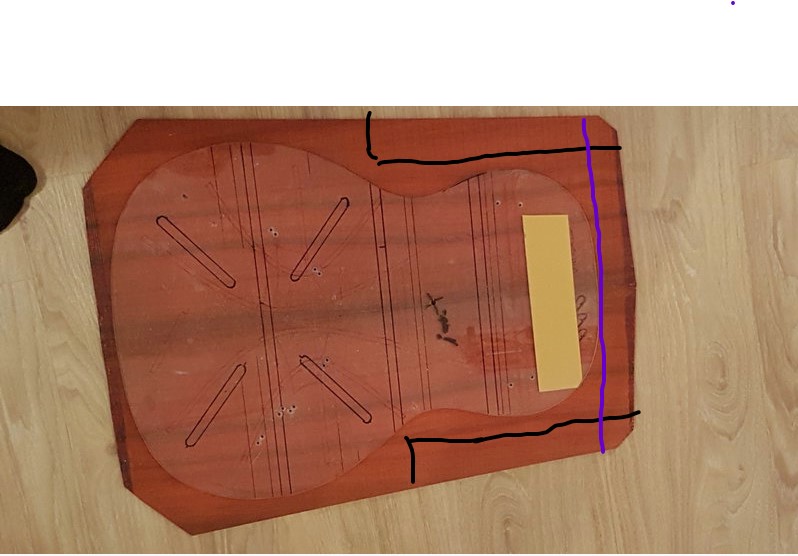

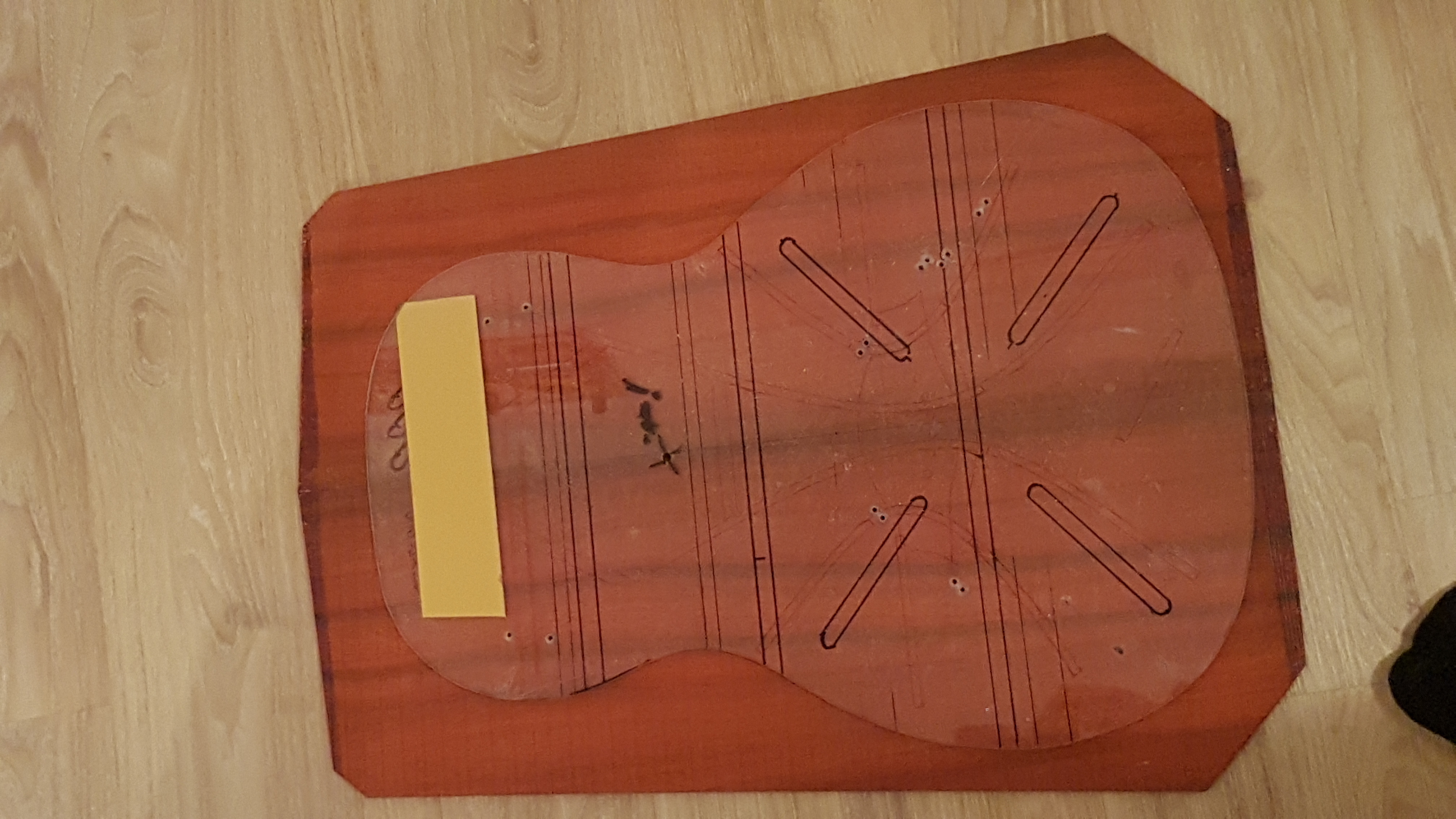

Hi, I wasn´t sure if I should start a new thread or not but the topic is exactly the same: I aquired a nice Padouk set from madinter and just realized later that the plates were cut as a trapezoid without leaving much flesh.
Probably I can determine E for the longitudinal by taking an average width an using a deflection jig similar to what John used. But the cross grain value I can´t get on this way. The plate size is even not enough to get a decent sized cut for the cross grain measurement. If I´m lucky I can cut a 3cm wide piece. I´m not sure that´s enough for the deflection test.
To give you an impression of the shape: Here´s a picture of the back plates including my OOO template
The influence of Glc on the thickness calculation is smaller than E (cross grain) so probably I could use an average value for that as John did. The thing is, this is the first time I use Padouk for a back so I don´t know ...
I could try to use the method for determining Glc woodsy proposed in this thread: viewtopic.php?f=33&t=7239&hilit=non+rectangular. But as far as I understand it is based on the assumption that the plate is rectangular. I´m not sure if it´s possible to assume again an average width for this method especially because off the strange shape of the plates.
Does anyone have an idea on how to get at least an idea of the right plate thickness?
Juergen

Post by johnparchem » Mon Jan 18, 2021 1:16 am
I would square up the upper bout and do a deflection test on the squared portion for the long grain. It seems like a deflection tests on a rectangular 3 cm strip should work. Use less mass for the deflection test. Or if you have sides from the same wood take a strip off one end of the sides.

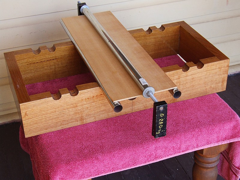

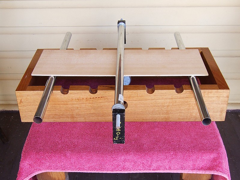

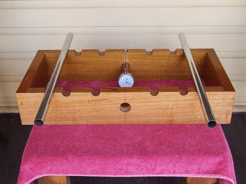

It's not that hard to get the cross grain stiffness using deflection methods. The pics here are of my old deflection jig as they show the technique better. First the jig. Note that the support tubes themselves are longer than the panel is.
Here's the normal arrangement for measuring long grain Young's Modulus:
Here's the cross grain arrangement:
The requirement is only for the area between the supports (the span) to be rectangular, for both the long grain and cross grain measurements.

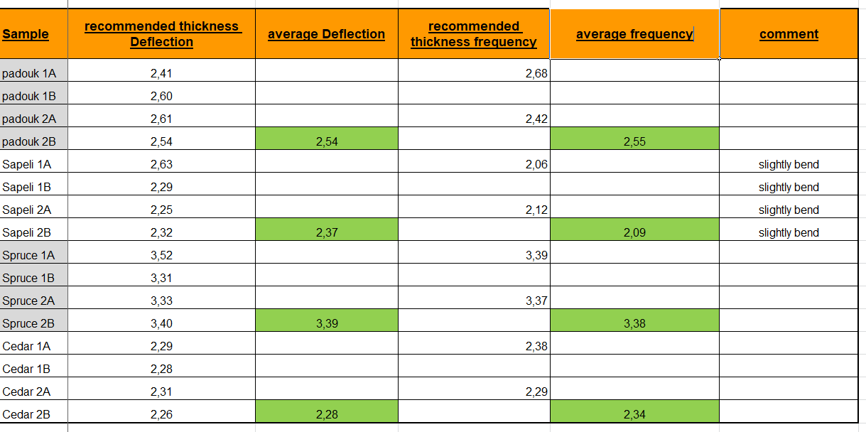

As I couldn´t find anyone posting a comparison of recommended thickness calculations for the frequency approach and the deflection approach I thought it could be interesting to to put my results here.
I tested 2 sets of backs and 2 sets of tops (will be 1 classical guitar and 1 steel string). For the deflection tests I repeated the test for each plate side (therefore plate 1a and plate 1b are the same piece of wood but once flipped). This means here I had 4 values per set.
For the frequency approach each plate was tested (obviously it didn´t make sense to flip the plate, hence just 2 values per set.
Except of the padouk set each set consisted of rectangular plates. For the padouk set I used in the calculations for the deflection test an average of the plate width ( which differed by 3cm between the upper and lower contact with the support). The calculations for the frequency approach assumed a rectangular plate with the forementioned average width and the actual plate length. (I didn´t expect to get any useful numbers because the theory is based on rectangular plates but thought I should include that as well). The following table shows the results for the thickness calculation for both approaches.
Summary:
the different methods for determining the recommended thicknesses agree quite well for cedar and spruce while there is a significant difference for the sapeli. An explanation could be that the plated had been slightly bend. Probably this changed the vibrational properties of the plates.
But I was quite surprised to see that both approaches resulted as well in almost identical average values for the recommended thickness for the padouk even with all the simplifications concerning the plate geometry.
