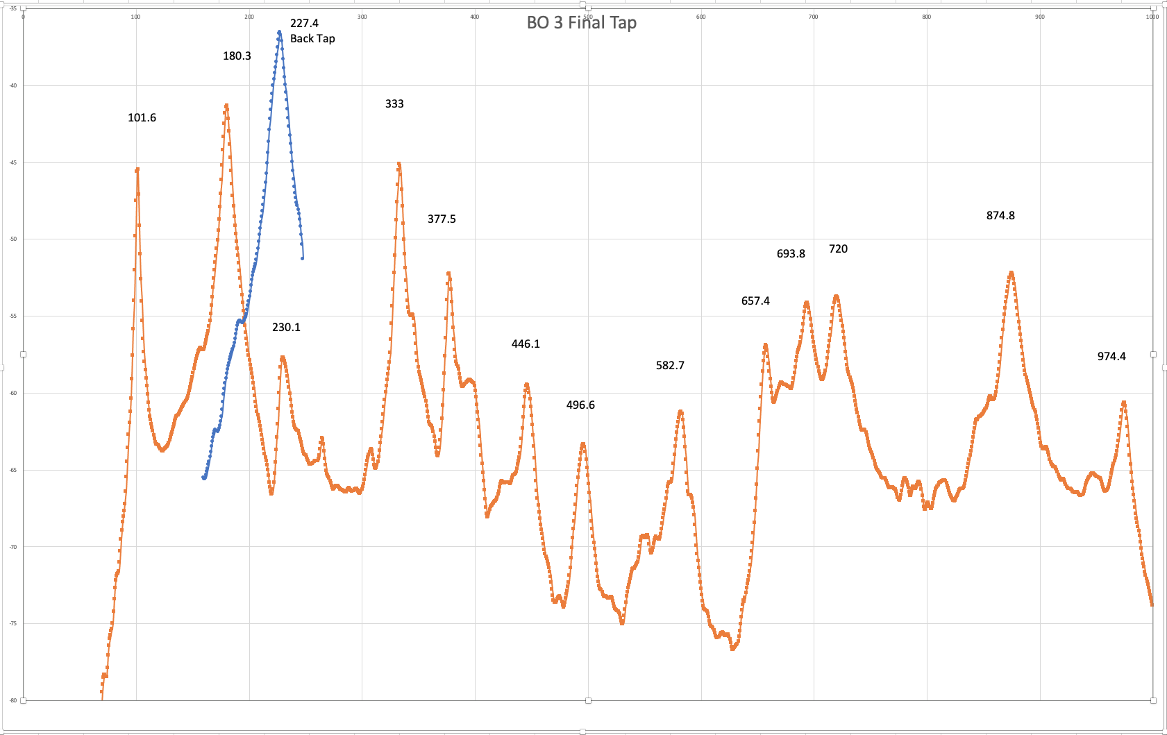

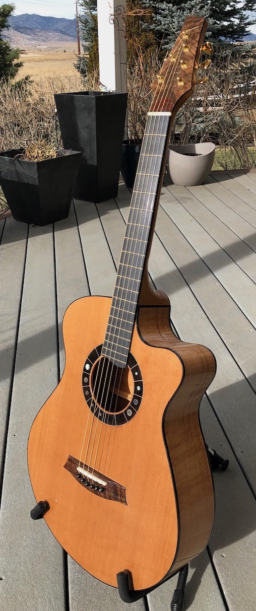

Here are the results for my latest build. I intended to make a higher-tuned guitar this time and am overjoyed that I hit the marks very closely! It has a nice, high, glassy tone that's a good contrast to my previous builds. Each time, I feel like I get closer to "As Designed!"
I've already shaved quite a bit off the back brace to get it down to 230hz - the direct back tap is showing 227hz. Should I keep going? Is it better to go lower in the middle, or to extend the lowered area farther out towards the sides?
Is it worth it to try to lower the T(1,1)1 by 1.6Hz? I monkeyed around with putting in some brass bridge pins, but any amount of weight was enough to lower the T(1,1)2 also.

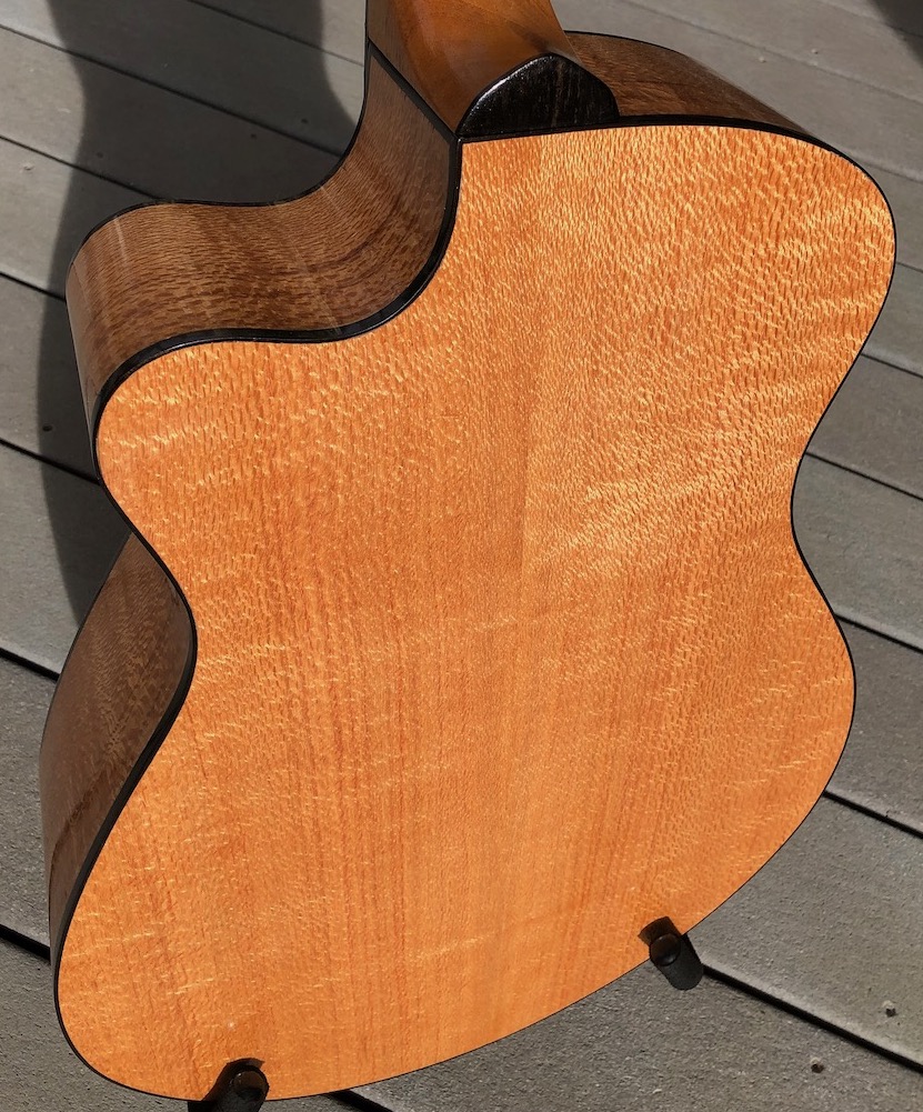

Thanks for all your help! (Thanks also, for donating the Australian Lacewood for the back and sides - it's stunning!)

That looks close enough to ideal to leave it as is. Well done, Chris!
