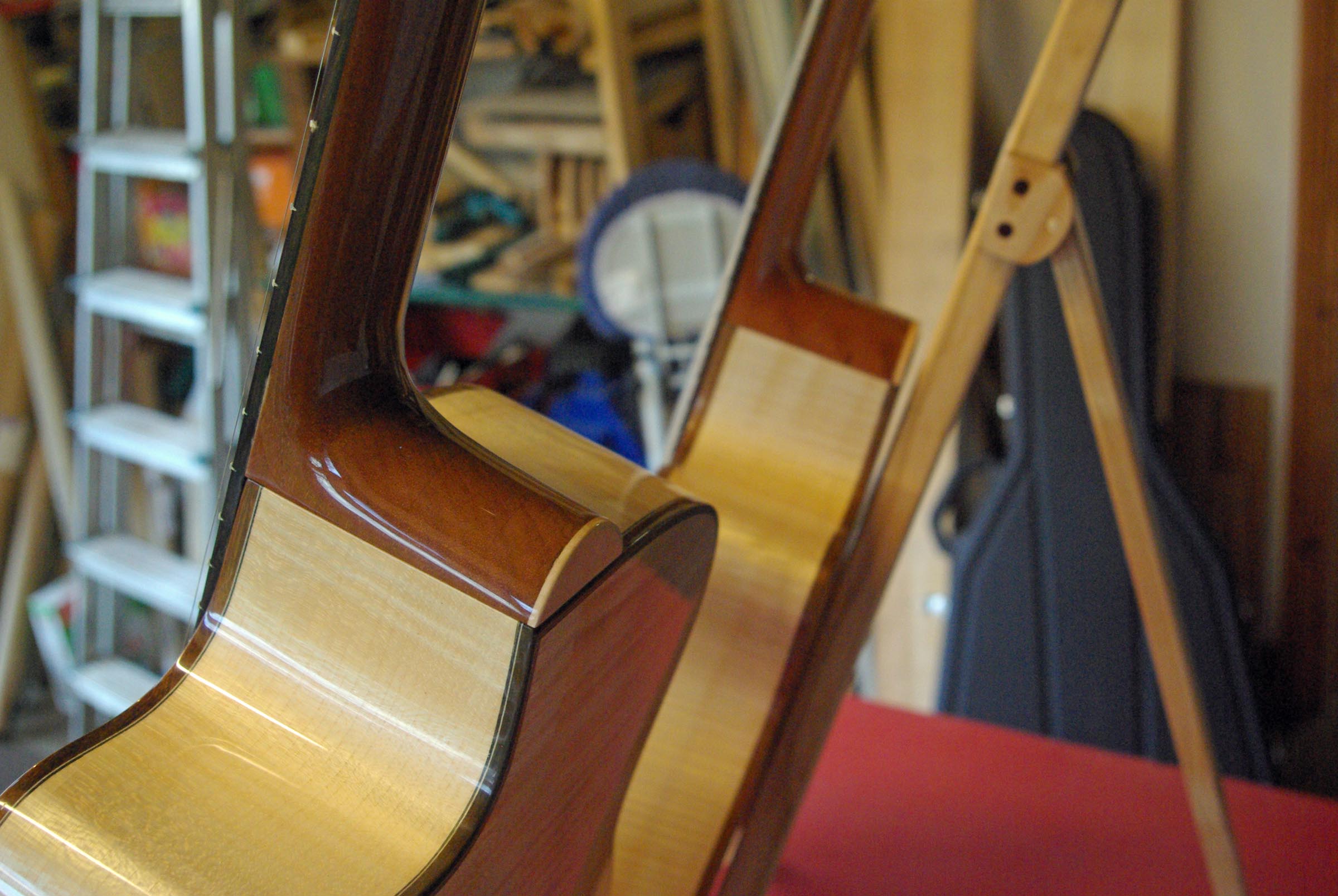

As Martin says one has to alow for the bolt bar but the other thing is that when doing a cutaway it looks a bit silly to have a Spanish type heel. I always do a cutaway so I end up with heels like this: ( I see the photo didn't go where I intended. Never mind.
A narrow heel is perfectly possible. I have just measured one of mine and even going to 30 mm width can look good. However I am sure a narrower tenon would work. Going down to say M4 could be OK but your build accuracy would have to be good. I would worry a bit about tapping an Al bar as steel screwed into Al is a bit problematic. I note that Titanium bolts are available.
