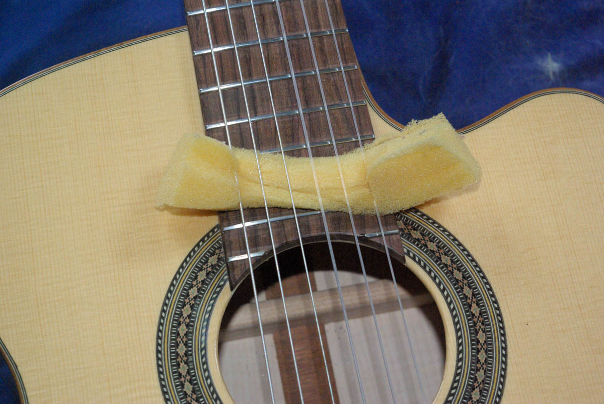

I also realised when testing a fairly responsive classical that damping the strings as I used too like this:

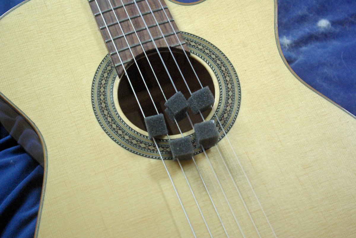

that I could hear quite a lot of string resonance going on. So having noted Trevor's technique I did this:
One has to damp the strings with the fretting hand as well as Trevor shows.
Looking carefully at the spectra, although the main early peaks were the same you could definitely see some differences in the higher frequencies so this is clearly a better way of doing the damping.
