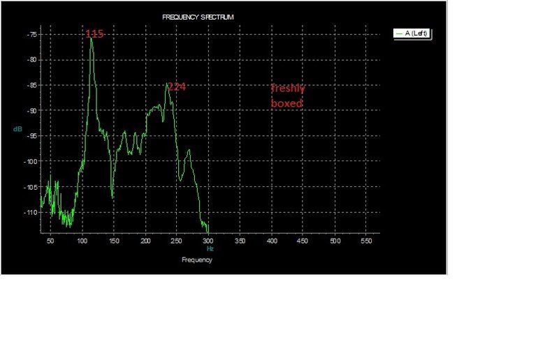

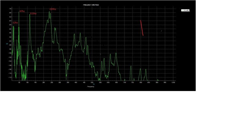

Hello all, i just boxed up my first guitar. I took a frequency reading of the top on the sides before i put the back on. That was clearly at 178hz. I took a couple fft readings of it boxed and they all look like my attachment. peaks at 12hz 47hz 115hz and 224 hz.What can be made of this? Not an image i was expecting to see

12Hz........is the neck on the instrument?
47Hz.......noise from power supply? Is the peak always there or only when you tap the top?
115Hz - Helmholtz? a bit high. Block sound hole and retest. if the peak disappears then its the Helmholtz
224Hz - is the back live? Tap the back to verify.
Perhaps you could take us through your tap testing process and detail the set up (equipment being used etc)

Ok so we need to nail down the 224Hz peak. As I noted earlier tap the back and see what frequency that gives you. Some Chladni testing will help you nail down exactly what is generating each peak. I'd ignore the peak at 12 and 47Hz.....I often get low F peaks when I tap test my instruments. Are you holding the instrument in playing position when you tap test or is it sitting on a bench?

if your current frequency is 50Hz, then the 47 peak is probably some noise from the current. Make sure you do not place your microphone on the same table as your computer or use some foam to isolate it.

So i got to my shop today and first thing i did was take another tap test. And behold, it must have been outside noise creating those frequencies. It looks alot more normal now. looks like both frequencies need to come down a bit tho. Would you reccomend bridge edge thinning? i will hopefully be able to generate some chladnis soon and that will be more telling of what is going on and what needs to happen. Very exciting for me
Also, i am sitting on a stool with the box in playing position. Laptop is to my left on my bench. Mic is on a stool 1 meter in front of me pointed at the guitar body. Mic is on a rubber mat. I capture a spectrum of ten taps around the bridge area. i just need to create soundproof room haha. and get nice even taps.
