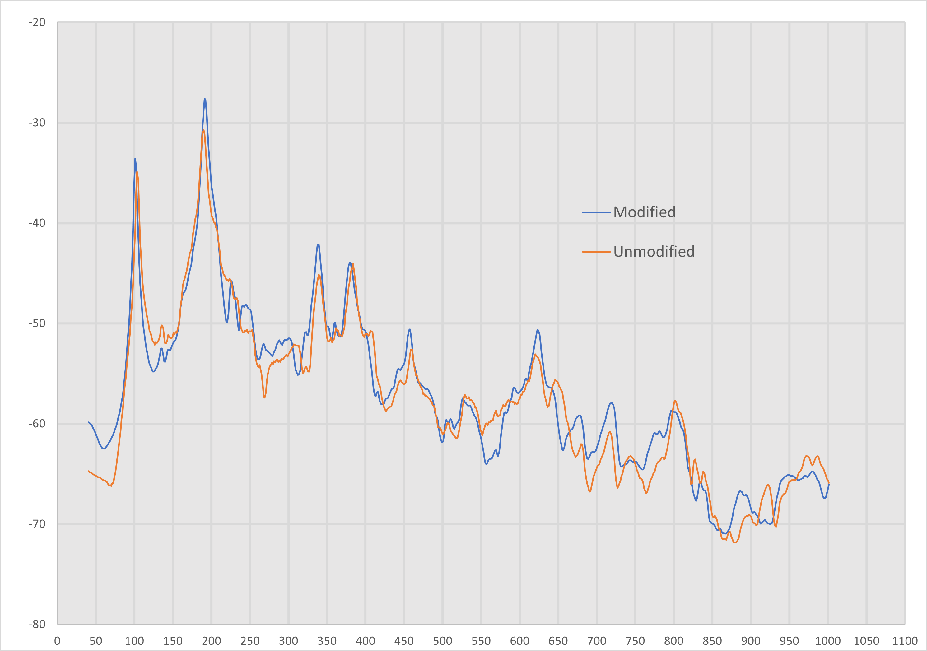

I went ahead and shaved (scalloped) the lower two back braces in the center. Watching the T(1,1)1 as I progressed. As you suggested, it required removing a lot of material (they were 20 mm height), before I saw some movement.
Eventually, T(1,1)1 moved down to 101 Hz, half-way between G and G#.
T(1,1)2 barely moved, from 190 to 189. I expected more.
Before and after spectrum plots attached. I lost a bit of response around 550 Hz.
