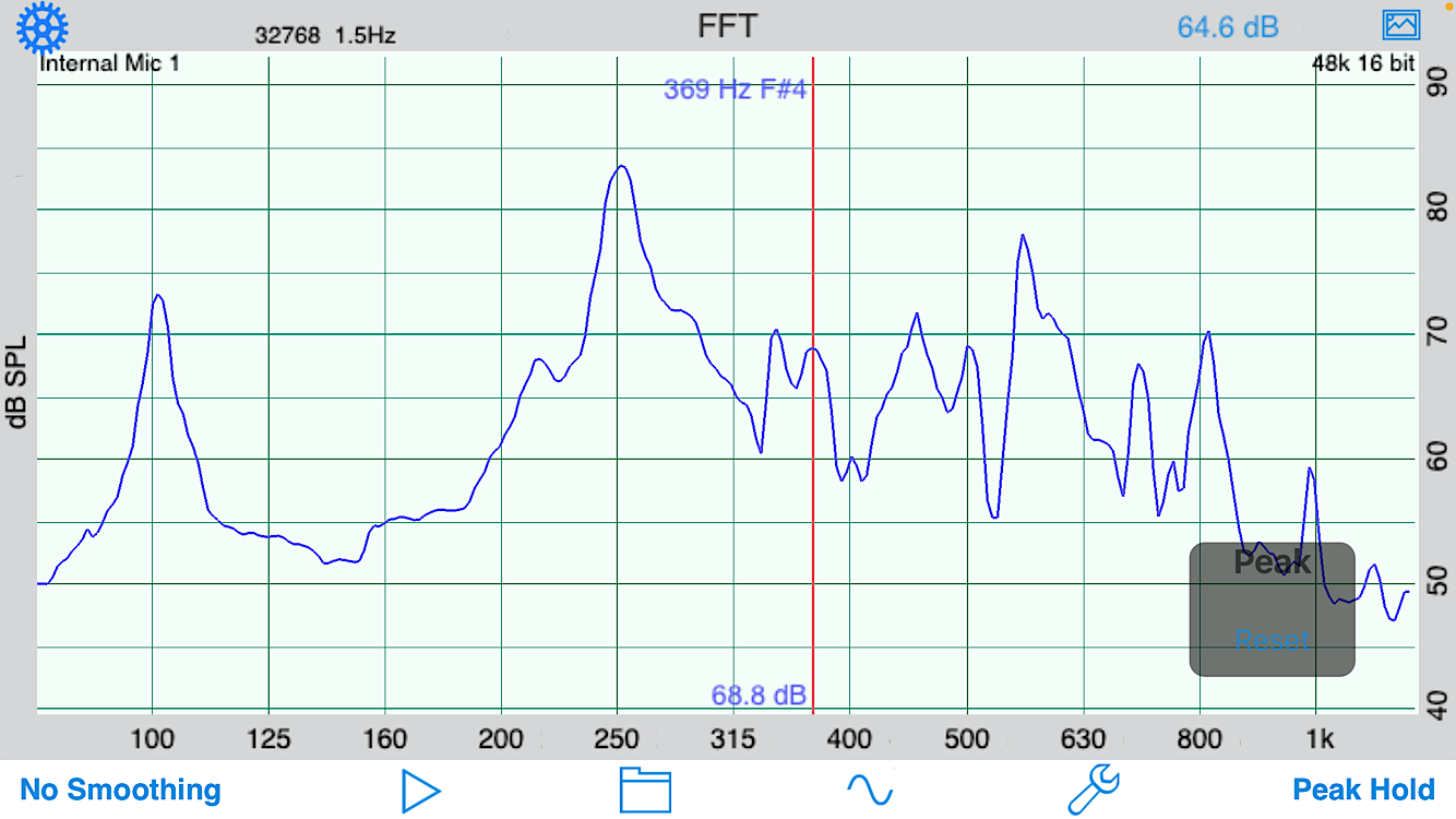

Having already tried added bridge mass, I took all the clay and the 3.5gr mustaches off. Here’s the FRC:
Peaks are 100hz, 214, 252, 343, 370, 454, 503, 559, 705, 811
This is a nicer solution to the 247hz monopole peak landing smack on B3, and lifted that 452 peak to 454. There is still that little peak at 214 on the slope up to 252. and it seems better defined. But none of these seem to land on scale notes in the problem area, Bb3 (233hz) being the worst, 14 cents flat. A (220) is 12c flat, Ab (208) is 8c flat. Above and below these notes, intonation is normal. Also normal at A4 (440) and A5.
The peak at 370 in the FRC above is right on F# but the intonation of F# is good and no obvious direct problem here.
In the trouble area, the tuner is confused about the frequency it is “hearing”. As is my ear. Tuner shows considerable fluxuation and my ear is confused as to what is the pitch is being heard.
