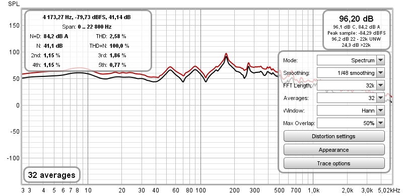

Post by Thibaud » Thu Oct 13, 2022 6:09 am
Hi,
Thanks for your answers :D I have closed the box and ended up at:
the main air 88hz
Main top 170hz
Main back 209hz.
It looks like I’m too low overall but I will follow Trevor’s advices in the book. Next Time I will follow the first advice and don’t scallop too much…
I have made the mistake to scallop the lower boot brace before closing the box so I have glued a piece of spruce back on. I will see what happen tomorrow.
Gluing fiber carbon over a X-Brace to increase stiffness would be an option? I don’t know if anyone tried before.
What is the consequences of having the main frequency too low?
Thank you very much for your help

Post by Trevor Gore » Thu Oct 13, 2022 7:18 am
See page 11-12 in the Build book.
"Low" is a matter of taste. The lower you take the main resonances, the more bass you get. See Design Section 3.2.2 et seq.

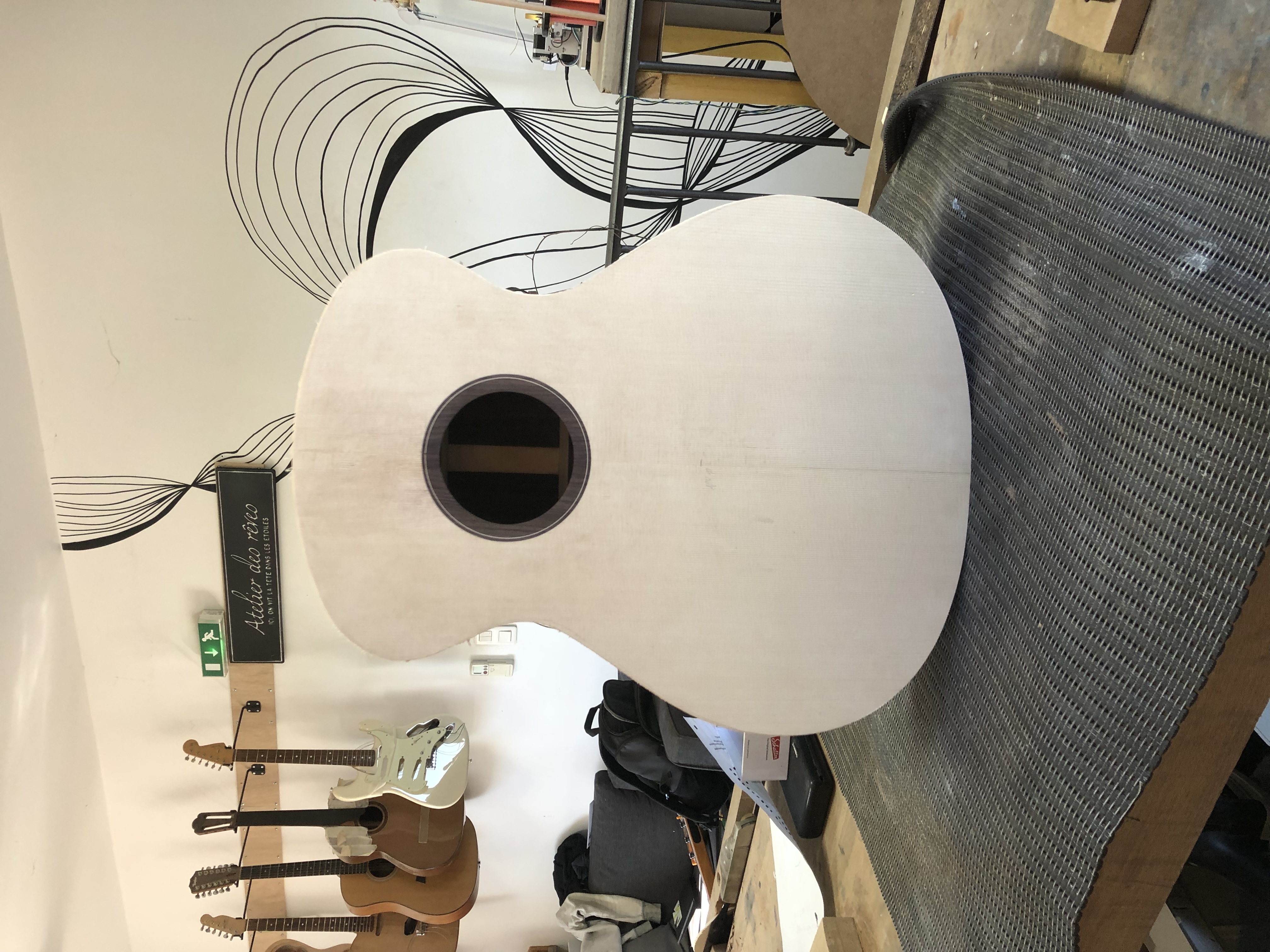

By the way, here is the guitar currently being built.
I’ll keep this feed updated when the guitar is complete. :)
