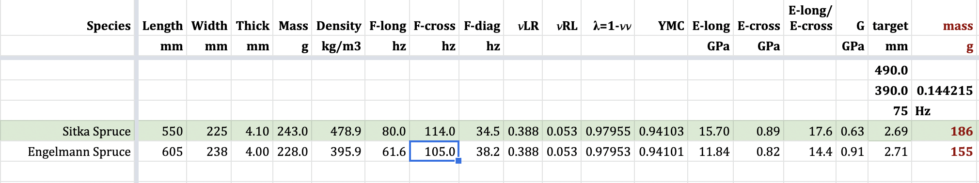

I am going to build my second guitar and I am going through the process of selecting tops using Trevor's method.
I have a Sitka spruce top "master grade" that is causing me doubts about its weight. My sitka top have a predicted weight of 186 grm.
Since no data are listed on the table 4.5-3 on sitka spruce, I am basing my observation on the paragraphe below the table.
It says: "All the above wood except the Port Orford cedar and western redcedar samples 17 and 18 made excellent guitars."
Those samples are all above the 169 gramms.
Would you reject that particular piece of wood or is it normal for sitka as it is a heavier wood?
Here is my spread sheet. The first line is my piece of wood, the second line is the first Engelmann spruce listed in the table as a comparaison.
http://www.anzlf.com/download/file.php? ... w&id=22548
Thanks for your help
Best regards
Thibaud

I had the same thought about that paragraph. He seems to be implying that for this guitar, a 390x490mm OOO size, that 169g (the POC, #11 and #12) is too much. Also, he said that sample WRC #17 was too heavy at 165g. The Engelmann averaged 146g.
These are his standards for a "master grade guitar". I'm sure many good guitars have been made with 165g tops. So I guess you just have to decide what your personal standards are. This might require iterative refinement over several builds.
By the way, your piece is showing an e-long of nearly 16. Are you sure? That seems very high. Check that f-long value. Are you sure you have the right peak in the frequency graph?
The density of your Sitka does seem high at 479. The species' average is 425. That's a 13% variation, which is normal, but you're looking for something exceptional in the other direction (lighter).
Average Sitka came out at 2.80mm and 172g. Yours at 186 is 8% heavier.
I think that maybe Sitka just isn't the absolute best choice for tops. The best appears to Engelmann, WRC, and Lutz.
Pacific Rim Tonewoods provides density and E values for its pieces ("Sonically Graded"). I did the thickness calculation using numbers they posted for one of their pieces of Lutz, and got 2.27mm and 132g. That's an exceptional piece of wood. And you can see the numbers before you buy. So you know what you're getting. I haven't bought from them yet, but when I need such a piece of wood, I will go there.
By the way, 𝜈LR and 𝜈RL for Sitka Spruce are 0.372 and 0.040. But I don't think that will make much difference in the thickness calculation--probably less than 1%.

Well, my first acoustic had a moon spruce top with a weight of 153g and it does sound really good so I would like to stick to that range. I do understand that sitka is heavier however my piece doesn't seem too good even for sitka. I have double checked all of my data and nothing has changed.
I have changed 𝜈LR and 𝜈R with your values instead of the book average values. It makes the top even heavier
