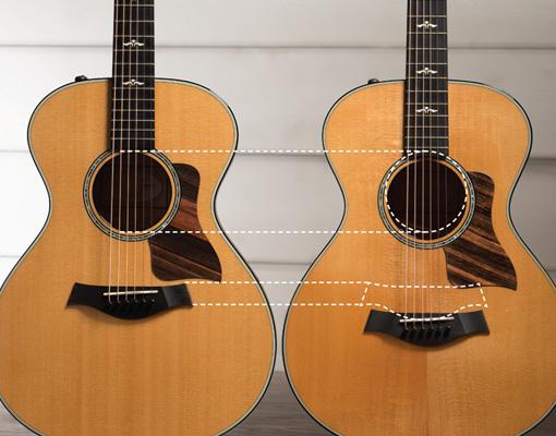

I overlaid the falcate bracing plan from the Build book on the body plan to get what looked like the best saddle position. Together with a 630mm scale length resulted in 12 frets to the body. I also get 18 frets total. The result is quite a pleasing look to me. The result is a little like the right hand guitar in the pic attached. It's from Taylor, showing the difference between their OO bodied 14 and 12 fret guitars. However, my sound hole didn't move down quite so much.
