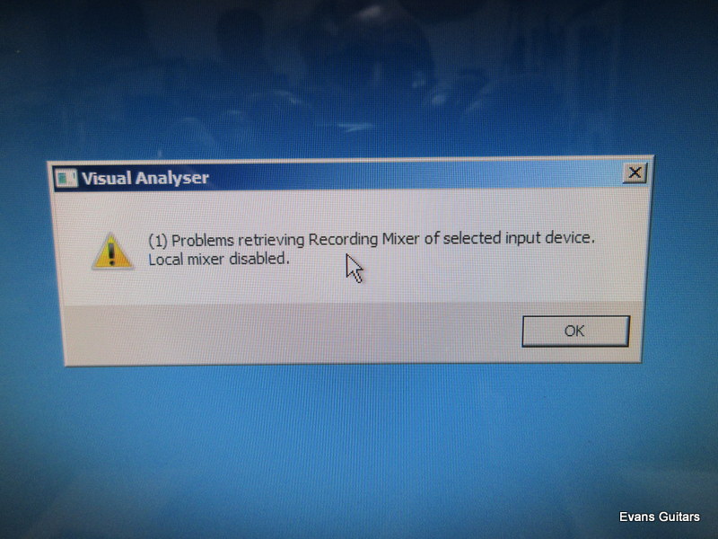

Hi, To better understand what you guys are tailing about I purchased Trevor's video from Obrien Guitars. However on trying to set up the VA, I kept getting the error shown here, so gave it away as a lost cause. With the extra info here I might revisit, thanks.

That error message occurs on Windows 10 systems and likely Win 11, too. When I made the videos with Robbie I was using Win 7 on my computer, and the error message seems not to appear in Win 7, though the effects are there. As VA v9.0.6 was written for Win XP it was written to suit the input/output protocols for that system, which all changed (due to the advent of mobile computing) with Win 7 (actually probably Win NT). So where VA is looking for the recording mixer (to set mic levels etc.) it can't find anything. It couldn't find it in Win 7 either, but it doesn't give the error message.
Bottom line is, just click "OK" and carry on. All that happens is you can't adjust the mic level in VA (as I say in the video), you have to adjust it in Windows. But you can see the mic level on the level meter in VA, again, as I say in the video.
Hopefully this clears things up.

Hi, Trevor thanks for your response. The bit about saving as admin or one cannot save data, made me think it was a problem and I did not continue.

The "Run as administrator" thing is another of those XP to Win 7 conversion issues. As viruses and things proliferated, MS bumped up security levels, so only those with Administrator rights could do certain things, like save *.ini files, for example.
Theses issues were, of course, addressed in the later versions of VA, but I still preferred using the earlier 9.0.6 version.
